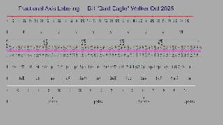

So, as you all know, I do a lot of graphing, and at one point wanted to have a
nice way to create fractional labels for things like angle values in radians.
I also have a vintage tool addic...  hobby.
And I live in the the US and so use the Imperial system of measurement.
And I wanted to organize all of my drill bits by 64ths of an inch.
And I was bored at work, so I used the gcd function in excel to hammer out the
basics.
Then I ported to povray using the recursive gcd function I wrote.
And then fiddled, DEBUGGED, tweaked, etc.
Finally I have some functional code that will subdivide a line segment,
calculate the simplified fractional value, use "value symbols" like pi or tau,
append units, and rotate the axis labels.
It is not extensively tested or optimized in any way.
Enjoy
Download 'fractionalsizes.png' (263 KB)
Preview of image 'fractionalsizes.png'

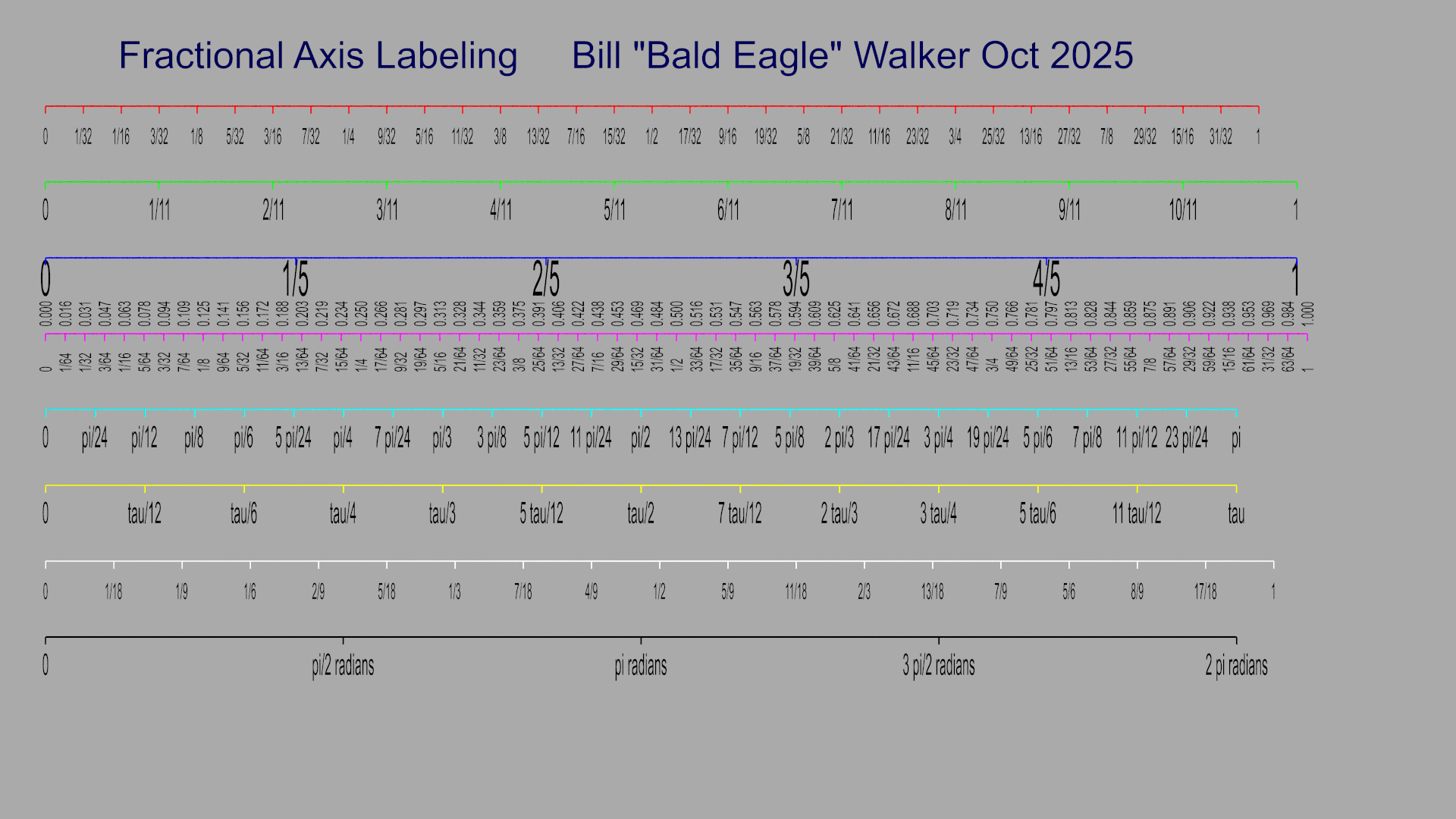

I like this; I might print it out and hang it over my own machines.
An improvement would be to align/stretch each conversion line so that the
'1.0-unit'-ends on the right will all line up vertically...so that it's clear as
to where each conversion's values match the others. When I first looked at your
graph, I assumed that this was already the case.
I'm also curious about the divide-by-11 line; the practical use of that one is a
mystery to me. What's a real-world example?
Well, what I would do is use the 1/64th scale with the metric equivalents.
And now that I'm telling you to do that, I should look into going in the reverse
direction.
And Metric.
I had a conversation way back with clipka about print resolution data in the
file output.
If we can work out a way to print to scale, then you could also draw tori with
specific diameters, boxes to show the thickness of sheet metal, etc.
And like I did with my (unfinished) slide rule, you could define arrays of
special sizes - number and letter drill bits, and plot those on the scale too.
(I just scored an L. S.  Starrett No. 245 Engineer's Gauge at he flea market)
No, these are just arbitrarily scaled lines that get divided up.
Just take some x-value and set that as the length, and you can calculate
conversion factors for all of the Multipliers in the calls to DrawGraduatedLine
But you were ok with 18ths and 5ths?
To test if the algorithm works.
What if you wanted to fold a line up into an hendecagon/undecagon?
You'd need to divide it equally into 11 parts.
What if you needed to measure things for The Six-Fingered Man?
Or your amp went up to ELEVEN?
Why tau?  or pi?  or 18?  16?  32?  64?  24?  4?
It needed to be value agnostic.
