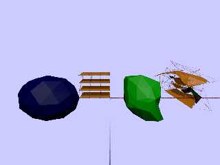

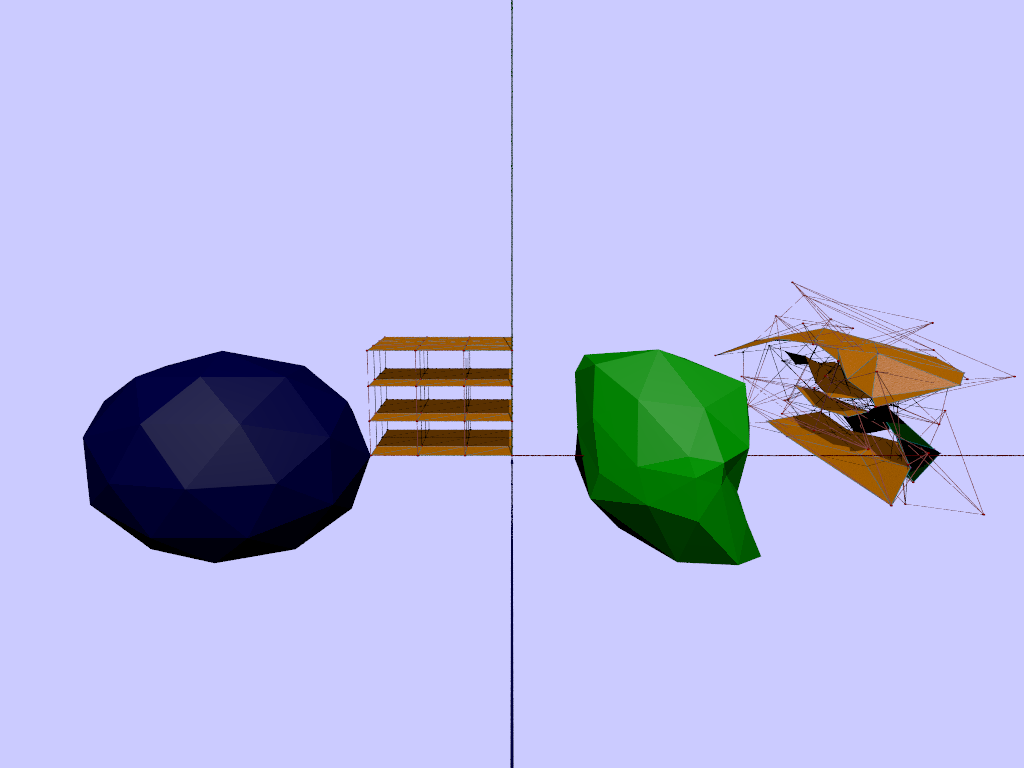

Interesting stuff. My modeling system defines a modeling grid of points
from which I generate the necessary bicubic patches. The idea is the
points on the modeling grid are on the model, and then it calculates
everything to make the patches to connect those points. The system
requires a lot of arrays, as you can imagine, so the points are all
there ready to be used and abused.
https://joshuarenglish.com/povray/bezdoc/index.html
Once I have all the modeling grids in a group, I can probably transform
the individual points directly in the SDL. I'm not sure how the
Berenstein polynomials would help with this particular transformation. I
have to play with the application of them.
Right now I'm going through an incredibly clunky conversion in 2d:
#declare quad = array[4] {<1.95,0,-1>, <3,0,0>, <2.5,0,1.2>, <1.25, 0,
-0.25> }
// outline the quad
#for(I,0,3,1)
   sphere { quad[I] 0.02 pigment { rgb 0 } }
   cylinder {quad[I] quad[mod((I+1),4)] 0.02 pigment { rgb 0 } }
pigment { rgb 0.5 } }
#end
#include "math.inc"
#declare res = <10,10>;
#declare left_vector = quad[3]-quad[0];
#declare right_vector = quad[2]-quad[1];
#declare DaTexture = texture {
   uv_mapping
   pigment { marble }
mesh {
#for(V, 0, res.v-1,1)
   #declare start = Interpolate(V,0,res.v,quad[0], quad[3],1);
   #declare stop = Interpolate(V,0,res.v, quad[1], quad[2],1);
   #declare nstart = Interpolate(V+1, 0, res.v, quad[0], quad[3], 1);
   #declare nstop = Interpolate(V+1, 0, res.v, quad[1], quad[2], 1);
   #for(U,0, res.u-1, 1)
     #declare ll = Interpolate(U, 0, res.u, start, stop, 1);
     #declare lr = Interpolate(U+1, 0, res.u, start, stop, 1);
     #declare tl = Interpolate(U, 0, res.u, nstart, nstop, 1);
     #declare tr = Interpolate(U+1, 0, res.u, nstart, nstop, 1);
     triangle { ll, lr, tl
       uv_vectors <U/res.u, V/res.v> <(U+1)/res.u, V/res.v> <U/res.u,
(V+1)/res.v>
     triangle { lr, tl, tr
       uv_vectors <(U+1)/res.u, V/res.v> <U/res.u, (V+1)/res.v>
<(U+1)/res.u, (V+1)/res.v>
   #end // for U
#end // for V
  texture { DaTexture }
Are you suggesting there's an easier (and maybe faster way) to do this
sort of thing? I'll have to wreck my brain on the problem.
Josh
From: Bald Eagle
Subject: Re: Envelope deformation
Date: 23 Jul 2025 20:40:00
Message: <web.6881809c27ff66201f9dae3025979125@news.povray.org>
Dunno if it's "easier" - that all depends upon your philosophy and code usage.
Might be faster.   I would say probably.
I would strongly suggest looking over my monograph on Bezier patches and
Bernstein polynomials to get the overview, and understand what the polynomial
method actually does, and why it's a more elegant way of doing things.

I used the code from one of my monograph illustrations to form the basis for
rewriting an expanded Bernstein polynomial equation.
Set up the 64 control points.
Added an extra loop to show the extended control grid.
Seems to work when it just sits there and does nothing.  ;)
Need to get a low poly mesh and start moving control points around.
- BE

From: Bald Eagle
Date: 24 Jul 2025 18:35:00
Message: <web.6882b47a27ff66201f9dae3025979125@news.povray.org>
"jr" <cre### [at] gmailcom> wrote:
> "there you are" ;-).  (attached, 42 vectors, 80 faces)
Rock, paper, scissors.
Bezier Parallelpiped crushes them all.
- BE
