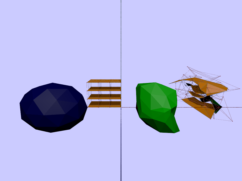

Take a look at:
https://discussions.unity.com/t/deforming-a-mesh-to-bezier-curve/876635
https://www.youtube.com/watch?v=S_JQUDDAsQk
https://www.rose-hulman.edu/~finn/CCLI/Notes/day21.pdf
my guess is that there are several ways that people go about this, and there are
likely libraries on GitHub and elsewhere.
MY conception of a general way to go about this would be to define a Bezier
parallelpiped consisting of 64 control points - like 4 stacked Bezier patches
having 16 control points each.
The 8 corner points would control your 3D envelope, and all of the inner control
points would control "stretching".
We could expand existing macros to create extended Bernstein polynomials in i,
j, and k.
Cycling through all of the mesh vertices and dividing the coordinates by the
AABB dimensions, you'd get the i, j, k parameters, and could plug those into the
polynomial to get the adjusted mesh vertex coordinates.
Then you could do all sorts of stuff with a mesh.
Best would be to write something in Javascript or Processing to create a
modeler, and have it write out an .inc file for the new distorted mesh.
- BW

I used the code from one of my monograph illustrations to form the basis for
rewriting an expanded Bernstein polynomial equation.
Set up the 64 control points.
Added an extra loop to show the extended control grid.
Seems to work when it just sits there and does nothing.  ;)
Need to get a low poly mesh and start moving control points around.
- BE

From: Bald Eagle
Subject: Re: Envelope deformation
Date: 24 Jul 2025 18:35:00
Message: <web.6882b47a27ff66201f9dae3025979125@news.povray.org>
"jr" <cre### [at] gmailcom> wrote:
> "there you are" ;-).  (attached, 42 vectors, 80 faces)
Rock, paper, scissors.
Bezier Parallelpiped crushes them all.
- BE
Download 'bezier_3d_for_mesh.png' (109 KB)
