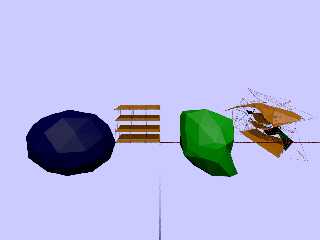

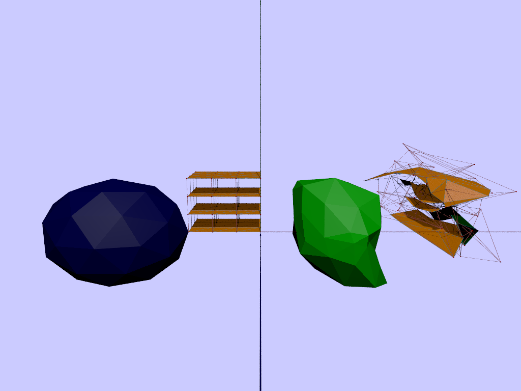

> Then you take your mesh, find the bounding box min and max, convert all the 3D
> coordinates to uv(w) coordinates, and use the Bezier splines to adjust the
> coordinates of the mesh.
Take a look at:
https://discussions.unity.com/t/deforming-a-mesh-to-bezier-curve/876635
https://www.youtube.com/watch?v=S_JQUDDAsQk
https://www.rose-hulman.edu/~finn/CCLI/Notes/day21.pdf
my guess is that there are several ways that people go about this, and there are
likely libraries on GitHub and elsewhere.
MY conception of a general way to go about this would be to define a Bezier
parallelpiped consisting of 64 control points - like 4 stacked Bezier patches
having 16 control points each.
The 8 corner points would control your 3D envelope, and all of the inner control
points would control "stretching".
We could expand existing macros to create extended Bernstein polynomials in i,
j, and k.
Cycling through all of the mesh vertices and dividing the coordinates by the
AABB dimensions, you'd get the i, j, k parameters, and could plug those into the
polynomial to get the adjusted mesh vertex coordinates.
Then you could do all sorts of stuff with a mesh.
Best would be to write something in Javascript or Processing to create a
modeler, and have it write out an .inc file for the new distorted mesh.
- BW

Interesting stuff. My modeling system defines a modeling grid of points
from which I generate the necessary bicubic patches. The idea is the
points on the modeling grid are on the model, and then it calculates
everything to make the patches to connect those points. The system
requires a lot of arrays, as you can imagine, so the points are all
there ready to be used and abused.

Are you suggesting there's an easier (and maybe faster way) to do this
sort of thing? I'll have to wreck my brain on the problem.
Josh
From: Bald Eagle
Subject: Re: Envelope deformation
Date: 23 Jul 2025 20:40:00
Message: <web.6881809c27ff66201f9dae3025979125@news.povray.org>
Dunno if it's "easier" - that all depends upon your philosophy and code usage.
Might be faster.   I would say probably.
I would strongly suggest looking over my monograph on Bezier patches and
Bernstein polynomials to get the overview, and understand what the polynomial
method actually does, and why it's a more elegant way of doing things.

I used the code from one of my monograph illustrations to form the basis for
rewriting an expanded Bernstein polynomial equation.
Set up the 64 control points.
Added an extra loop to show the extended control grid.
Seems to work when it just sits there and does nothing.  ;)
Need to get a low poly mesh and start moving control points around.
- BE

From: Bald Eagle
Date: 24 Jul 2025 18:35:00
Message: <web.6882b47a27ff66201f9dae3025979125@news.povray.org>
"jr" <cre### [at] gmailcom> wrote:
> "there you are" ;-).  (attached, 42 vectors, 80 faces)
Rock, paper, scissors.
Bezier Parallelpiped crushes them all.
- BE
Download 'bezier_3d_for_mesh.png' (109 KB)
