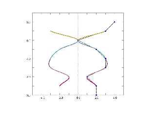

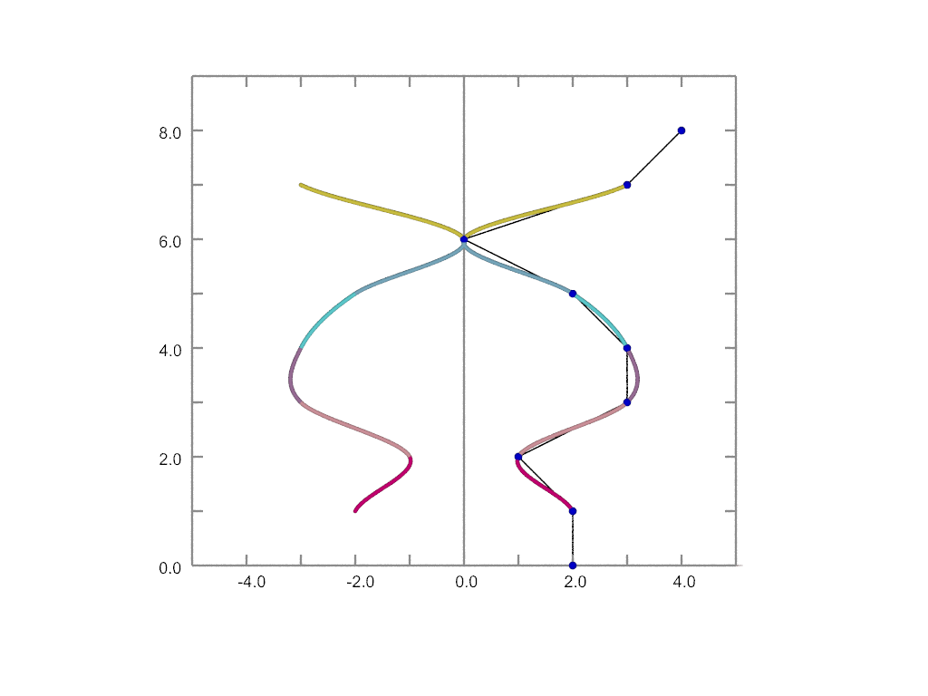

From: Bald Eagle
Subject: Re: SOR documentation
Date: 13 Aug 2025 19:35:00
Message: <web.689d20b3251da1bc1f9dae3025979125@news.povray.org>
> So hopefully I'll be able to get the SDL to work tonight.
It took longer than i thought, because in order to make the f(h) equation match
the documentation, I had to flip everything upside down and backwards from the
way I did it in Excel.  And I used arrays.
But it all works, which is what I needed to do.
With regard to POV 4.0, I see no reason why the number of points needs to be
specified, since the source can count the points when parsing the SDL.
There ought to be a way to specify the "tension" like in a proper Catmull-Rom
spline.
Anyway, here ya go.
- BW
Download 'surface of revolution documentation.png' (62 KB)
Preview of image 'surface of revolution documentation.png'

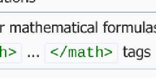

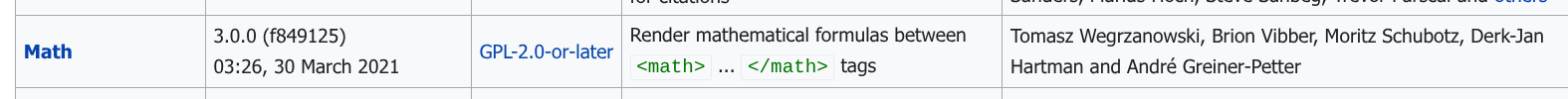

I'll reply tomorrow (Sunday), via email, on topic.  on the above, the wiki has a
math extension installed, perhaps that should enable you to write the equations
"in text" (see attached).
regards, jr.
