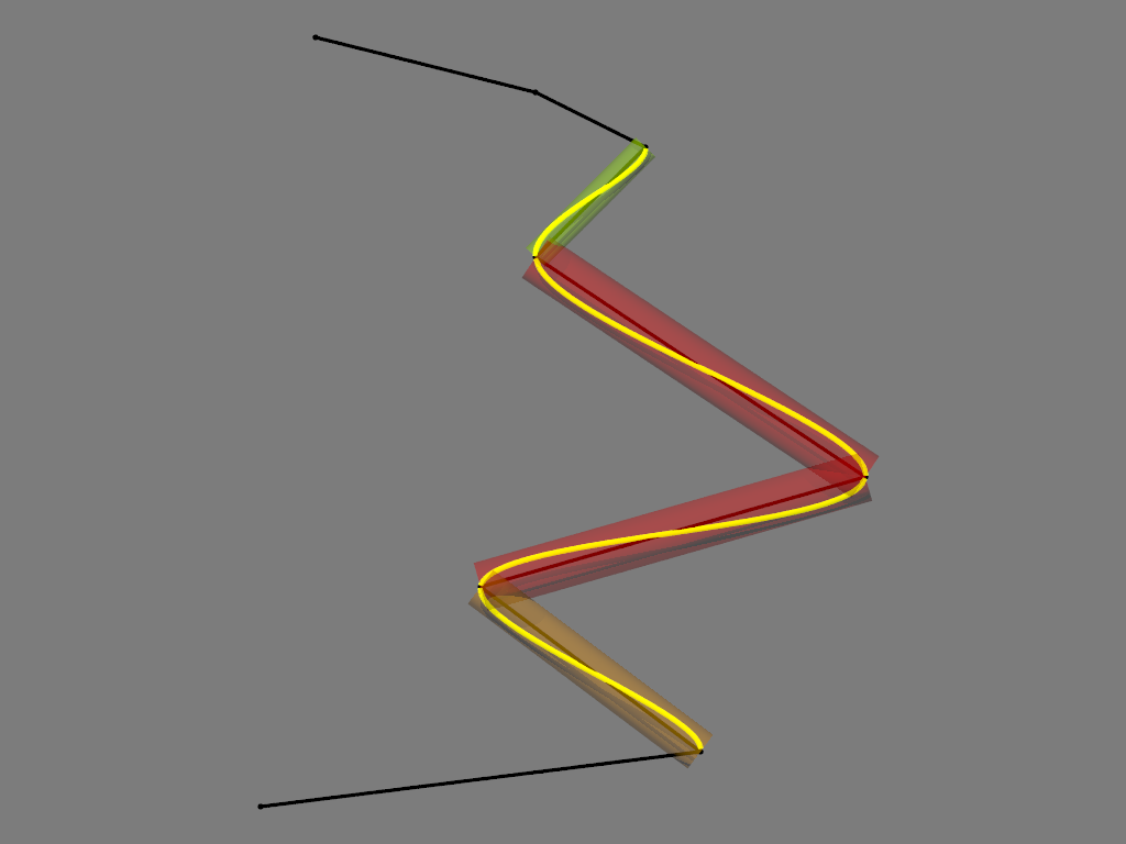

From: Bald Eagle
Subject: Re: SOR documentation
Date: 1 Nov 2025 13:45:00
Message: <web.69064669251da1bc1f9dae3025979125@news.povray.org>
> I think it's good enough to begin testing the Catmull-Rom bounding.
Here's what I presently have in terms of computing per-segment bounding
cylinders.
Now I just need to code up some bounding cylinder intersection tests to see what
happens.
> Also, there is a mouse in my kitchen.
I have adopted a local stray.
No mouse, but now there is a cat that gets onto my kitchen counter.   :|
Am I winning yet?
- BE
