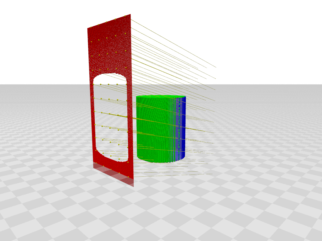

Here's my SDL test scene shooting a bunch of rays from a grid, all having the
same direction vector, and showing missed rays (red), entry hits (green), and
exit hits (blue).
I think it's good enough to begin testing the Catmull-Rom bounding.
- BW
Also, there is a mouse in my kitchen.
Happens every year around this time.   :\
Download 'graphicsgemslinecylinderintersection.png' (218 KB)
Preview of image 'graphicsgemslinecylinderintersection.png'

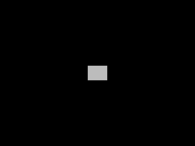

Just briefly scanning this over (as I was up late making rapid-fire changes) and
I noticed that the parser allowed and didn't complain about:
#local in2 = #local Result = {EcResult [2], EcResult [4]};
So who know what other wacky constructs it will let slip through.
Anyway, fixing 2 such statements allowed me to render this stunning grey
rectangle, which I'm assuming must be my cylinder.
- BW
Download 'sdl_raytracer cylinder test.png' (2 KB)
Preview of image 'sdl_raytracer cylinder test.png'

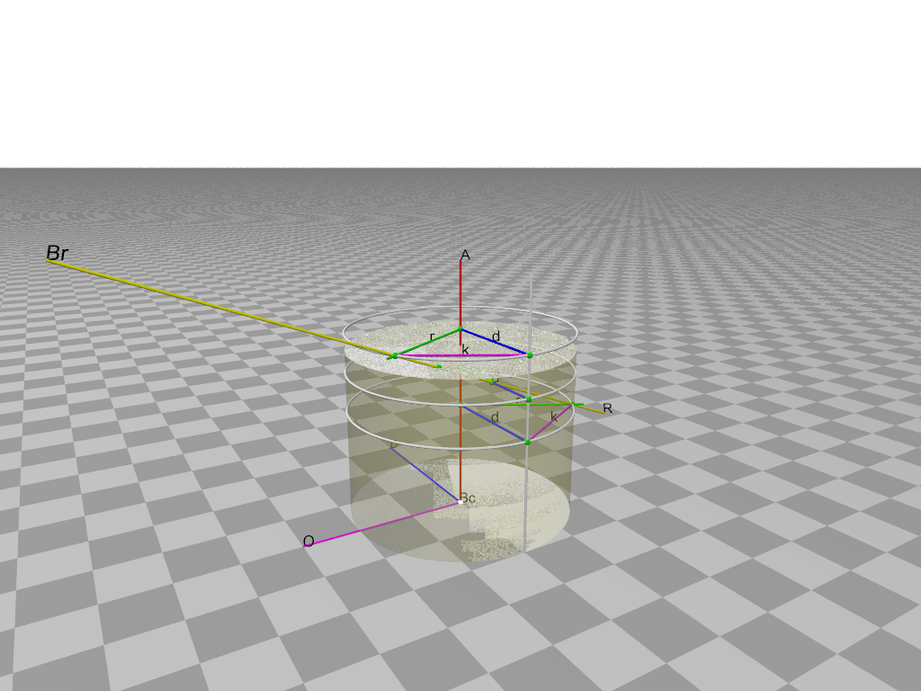

Seeing how exciting that last post was, let me now slay you with a diagram of
what's going on in that paper.
Download 'graphicsgemslinecylinderintersection.png' (195 KB)

> some rotation about x tests where parts (partial segments/intervals) of
> the sor would drop out. IIRC, those tests included negative on curve
> (between end control points, points). We'll see.
Lost my bet here.
Bill P.

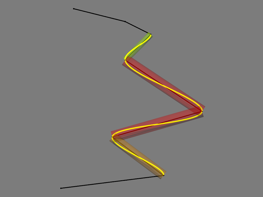

From: Bald Eagle
Subject: Re: SOR documentation
Date: 1 Nov 2025 13:45:00
Message: <web.69064669251da1bc1f9dae3025979125@news.povray.org>
Here's what I presently have in terms of computing per-segment bounding
cylinders.
Now I just need to code up some bounding cylinder intersection tests to see what
happens.
I have adopted a local stray.
No mouse, but now there is a cat that gets onto my kitchen counter.   :|
Am I winning yet?
- BE
