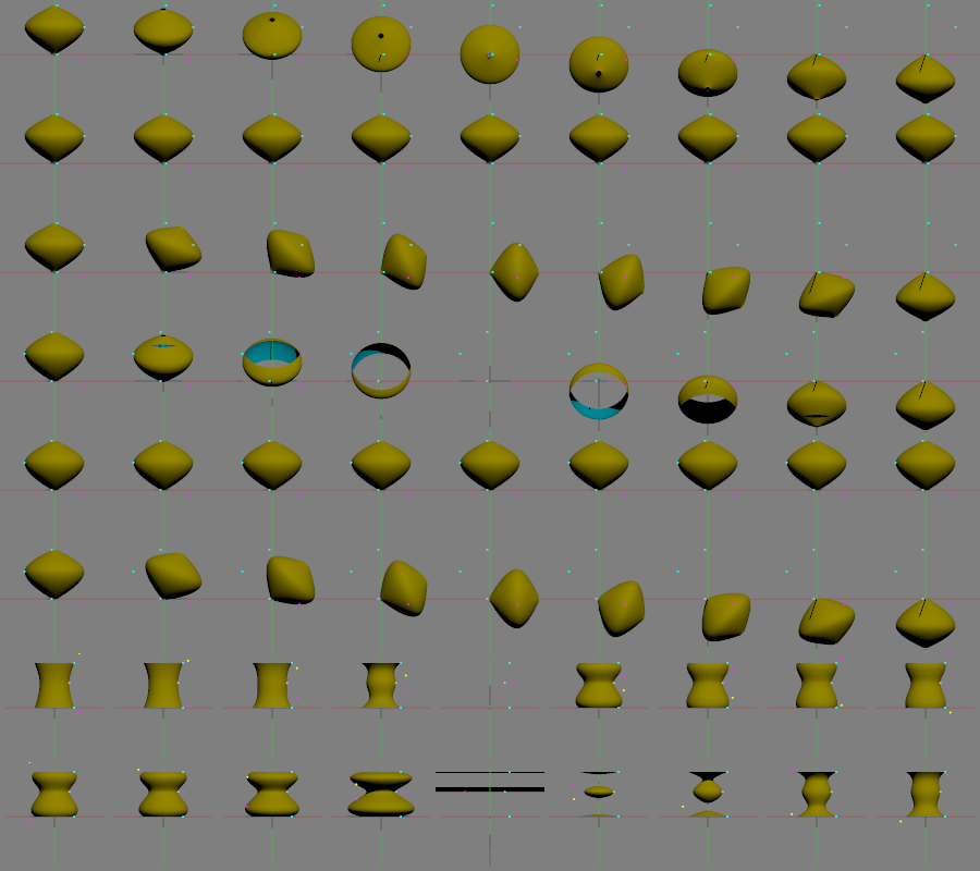

Attached an image of some more testing. It includes the fix for the
segment blink out issue & that fix looks good thus far. For testing I
disabled all the point list sanity checking to see what works and not.
Not going to go through the image in detail, but in answer to your
question about on curve points going negative it looks like a no go
without a deep dive and probable re-work of the current code.
For reasons I don't understand, when I allow on curve points to go
negative the camera ray direction affects results. This shown in the
fourth row where the sor slowly disappears then reappears as rotated
about x.
The descending in y on curve points doesn't work at all.
Allowing the first and last control points to go negative is fine and I
plan to add that relaxing to the blank out fix for yuqk's next release.
You had mentioned not being able to flip the two control points in y.
Where everything I'd tried to that point seemed to work. You also
mentioned this bit of code in sor.cpp :
if ((fabs(P[i+2][Y] - P[i][Y]) < gkMinIsectDepthReturned) ||
     (fabs(P[i+3][Y] - P[i+1][Y]) < gkMinIsectDepthReturned))
throw POV_EXCEPTION_STRING("Incorrect point in surface of revolution.");
I'm finding it is this run time check which sometimes doesn't allow
control points flipping in y. For yuqk what will be in the next release
is some added error text when that check trips so it is easier to
understand what is wrong.
Error! Problem point in sor segment 0 point set.
fabs(P[2][Y] - P[0][Y] || fabs(P[3][Y] - P[1][Y])
fabs(0.5 - 0.5 || fabs(0.9 - 0) < 4.44089e-08
The center images in the bottom two rows(*) of the attached image trip
this check and error. So, that code is catching some 'particular' cases
where given the control point locations relative to other on curve
points doesn't render correctly.
(*) Those rows are start the control points at one extreme and slowly
flip them to the opposite extreme in y moving left to right in the lower
two rows.
So with the segment blink out fix, it does look like more could be
allowed as valid point sets for the sor & yuqk will adopt those
relaxations. The shapes with negative control points do break up more
often, but as we found this can happen today with certain point lists.
(I've not really looked at intersections and differences as yet)
Bill P.

From: Bald Eagle
Subject: Re: SOR documentation
Date: 11 Sep 2025 10:40:00
Message: <web.68c2de77251da1bcf34d8a9e25979125@news.povray.org>
So what did you do?
in line 1082
x[n] = sqrt(r[n] * (r[n] * (r[n] * A + B) + C) + D);
I'd suggest changing that something like
x[n] = sqrt( fabs(r[n] * (r[n] * (r[n] * A + B) + C) + D) );
I'd suggest the above, if you haven't already done that.
Also, it may have something to do with calculating the intersections.
There's a check on Radius2 that I saw, so see what happens when you change:
Lines 1110-1111
Radius1 = xmin;
Radius2 = xmax;
to use fabs()
> about x.
Not surprising - all the checks for the control point order need to be
rewritten.
I'll have to do some more experimenting when I get the chance.
> You also
That def seems to be related to what you're seeing in those last 2 rows - since
the cp's are nearly coincident in y.
Do you think as a quick fix, we could just add -ymin to all the values to
translate everything into the first quadrant, starting at y=0, and then
translate everything back after the math gets done?
Very nice that some of this is getting worked out after 30 years.  :)

From: William F Pokorny
Date: 11 Sep 2025 22:27:06
Message: <68c384fa$1@news.povray.org>
> So what did you do?
The current fix is:
     if ((r[n] >= y[0]) && (r[n] <= y[1]))
//      x[n] = sqrt(r[n] * (r[n] * (r[n] * A + B) + C) + D);
         double tmpVal = (r[n] * (r[n] * (r[n] * A + B) + C) + D);
         if (tmpVal>=0.0)
             x[n] = sqrt(tmpVal);
         else
             tmpVal = std::abs(tmpVal);
             x[n] *= -1.0;
As for the bounding suggestion, I don't know. Of note is that the
Radius1 value is never used that I see.
Something I did try was faking a user bounding radius multiplier option.
In some configurations where only a subset of the on curve points were
negative in x. It often helped with apparent clipping - but there always
remained some issue with the the ray directions relative to the overall
sor - where all or part of sor 'segment(s)' would drop away (this an
issue apart from the entire-segment blink out issue up top).
My wild guess. There are internally calculated A,B,C,D values used for
the quadratic eqn solved while setting the two bounding radii values.
Those calculated values involve the x values as given for the sor point
set. Maybe something could go 'more right' there when negative values
are present - I don't know.
Bill P.
