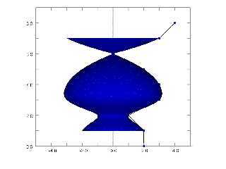

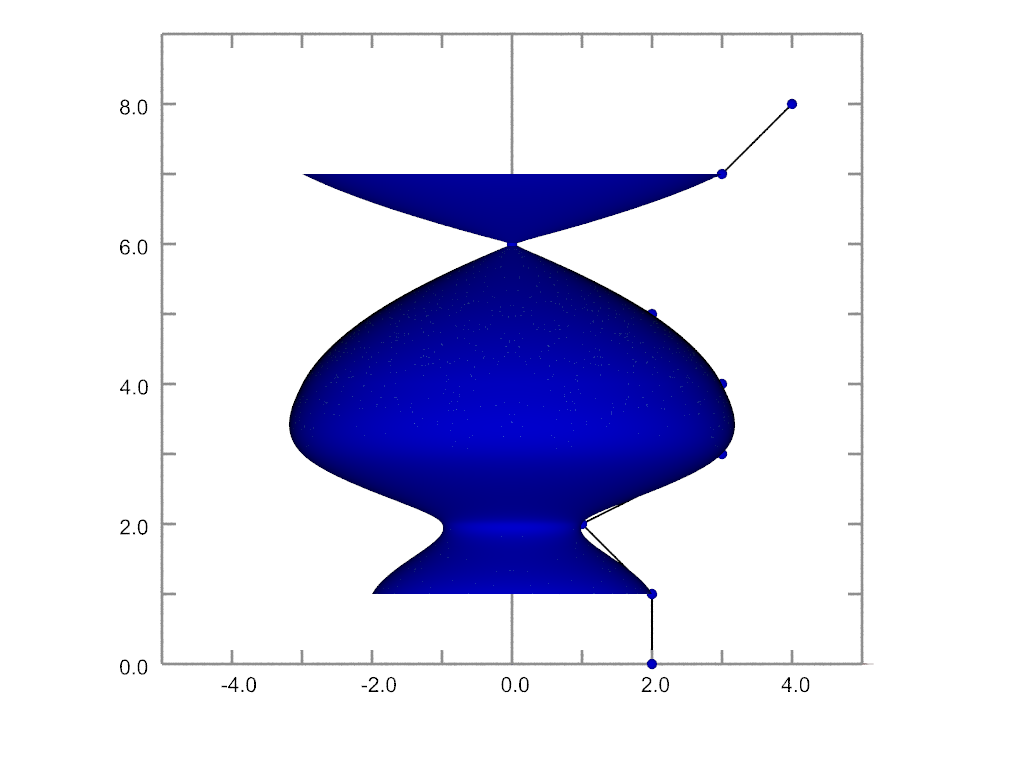

> I still feel like there should be some minus signs in there to make the
> interpolation work - but maybe those pop out the other side of the MInvers () .
> .. . I'll have to write that out in SDL and run it to find out.
Sent values of A-D for each segment to the debug stream, and there are
definitely minus signs.
> I also don't quite understand why we need to take the square root of the result
> in line 1082
> x[n] = sqrt(r[n] * (r[n] * (r[n] * A + B) + C) + D);
> to get the interpolated spline values, but perhaps that may become clear as I
> find more bits of time here and the to properly focus on this.

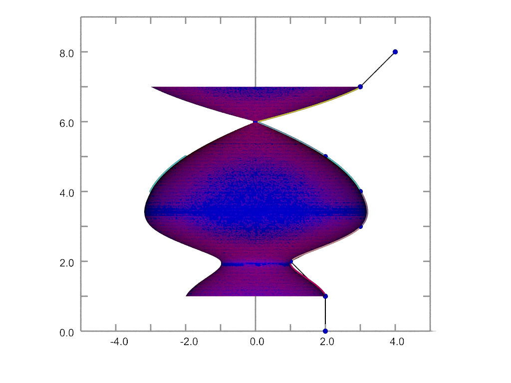

This apparently has to do with the value of "alpha" in the interpolation, with 0
being Uniform, 1/2 being Centripetal, and 1 being Chordal.
I'm not really sure where "r" comes from in the source, or how that while loop
interpolates the spline, but I just ignored all of that, and things worked out
anyway.  :D
After fixing some boneheaded visualization bugs, the math seemed to be working
out with the spline, so I took my SDL version of the SOR spline and used the X
value (minus the minor radius) as the major radius of a torus, and "plotted" a
torus at each interpolation point. (RED)
Seems to overlay the sor {} object (BLUE) very closely.  Errors are probably due
to my janky simulation method, and coincident surfaces.
I'll try to work out the details as I write things up, and I'll probably make a
parametric {} and isosurface {} object to further test how well things match up.
- BE

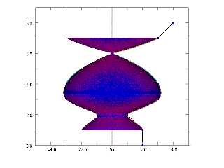

So this is the isosurface version, overlaid on the POV-Ray sor {} object
object {SOR scale 0.999999}
(It's actually one isosurface for every individual segment of the CR spline)
If I scale to 5 nines, I get a LOT more coincident surface artefacts, so I'd say
that everything is working very nicely.
I would still like to see that original 1989 paper, and perhaps I can work out
the square root thing with some level of rigor.
I'm pretty happy with what I've got, and will get working on some sort of
write-up.
If anyone has any questions, or would like to see a specific type of render,
animation, or mathematical derivation, just let me know, so I can include that.
- BE

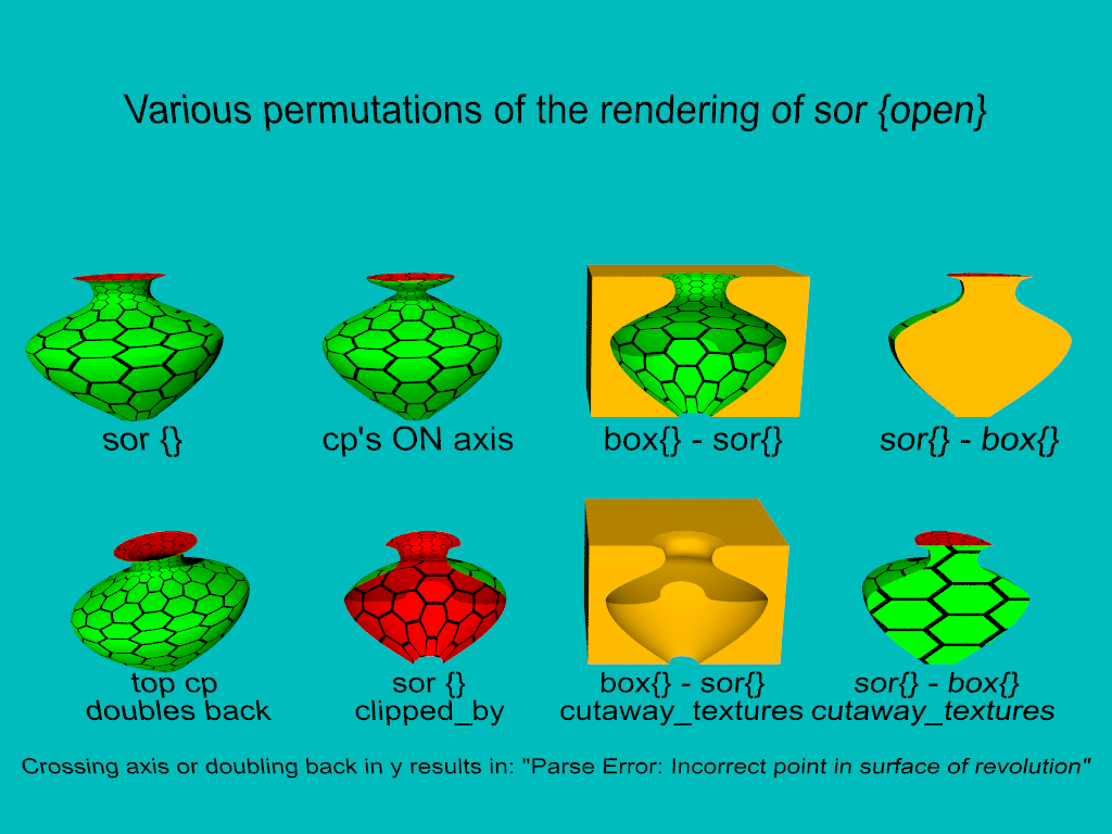

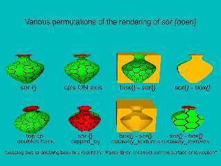

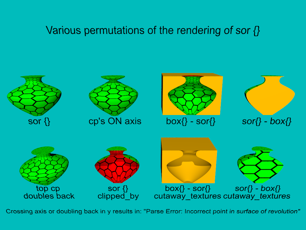

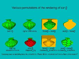

So, in the course of making some documentation renders, it became apparent that
there were a few things that were puzzling, needed to be sorted out, and some of
that was related to the behaviour of other keywords.
The following is a summary:
sor {} can have control points ON the axis, just not crossing it.
Else you get a "Parse Error: Incorrect point in surface of revolution"
I believe this is hard-coded behaviour in the source algorithm.
If I were to edit the source, it would allow the first and last control points
to cross the axis, since those points only exist to calculate the tangent
direction.
I do recall discussing this briefly in a thread with clipka and suggesting to
use abs {} somewhere in the algorithm, but I'd have to familiarize myself more
deeply with the specifics of what is going on numerically.
When using the sor {] object as the "cutter" in a difference {}, I unexpectedly
got some interior_texture {} showing in the result. Strangely enough, when i use
sor {open} the interior_texture {} is NOT visible, and I only see the surface
texture {}
When cutting away from the sor {}, I see the expected result, though I haven't
pursued this to see what more complicated geometry / CSG yields.
According to the sor {} tutorial in the wiki:
https://wiki.povray.org/content/Documentation:Tutorial_Section_3#Surface_of_Revolution_Object
"First and last point from the list are used to determine slope at beginning and
end of curve and can be defined for any height."
However, I find that to not be the case.
Swapping the first and last control points causes a
But if I only set the LAST control point y value to zero, technically making the
spline double-back in the y-direction, everything works fine.
and finally on to what sparked this whole investigation off:
I wanted to make a render comparing sor{} with sor {open}, but I had a devil of
a time slicing the vase in half and seeing the interior.
jr managed to achieve the desired result using clipped_by
As shown, when I use cutaway_textures, I DON'T see the expected
interior_texture, but the surface texture {}.  And when I use sor {open}, I do
not see a hollow infinitely thin surface, I get a solid object sliced in half.
So, I would say that there are problems with the sor {} caps, possibly with the
normal vector.
As shown in the bottom left, when I slice the sor {open} in half with a box, I
get an apparently solid object.  This is of course counterintuitive to what the
user expects, even though the documentation cautions that the open version might
yield unexpected results when used in CSG.  I would probably classify this
result as sufficiently unexpected as to warrant its classification as a bug, or
for an extended warning with the clipped_by solution to be added to the
documentation.
Futhermore, if the documentation implies that a sor is solid - just look at the
CSG results of difference {} - then clipped_by ought to give me what I'm seeing
as difference {} only with the interior_texture {} properly displayed.
Other things I notice are that there is some noisy "cruft" at the base of the
clipped_by object.  I also see some of that at the bottom of the difference{}s.
The texture is a tiling with a color_map, and is uv_mapped onto the surface(s).
As you can see on the right side of the object, the pattern does not line up
properly at the edges.  In the model below that, "top cp doubles back", I
changed the scaling of the tiling to an even number, and it now lines up.
I recall reading about properly scaling patterns so that make them fit, and that
of course employed the use of pi or tau to calculate the proper scaling.  This
might be a worthwhile keyword to implement for uv-mapping, perhaps some sort of
"scaling warp".  Likely to be pattern and direction dependent.
All objects are rendered with sturm.
Enjoy & Discuss.
- BE
Download 'sor permutations.png' (130 KB)
Preview of image 'sor permutations.png'

Same renderings, but of sor {open}
Download 'sor open permutations.png' (133 KB)
Preview of image 'sor open permutations.png'
Also, I'm curious as to why the cutaway_textures feature requires the use of an
untextured object as a cutter to be able to function properly.
One would reasonably expect that we should be able to use any object.
If, as per wiki documentation, the cutaway_textures feature result is based on
insidedness tests, then the texture of the cutter should be irrelevant.
- BE
From: William F Pokorny
Subject: Re: SOR documentation
Date: 8 Sep 2025 09:52:21
Message: <68bedf95$1@news.povray.org>

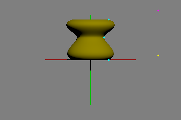

First, Are you using v3.8 beta 2 for all your testing?
Second, Did you take care when you did the differences with the box to
not have coincident surfaces with the caps (if there) or that y height
when the caps are not there?
As to the point above, I don't see what you see. The following list
works for me where I have flipped / crossed the first and last control
points(*). See the attached image where the first is magenta and the
last is yellow.
     <+1.5,+1.1> // C0
     <+0.4,0.0>  // C1
     <+0.3,0.5>  // C2
     <+0.4,0.9>  // C3
     <+1.5,+0.1> // C4
I'll try and look at some of the other issues you mention as I have
time; Including temporarily removing the x>0.0 restriction on the first
and last points to see what happens. Aside: we did remove a similar
restriction for the lathe for v3.8 vs v3.7.
(*) I tried inverting all the on curve points and this does NOT work as
I incorrectly remembered for some recent sor{} post - that must be a
lathe{} only thing.
Bill P.

Answering without thinking much, I don't think the cutaway_textures
feature copies the inside texture(*), but maybe I'm not remembering
correctly.
A reminder the yuqk fork fixed a cutaway_textures bug which exists in
official POV-Ray releases. See:
https://news.povray.org/povray.bugreports/thread/%3C65806257%241%40news.povray.org%3E/
Bill P.
(*) - The inside_texture{}s feature has a few inconsistencies, besides,
with respect to how texture{}s are handled.
Date: 8 Sep 2025 10:11:13
Message: <68bee401$1@news.povray.org>
Ah, and to quote Alain:
"When using cutaway_texture, the object used to cut away part of the
rest must NOT have any texture."
Unsure your set up with respect to the particular post, but the overall
images suggest both the box and sor might have textures ?
Bill P.
