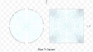

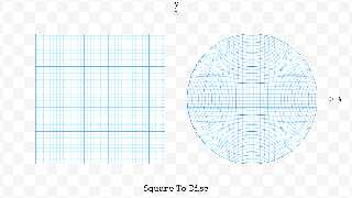

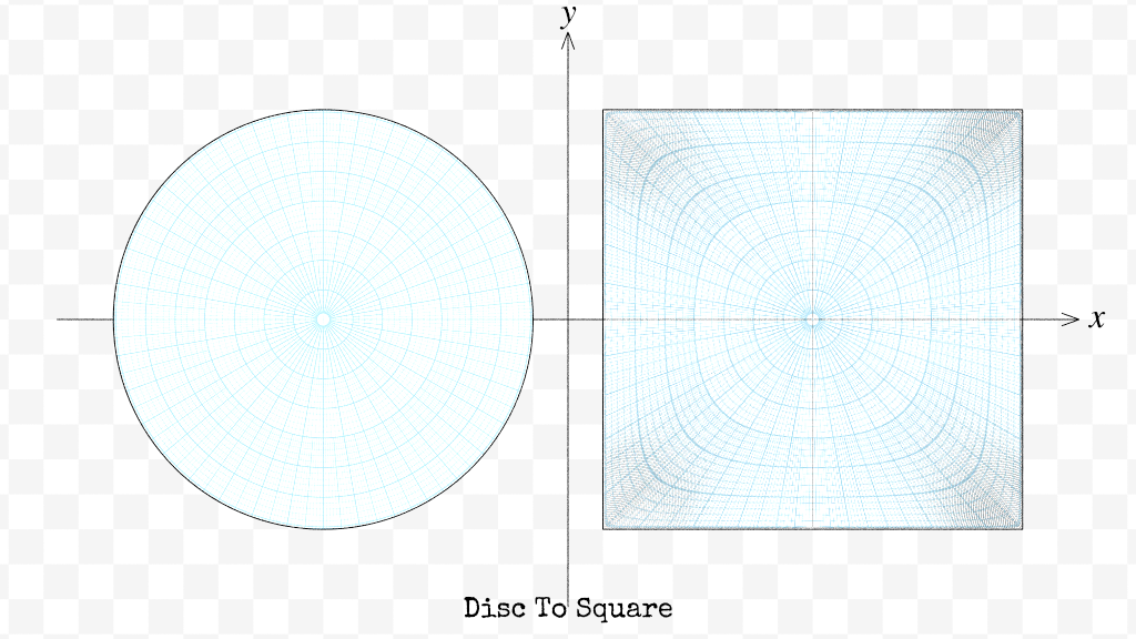

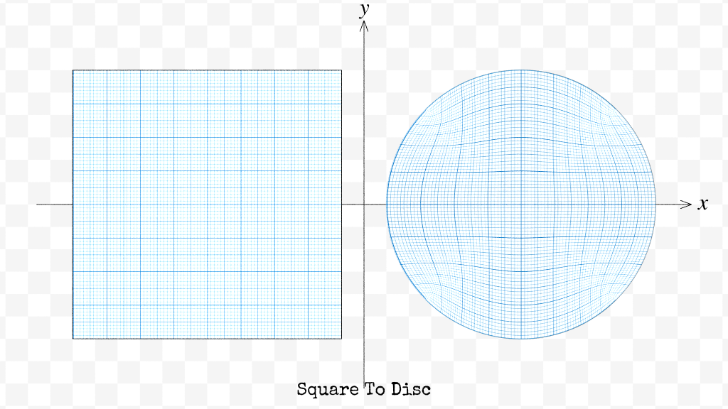

I quickly did these two scenes.
I used the silly method that gives the images as attachments.
I don't know why you have crashes.
Here is some of my code :
-- begin code ---
#declare Sq = function(x) { x*x }
#declare fnDisc2Square = function(u,v) {
sgn(u*v)*sqrt(((-Sq(u)-Sq(v)+sqrt((Sq(u)+Sq(v))*(Sq(u)+Sq(v)+4*Sq(u)*Sq(v)*(Sq(u)+Sq(v)-2)))))/(2*(Sq(u)+Sq(v)-2)))
#declare fnSquare2Disc = function(x,y) {
  sqrt((Sq(x)+Sq(y)-(2*Sq(x)*Sq(y)))/((Sq(x)+Sq(y))*(1-Sq(x)*Sq(y))))
#macro Disc2Square(U,V)
  <fnDisc2Square(U,V)/V, fnDisc2Square(U,V)/U, -0.10>
#end
#macro Square2Disc(X,Y)
  <fnSquare2Disc(X,Y)*X, fnSquare2Disc(X,Y)*Y, -0.10>
#end
--- end code ---
Values between -1 and 1 go through zero, but I don't have any crashes.
I don't know if this will help you..
Kurtz le pirate
Compagnie de la banquise
Download 'square2disc.png' (411 KB) Download 'disc2square.png' (440 KB)
