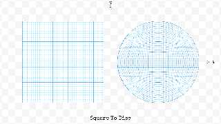

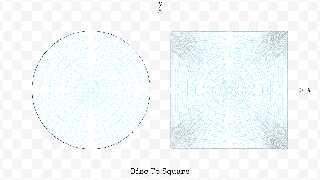

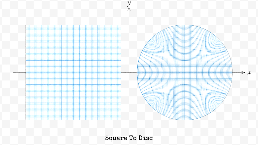

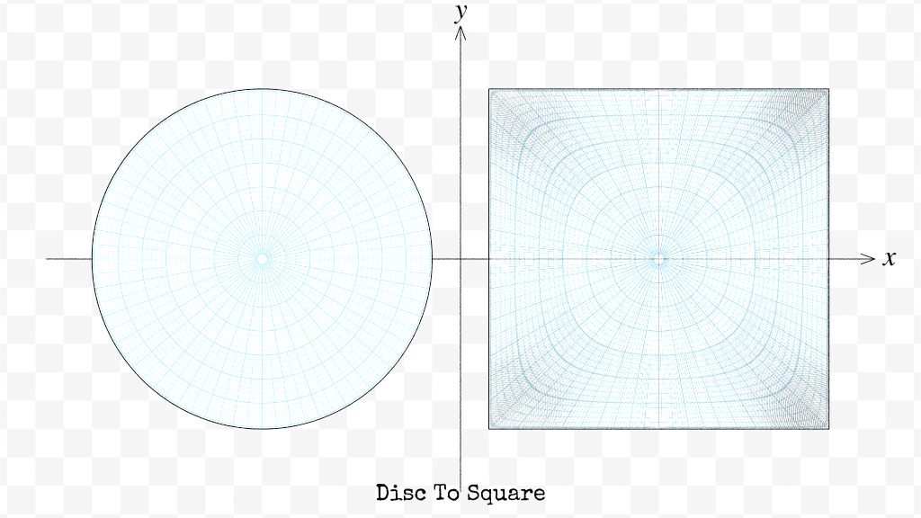

I quickly did these two scenes.
I used the silly method that gives the images as attachments.
I don't know why you have crashes.
Here is some of my code :
-- begin code ---
#declare Sq = function(x) { x*x }
#declare fnDisc2Square = function(u,v) {
sgn(u*v)*sqrt(((-Sq(u)-Sq(v)+sqrt((Sq(u)+Sq(v))*(Sq(u)+Sq(v)+4*Sq(u)*Sq(v)*(Sq(u)+Sq(v)-2)))))/(2*(Sq(u)+Sq(v)-2)))
#declare fnSquare2Disc = function(x,y) {
  sqrt((Sq(x)+Sq(y)-(2*Sq(x)*Sq(y)))/((Sq(x)+Sq(y))*(1-Sq(x)*Sq(y))))
#macro Disc2Square(U,V)
  <fnDisc2Square(U,V)/V, fnDisc2Square(U,V)/U, -0.10>
#end
#macro Square2Disc(X,Y)
  <fnSquare2Disc(X,Y)*X, fnSquare2Disc(X,Y)*Y, -0.10>
#end
--- end code ---
Values between -1 and 1 go through zero, but I don't have any crashes.
I don't know if this will help you..
Kurtz le pirate
Compagnie de la banquise
Download 'square2disc.png' (411 KB) Download 'disc2square.png' (440 KB)

"Tor Olav Kristensen" <tor### [at] TOBEREMOVEDgmailcom> wrote:
> "Bald Eagle" <cre### [at] netscapenet> wrote:
> > So here's how I got it to NOT crash, but my mapping results suck.
> > Remove all of the protective select () and mod () functions, and it will crash.
> Here's what you can do to make it work:
Sorry, I made a little mistake in the code below:
> #declare s2d =
>     function(X, Y) {
>         select(
>             X*X + Y*Y,
>             select(
>                 1 - X*X*Y*Y,
>                 sqrt(
>                     (X*X + Y*Y - 2*X*X*Y*Y)/
>                      ((X*X + Y*Y)*(1 - X*X*Y*Y))
>                 )*X,
>                 sqrt(0.5)*X,
>                 sqrt(
>                 )*X
>             )*X,
Remove the last *X above
>             0,
>             select(
>                 1 - X*X*Y*Y,
>                 sqrt(
>                 )*X,
>                 sqrt(0.5)*X,
>                 sqrt(
>                 )*X
