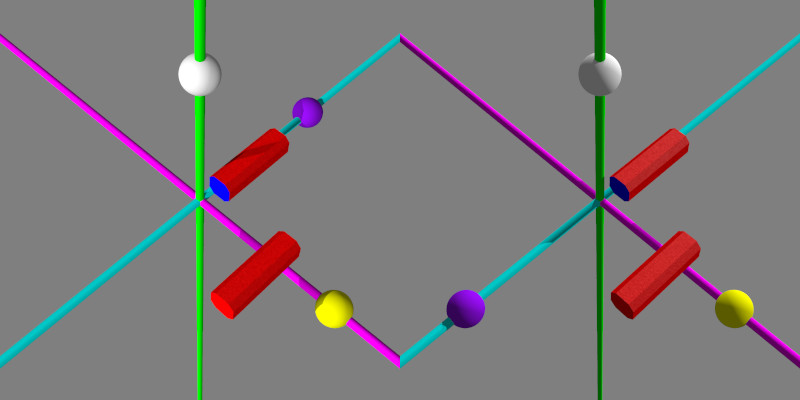

Download 'linearprismtopbotnrmldiff.jpg' (43 KB)
Preview of image 'linearprismtopbotnrmldiff.jpg'
From: William F Pokorny
Subject: Re: prism interior_texture bug
Date: 5 Jun 2016 09:11:42
Message: <5754250e$1@news.povray.org>
On 06/05/2016 07:33 AM, William F Pokorny wrote:
> On 06/05/2016 01:46 AM, Le_Forgeron wrote:
> I'll have to update that when I know what the other spline types do on
> BOTH ends.
> Bill P.
Turns for all spline types ends are inward on the bottom and outward on
the top...
I'll leave it to others whether to open an independent github issue. I
DID update all my prims test cases and attached v0.1 tarball to bezier,
prism sides issue #65:  https://github.com/POV-Ray/povray/issues/65.
I've also taken another pass at lathe and prism reference sections
updates and these can be found at:
http://wiki.povray.org/content/User:Wfpokorny
Jérôme, Do these versions look OK to you for what we see as the current
behavior ?
Bill P.
