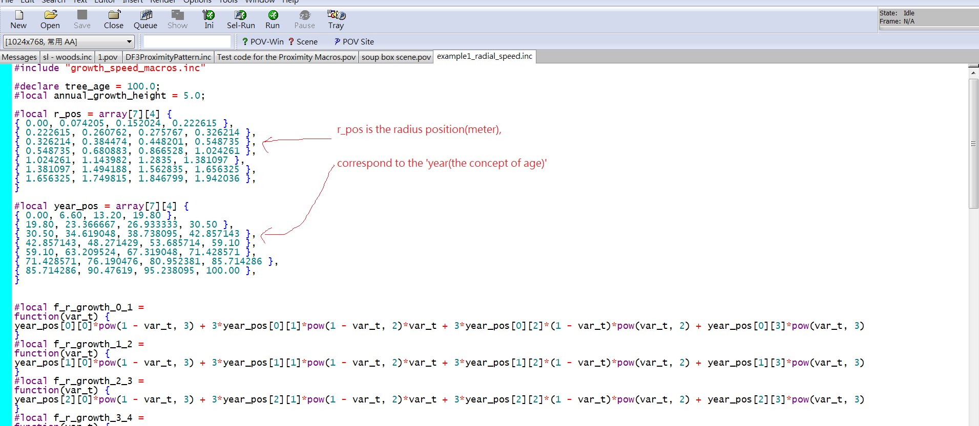

I'm not clear this time. POV-Ray cannot use a number contains commas as you
said, why I need add commas between every step of 10^3. I attach a picture, this
picture is what I saw on my output data. Is the same format on your output data?
Download 'radial_speed_output.png' (96 KB)
Preview of image 'radial_speed_output.png'
This looks ok to me and is what I expected.

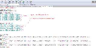

> Op 05/07/2022 om 09:29 schreef And:
> Thomas
That's great.
