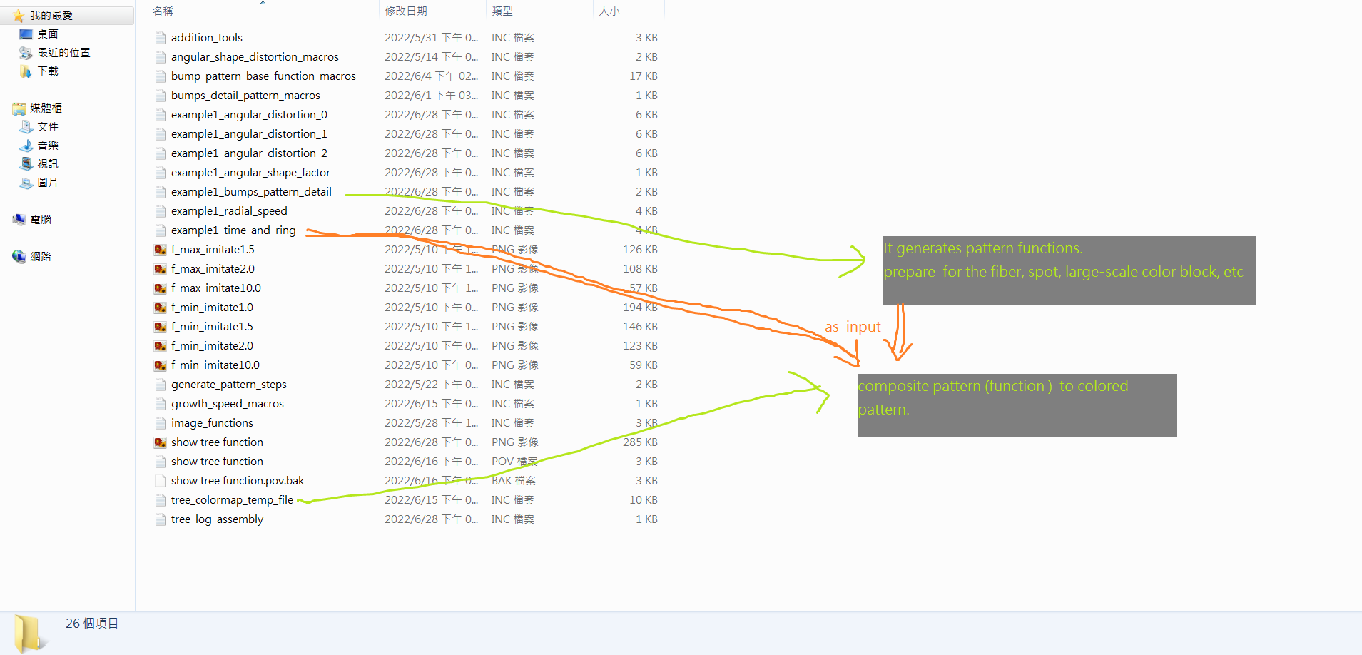

"tree_colormap_temp_file.inc" is the place I composite (all) patterns, ... to
the output pigment.
I directly copy this file from ...which made by myself.
Output pigment is named 'diffuse_pigment'. It has rgb colors. In the future it
is necessary to produce grayscale output for the roughness map, normal map...,
too.
"..._bumps_pattern_detail.inc" prepares the thin pattern, fiber, ... for the
You can produce more thin pattern here, using the macro I write
generate_thin_circled_pattern_f_input_t_theta_h(
), I only finish this one(in fact two or three, but they appointed by this one)
for generate thin pattern.
You can use any function produced by yourself.
You can change these files above.
Download 'files of the output.png' (141 KB)
Preview of image 'files of the output.png'

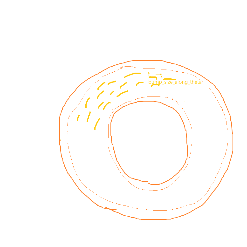

It generate bumps along theta by generating an position array[seg_amount] during
0~2*pi, it consult the input 'bump_size_along_theta' to determine the
seg_amount, the shorter the bump size, the larger the seg_amount.
'theta_pos_random_factor' controls the randomize of the positions. When it is
zero, the position is equally spaced on theta, when it is 1, the position has
the max randomize.
Download 'generate pattern macro var_theta.png' (38 KB)

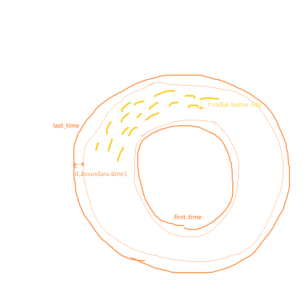

'first_time', 'last_time', 'd_boundary_time0', 'd_boundary_time1' define the
boundaries of the pattern on 'time value', you can regarded it as the radial
direct pattern.
't_radial_bump_size' as in attachment picture, unit is year.
'time_node_amount' is because, if it generate only one continuous pattern on
theta, the 'bump_size_along_theta' cannot maintain, the bump_size will get
smaller at the smaller radius. So I generate several patterns. On different
radius, I apply different seg_amount to theta position array[seg_amount]
It is the origin of it needing 'time_node_amount' to determine the amount of
such pattern on different radius. You can set it 3~5 it should sufficient.
Download 'generate pattern macro var_t.png' (38 KB)
Preview of image 'generate pattern macro var_t.png'

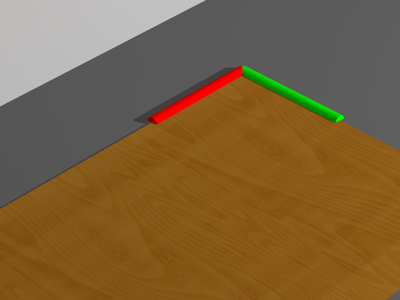

Such design is assumed the ideal situation. In fact, I'm planning to revise it.
It is obvious imperfect along the h-direct, When I ..'veneer' it, it shows no
change pattern (along theta).
Download 'show board2 radiosity.png' (1035 KB)
Preview of image 'show board2 radiosity.png'
