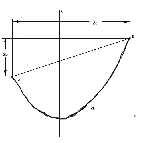

Does anyone have a real rope include file, something that does
end-points and length... the math is a little complex for me to solve.
um... if it helps, here's the math:
(quoted from Mark's standard handbook for mechanical engineers)
Given the Length 2L of a chain supported at two points A and B Not in
the same level, find a (b,c are suposed to be known)
Let (sqrt(L^2-b^2)/c = s/x; use s/x = sinh(z)/z to find z. then a = c/z.
well, here's a pic too...
have fun all, and i hope someone can help with this...
      the Loial Raven
Download 'math.gif' (11 KB)
Preview of image 'math.gif'

Well, You should have search for the chain include.
At least it does the end-points and a sort of looselyness.
(afterall, a rope could be modelled as a chain with very small links).
Counting the number of links, it gives you back the length,
but I do not remember if it provide the coordinates of the low point...
