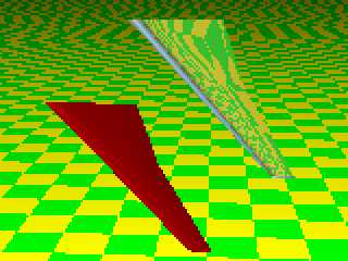

This is the scene-file that demonstrates the problem with shiny bicubic
patches.
In the povray.binaries.images I have uploaded some graphics that show you
the location of the control points, to "prove" that the edges connect and
line-up smoothly.
This message belongs to "Re: Possible bug in shiny bicubic_patch (82kb)" in
povray.binaries.images and "Re: Possible bug in shiny bicubic_patch" in
povray.general
Download 'object_view.zip' (3 KB) Download 'object_view.png' (10 KB)

I see in your code that you // commented flatness in your patches.
Did  You try with flatness 0? default is 0.001 and it lets sometimes patches
to follow slightly different curves and opens gaps.
Marc

According to docs the default is 0. See copy of help-file-text below.
I tried your suggestion anyway, but it doesn't solve the problem.
"As POV-Ray processes the Bezier patch it makes a test of the current piece
of the patch to see if it is flat enough to just pretend it is a rectangle.
The statement that controls this test is specified with the flatness keyword
followed by a float. Typical flatness values range from 0 to 1 (the lower
the slower). The default if none is specified is 0.0."
