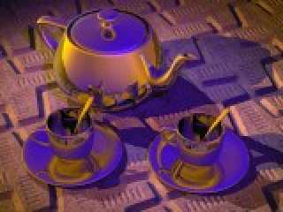

Greetings, POV'ers !
If anyone perhaps has the source for the original old
"KKTEASET" picture that is currently on Povray's home page, would they
please be so kind as to post it, or perhaps mail me ?? I am asking because
I would like to see how the 'ground' texture was done. That rough stone
tiling effect. I think it's excellent, and I would like to do someting
similar for an animation scene I'm working on.
Much appreciated !
Fanx a bunch !
Charl  :)
Mail addy : Lut### [at] hotmailcom

I finally found this kkteaset.zip. But  in this zip there's the same
image than in the pov's site and a file "kkteaset.s" wich i'm not able
to use. Maybe you'll know how to? whenever you'll be able to use it
or if you find a usable script, let me know.
Good luck!
David Etter Perere
-sorry for my weak english-

I can see now what is this kkteaset.s. Really sorry! No script!

I have kkteaset.zip on the povray cd. I looked at "kkteaset.s" which is
nothing more that a jfif image. There is no kkteaset .pov file in that
zip archive.

I also have the povray CD, and  I found the same file on there,
zipped with a jpg image.
Unfotunately that brings me right back to square one....
If anybody knows where I can find the source for this image,
I would be real happy. All I want is the ground stone texture source.
I want to do sometnig similar, but with a different design.
I have tried a few heightfields, but I just can't get the effect I want.
Seems to be quite a tricky one this.
Fanx !!    ;)

If you're thinking about the image I think you're thinking about, then
you've got a problem. The effect you see is due to a bug in POV-Ray's
interpretation of normals (and bump_maps in particular iirc). I think
the bump_map has been fixed at some point of the 3.1 development, but
the general normal bug is still there, thus rendering any attemp to
reproduce the effect with a height_field imposible. I think you just
have to come up with the right bump_map and render it with, say, 3.0.
I might be wrong, though. Life shows I often am :)
