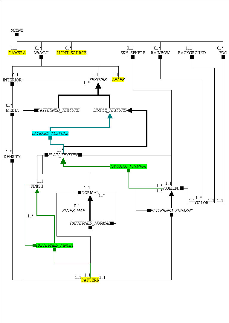

I had too much time waiting for the 3.5, so I played with 3.1 ...
I tried to represent a scene with some UML goodies (not strictly sticking to the
standard), and I'm wondering if it wouldn't be better to replace the layered_texture
(in Cyan in the picture) with a layered_pigment (in Green), because it is rather
how it works in reality.
Also, it's seems that a patterned_finish is somehow missing, even if it can currently
be done using the patterned_texture. (The green part attached to the finish does
not exist).
Wouldn't it be simpler to restrict the control at the lowest level, or
is there a real gain to also have a patterned_texture ?
Any thought on these ?
Any interest ?
Is there any one reading ?
P.S.: Do not pay attention to the yellow tags, they are just the parts which
are the most likely to get extensions whenever someone make a patch.
Non Sine Numine
http://grimbert.cjb.net/
Etiquette is for those with no breeding;
fashion for those with no taste.
Download 'povuml2.png' (8 KB)
Preview of image 'povuml2.png'

If you cover some parts of a mirror with paint, you don't get the mirror
finish on the paint. Rather you get one texture of pure reflection partly
covered with little reflecting green surface. This is what you get with
layered & patterned textures.
If you want a common finish to multiple textures you should use a clear
texture over multiple pigment only textures because it is rather how it
works in reality :-) (a thin film on the surface is what usually does
reflect)
But I agree layered pigments might come in handy though layered textures do
exactly the same (apart from metallic, I presume). One warning, though:
multiple textures each containing a finish get their finishes evaluated
separately, tracing one ray multiple times

Wouldn't it be simpler to handle the finish and pigments separatly ?
Unless you have a subsurface-scatering model (and you'd better fake
it than tracing all these rays), I do not see the point of having
layered finish: only the topmost one is the finish you will ever see.
It's a bit like normal, what would be the sense of layered normal ?
(averaged or whatever patterned, I can understand, but layered
normal is such a strange idea...)
> reflect)
Or you can duplicate the finish everywhere, but what is your point ?
They do the same, but layered textures just seems so wrong in the
scope that textures have reached.
I do not understand that.
