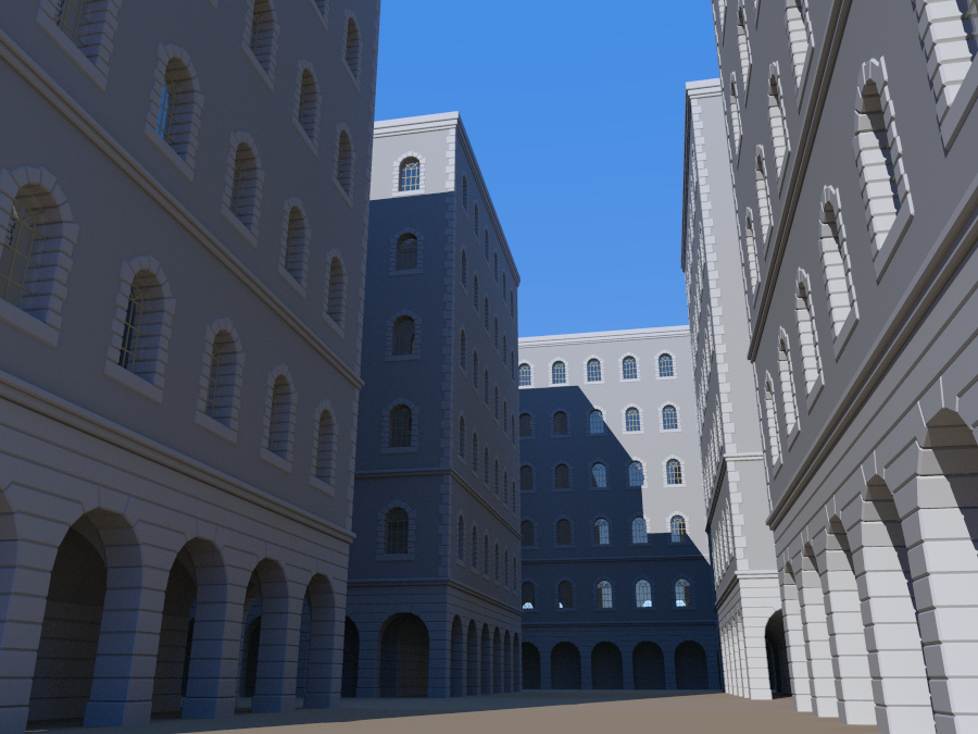

Progress in my ongoing autogenerated buildings project is glacial, but as always
the holiday season gives me some time to implement ideas that usually only get
to the mulling stage. Here's a nice recent render.
It's a vaguely-beaux-arts styled building, copied 5 times over to make a narrow
city street. The building is constructed as separate floors, each floor made up
of a series of 'block' meshes, each block containing an arch or a window. The
blocks are carefully designed to tesselate nicely, especially in the ground
floor cloisters. Because each block is essentially a single mesh (or 2 meshes,
if window panes are required), the scene renders extremely quickly (~30 mins
using UberPOV on a 12yo MacBook, or just a few seconds if I turn off the
radiosity).
Some things I'd like to do:
- L-shaped corners in buildings
- stack sub-buildings
- randomly vary the main parameters to give different buildings
- simple street furniture
Bill
Download 'autobuildings.jpg' (282 KB)
Preview of image 'autobuildings.jpg'

This is looking extremely good, Bill! One of those things I have on my
ToDo list since... I do not know when.
Of course! I am going to follow this progress with great attention. Hope
you will find the time to implement.

In any case, I think the lighting is excellent.
Afterwards, it's true that it lacks a little randomness.
Good job.
I can't wait to see how this project progresses.
kurtz le pirate

I am following this work with great interest! (My own city buildings from years
past were made in a different way.)
So, how did you create your meshes? They do not quite look like height_fields
that have been flipped to be vertical instead of horizontal; the quality and
detail of the meshes looks better than that technique, to my eyes.

Awesome lighting, and picture angle.
The only modeling feature that seems strange is the roof lines of a too straight
and simple architecture as compared to the rest.
Otherwise, the restricted amount of variety would seem credible if surrounding
is like the inside of some fortifications, close to some palace... Also, the
furthest building displays an inner light reflection that does seem to invite
the eye to search there for some tiny indoor detail :-)
It's a complex stack of macros with probably far too many arguments. The lowest
level produces bevelled boxes, simple boxes and arches, simply making mesh
triangles with no parent object. Higher level macros assemble wall sections,
columns and arches from these boxes that can be grouped into meshes and unions.
The top level uses a small list of block objects to make a building floor.
I'm passing transforms down through each level, combining them and applying them
to the triangle points at creation. The individual brick meshes are not reused,
instead all the bricks and walls are built separately and put into one large
mesh. This is not optimal from a triangle count standpoint, but a bevelled box
doesn't contain many triangles so I thought it was a good tradeoff for less
convoluted code structure.
Most of my time is spent keeping it clearly laid out and well-documented,
because often weeks or months might elapse between bouts of effort, and I have
to be able to pick it back up quickly!
Bill
Yep, I have UberPOV to thank for the lighting, I only need to balance the
gray_threshold and brightness, arrange for pleasing shadowed areas, then give it
enough of a count value to minimise the grain.
Yeah the floor divisions and roof edges were the last thing I did, and I kept
the geometry simple so I could get something decent rendered :)
> Also, the
Haha I should probably block off the interiors in some way to prevent the
emptiness being too obvious! There are internal floors, but no walls.
