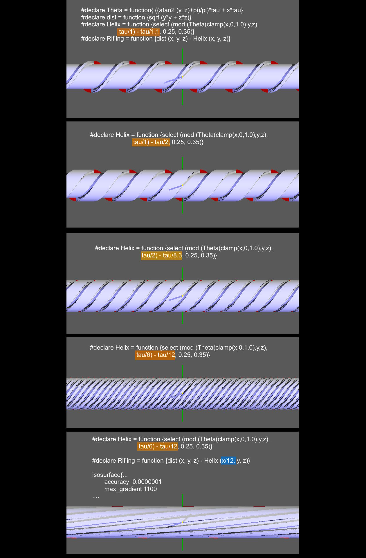

"Kenneth" <kdw### [at] gmailcom> wrote:
> Hey guys, what I'm seeing is that this and the original version of Theta look
> the same in the isosurface-- or else I'm totally mistaken about what B.E.'s
> original problem was?? I thought it was the truncated spirals in -x, where they
> abruptly stop at y=0. Take a look at my comparison image.
> Sorry if I totally misunderstood the problem(?)
Nope - you got it.
I had a few spare minutes last night and pasted Chris' fix into my scene and it
worked as claimed.
Maybe start with a fresh copy of my scene and make the minimum necessary
correction.
(comment out my Theta function, and just paste Chris' 2 functions in after
that.)
I'm guessing that you have something in your scene that snuck in that you
haven't undone.
- BW
From: Kenneth
Subject: Re: Helical SDF for Isosurfaces
Date: 24 Dec 2024 09:40:00
Message: <web.676ac6794a98c6d6e83955656e066e29@news.povray.org>
> Nope - you got it.
> worked as claimed.
> correction.
> that.)
> haven't undone.
Interesting! I need to take another look at that. Admittedly, my eyes and brain
were starting to fuzz over from hours of 'ultra concentration' (although I
thought I double-checked everything before posting...)
Meanwhile...
I came up with this little change for your own code, using 'clamp'. It might be
considered a 'hack', but it solves two problems at once: no more truncated
spirals; and the rifling is now continuous in both +x and -x (with no glitch at
x=0.)
#declare Helix = function {select (mod (Theta(clamp(x,0,1.0),y,z),
                 tau/3) - tau/6, 0.25, 0.35)}
Limitations:
clamp's 'max' value needs to be 1.0 (or any integer multiple of 1.0; it doesn't
seem to matter.) But no fractional part.
The first tau's divisor: any integer of 1.0 or greater, no fractional part.
The second tau's divisor can be anything > 1.0, any float value.
Download 'rifling_for_be_3__kw.jpg' (261 KB)
Preview of image 'rifling_for_be_3__kw.jpg'
From: Chris R
Date: 24 Dec 2024 10:15:00
Message: <web.676acf024a98c6d63a6dfc485cc1b6e@news.povray.org>
> "Chris R" <car### [at] comcastnet> wrote:
> > I got it to work by making the following change:
> > #declare natan2 = function(a,b) { select(a, 2*pi+atan2(a,b), atan2(a,b)) }
> > #declare Theta = function {((natan2 (y, z))/pi)*tau + x*tau}
> > The problem is that atan2 has that discontinuity where it jumps from pi/2 to
> > -pi/2, which happens along the edge you are looking at, and is made visible by
> > the switch in sign of the x value (x*tau).  The natan2 puts that discontinuity
> > at opposite ends of the value range, rather than in the middle and makes all of
> > the resulting angles positive (0-2*pi), and thus there is no abrupt switch when
> > x goes negative.
> > -- Chris R
> Most Excellent, fine Sir!
> Some days I can see what needs to be done - other days it's more . . . opaque.
> I'm officially voting that such be made an internal function, or at least
> something available in functions.inc
> This could save a lot of people a lot of trouble in the future.
> Thank you,
> - BW
No problem.  I don't know how many times I have been tripped up by how atan2
works.
If you grab my libfn.inc from GitHub, https://github.com/carath63/povlibrary I
have defined f_normalized_atan2(x,y) already.  It would be good to have as a
builtin in a future version of pov-ray, but in the meantime, if you are using
any of my code in your scenes, it is already defined there.
-- Chris R
