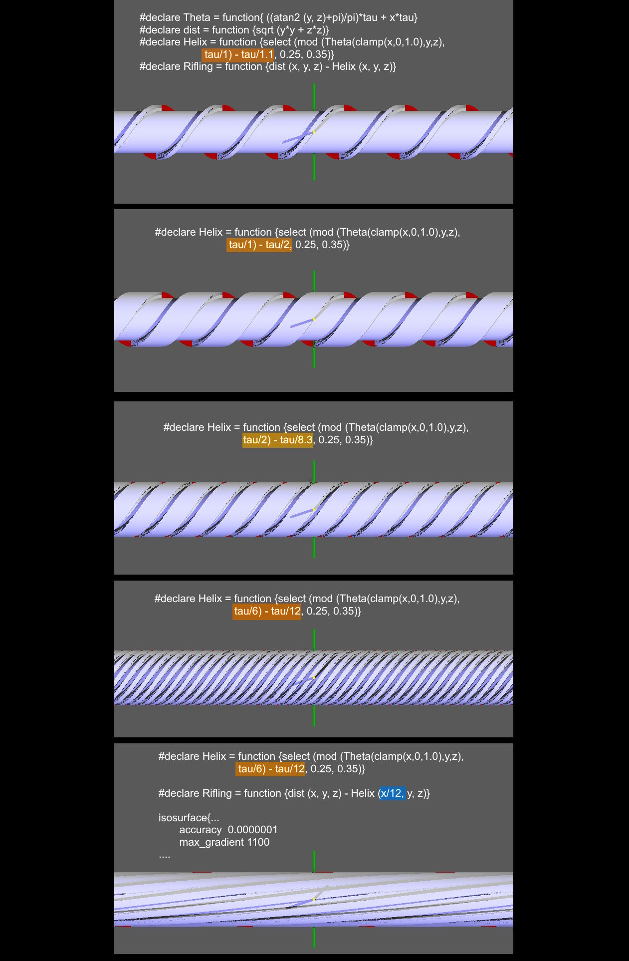

"Kenneth" <kdw### [at] gmailcom> wrote:
> Hey guys, what I'm seeing is that this and the original version of Theta look
> the same in the isosurface-- or else I'm totally mistaken about what B.E.'s
> original problem was?? I thought it was the truncated spirals in -x, where they
> abruptly stop at y=0. Take a look at my comparison image.
> Sorry if I totally misunderstood the problem(?)
Nope - you got it.
I had a few spare minutes last night and pasted Chris' fix into my scene and it
worked as claimed.
Maybe start with a fresh copy of my scene and make the minimum necessary
correction.
(comment out my Theta function, and just paste Chris' 2 functions in after
that.)
I'm guessing that you have something in your scene that snuck in that you
haven't undone.
- BW
From: Kenneth
Subject: Re: Helical SDF for Isosurfaces
Date: 24 Dec 2024 09:40:00
Message: <web.676ac6794a98c6d6e83955656e066e29@news.povray.org>
> Nope - you got it.
> worked as claimed.
> correction.
> that.)
> haven't undone.
Interesting! I need to take another look at that. Admittedly, my eyes and brain
were starting to fuzz over from hours of 'ultra concentration' (although I
thought I double-checked everything before posting...)
Meanwhile...
I came up with this little change for your own code, using 'clamp'. It might be
considered a 'hack', but it solves two problems at once: no more truncated
spirals; and the rifling is now continuous in both +x and -x (with no glitch at
x=0.)
#declare Helix = function {select (mod (Theta(clamp(x,0,1.0),y,z),
                 tau/3) - tau/6, 0.25, 0.35)}
Limitations:
clamp's 'max' value needs to be 1.0 (or any integer multiple of 1.0; it doesn't
seem to matter.) But no fractional part.
The first tau's divisor: any integer of 1.0 or greater, no fractional part.
The second tau's divisor can be anything > 1.0, any float value.
Download 'rifling_for_be_3__kw.jpg' (261 KB)
Preview of image 'rifling_for_be_3__kw.jpg'
