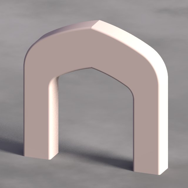

Hi,
A four-centered arch. Macro coming up shortly.
Sam
Download '4-centeredarchc.jpg' (19 KB)
Preview of image '4-centeredarchc.jpg'

Here it is. The outer and inner arches are defined separately by width, height
and corner radius (smallest circle). Everything else applies to the entire
object.

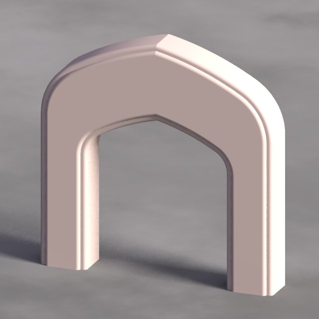

Here's a helper macro to make arches with inset surfaces. You can specify both
inset amount and inset depth.
#macro FourCenteredArch_Inset(AW1, AH1, CR1,  AW2, AH2, CR2,  AD, BV, IN, ID)
 #local Eps = .0001;
 union{
  FourCenteredArch(AW1, AH1, CR1,  AW2, AH2, CR2,  AD-ID, BV)
  object{
   #local DP =  max(BV+Eps, ID);
   FourCenteredArch(AW1-IN, AH1-IN, CR1-IN,  AW2+IN, AH2+IN, CR2+IN, DP, BV)
   translate - z*(AD-DP)
#end
And its usage:
object{
     1.0, // arch width 1 (from center)
     2.0, // arch height 1 (from ground)
     0.3, // radius 1 (outer corner, >=0 & <=arch width 1)
     0.6, // arch width 2 (from center)
     1.35, // arch height 2 (from ground)
     0.1, // radius 2 (inner corner, >=0 & <=arch width 2)
     0.3, // arch depth (to -z)
     0.013, // edge bevel radius (>arch depth)
     0.05 // inset amount
     0.025 // inset depth
Download '4-centeredarchc-inset.jpg' (23 KB)
Preview of image '4-centeredarchc-inset.jpg'
