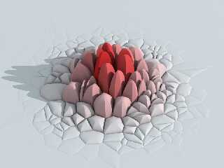

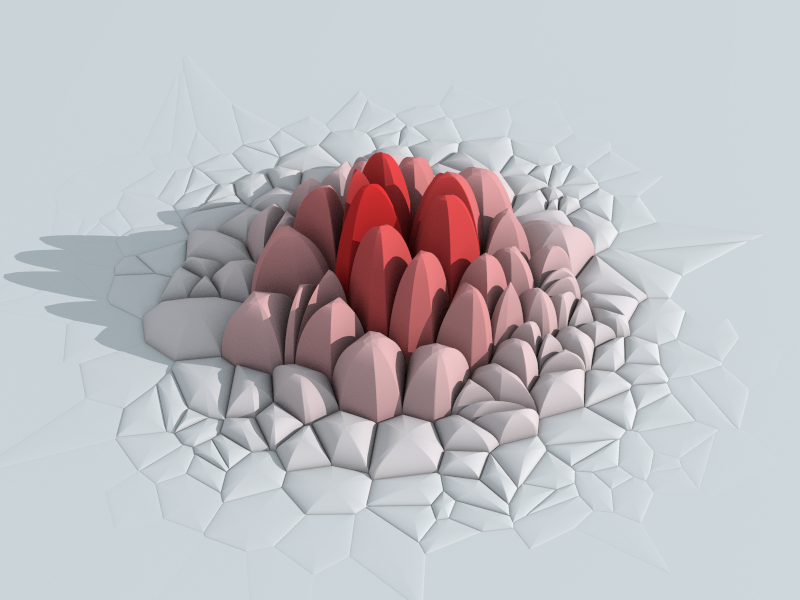

So this has kind of run away from me a little. It turns out that the voronoi
polygons are far, far more useful than the pigment pattern.
This image is something of an ad-libbed abstract, arising from my vague desire
to do something with these polygons that would be impossible with a crackle
pattern heightfield. Culling collinear points from each polygon saves time and
memory, but also enables us to discard polygons with sides over a certain
length. This removes the infinite outer polygons in the voronoi set. We can also
modify height and color according to location, and of course we can do whatever
we want to build a 3D shape.
Anyway, enough rambling :)
Bill
Download 'cracklewarts.png' (447 KB)
Preview of image 'cracklewarts.png'
> length.
And sides under a certain length...   ;)
And with that very cool twist on Voronoi, no, we are definitely not bored yet.
Very cool image - looks like ice jutting up through the ice/snow in the arctic.
With a glass-type texture, you could even use this to make some convincing
crystal growths.   Submerge them in a liquid to make it look like they're
growing out of the mother liquor...
I was looking at a cantaloupe - and the texture is suggestive of a Voronoi - but
it's not.   I'm wondering if we can do the cylinder thing but only partially
outline the cell.
Also, we have not created a point set on the outside of a sphere and made the
Voronoi from those points...   So the next challenge is 3D.

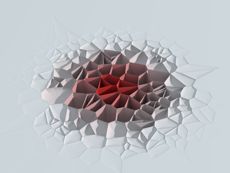

Can you invert that and difference {} the prisms from the plane?
I also think another specific goal would be to make an infinitely tileable
pattern such as POV-Ray has.   And if you toned down the amplitude of the
current scene, and we made it tileable, then I think it would make a cool dried
mud / dry skin texture, that TdG could apply to a Poser model.
yep
Download 'cracklewarts_inv.png' (336 KB)
Preview of image 'cracklewarts_inv.png'
