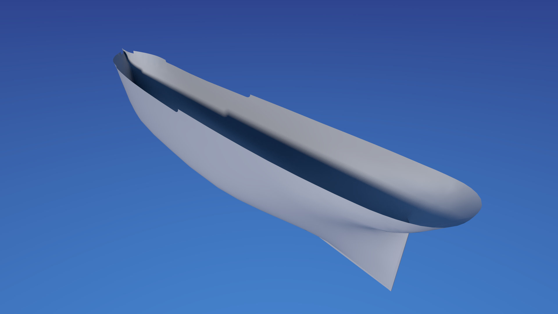

After a long hot summer, with the nights getting longer, and the days getting
colder, it is time to start a new project. Maybe I'm overreaching myself, but
the bar has to be higher every time.
I decided to do the Balclutha, a steel-hulled, full-rigged ship, built in
Glasgow in 1886.
She is now a museum ship in San Fransisco.
(https://en.wikipedia.org/wiki/Balclutha_(1886))
The Library Of Congress website has detailed plans and photos of this ship, so I
have all the information to model this ship. Here is the start:
I've modeled one side of the hull, in Blender, exported the .obj-file, and
created a mesh2-file.
Ton.
Download 'forum1.jpg' (80 KB)
Preview of image 'forum1.jpg'

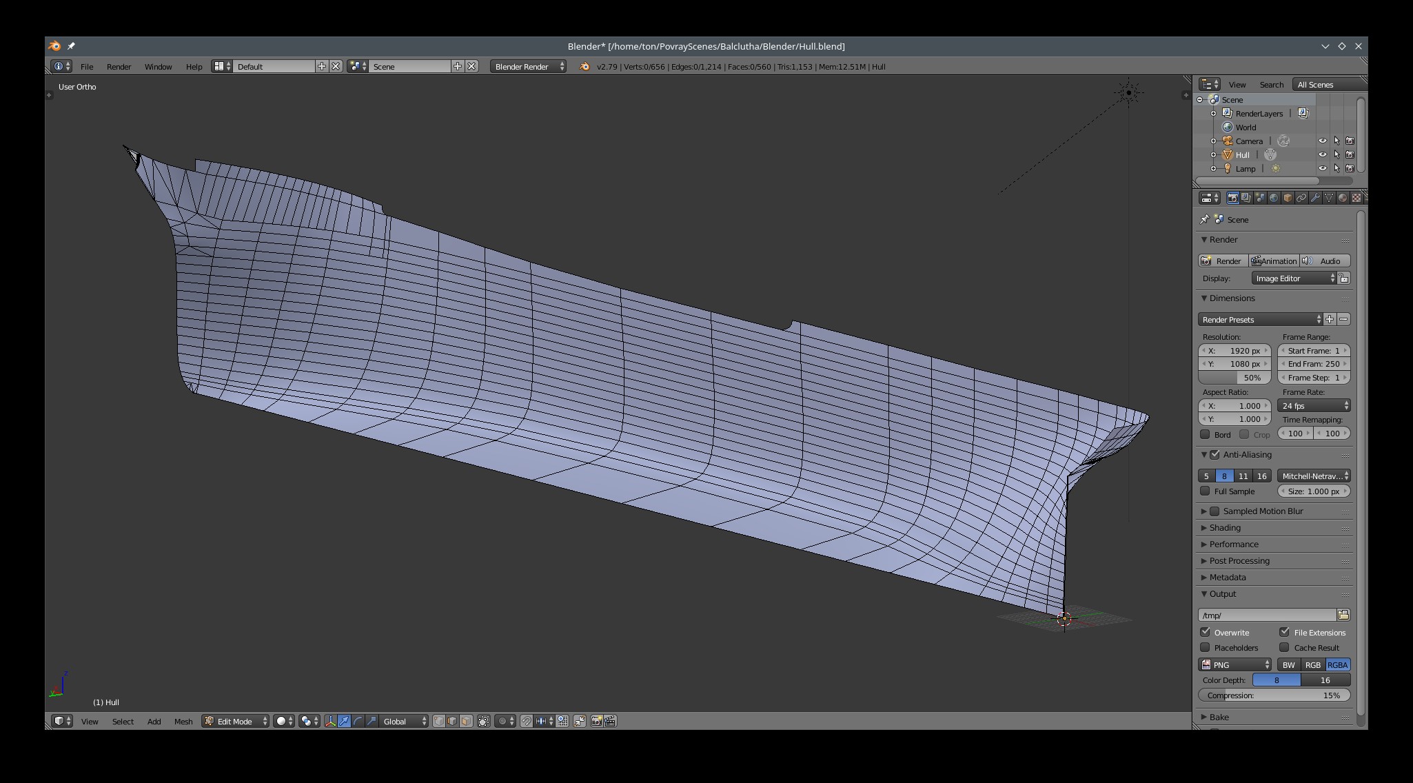

Good start. How did you model the hull: nurbs?
From: Ton
Subject: Re: Sailing ship Balclutha
Date: 29 Mar 2022 19:05:00
Message: <web.62438fccbeadc5ebad1330e67597fb06@news.povray.org>
> Thomas
Bedankt Thomas.
I used Blender, and transformed the obj output in mesh2, with normals.
Ton.
Date: 30 Mar 2022 02:33:04
Message: <6243f9a0$1@news.povray.org>
Op 30/03/2022 om 01:01 schreef Ton:
>> Thomas
> Bedankt Thomas.
Indeed, but what I mean: /within/ Blender, how was the hull surface
modelled? I do not use Blender so I thought maybe it was generated with
the help of a nurbs tool, which is not available in my Silo package.
 From my experience, hulls are not very easy to model without it I
think, or some similar tool.
From: Ton
Date: 30 Mar 2022 06:10:00
Message: <web.62442c60beadc5ebad1330e67597fb06@news.povray.org>
> >> Thomas
> > Bedankt Thomas.
> Thomas
With the help of the hull profile plans I can determine the X, Y, and Z
coordinates of the hull. X is forward-backwards, Y is up-down, and Z is
left-right (or port-starboard). I start with a plane I subdivide when necessary.
In that way I work down the hull. When exporting to obj-file I (well, blender)
triangulates those rectangles. You see the result, quite convincing.
I have mirrored the hull, added the keel, which are povray objects from
roundedge.inc.
Ton.
Download 'forum4.jpg' (349 KB)
Preview of image 'forum4.jpg'

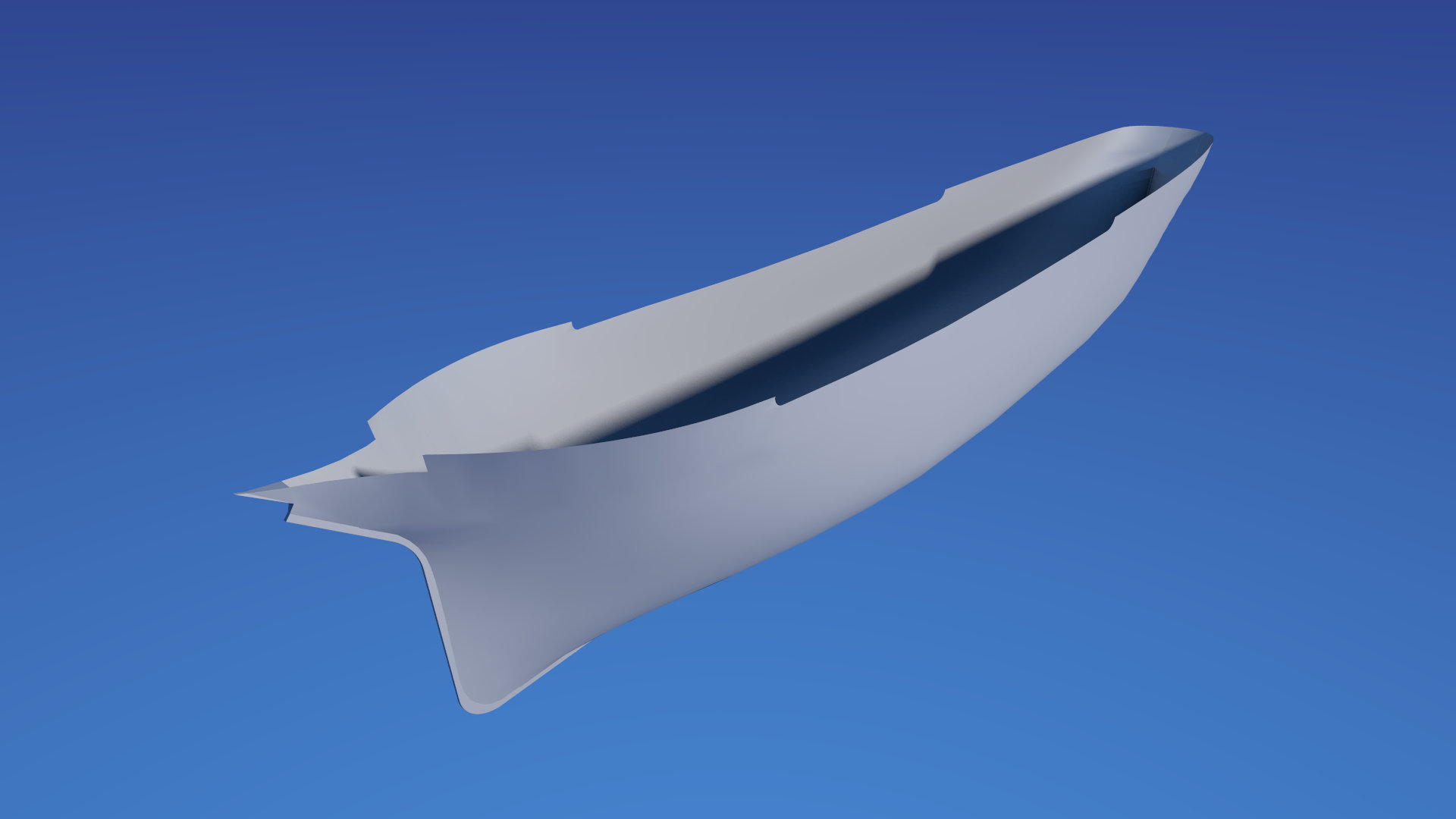

Download 'forum2.jpg' (92 KB)
Preview of image 'forum2.jpg'

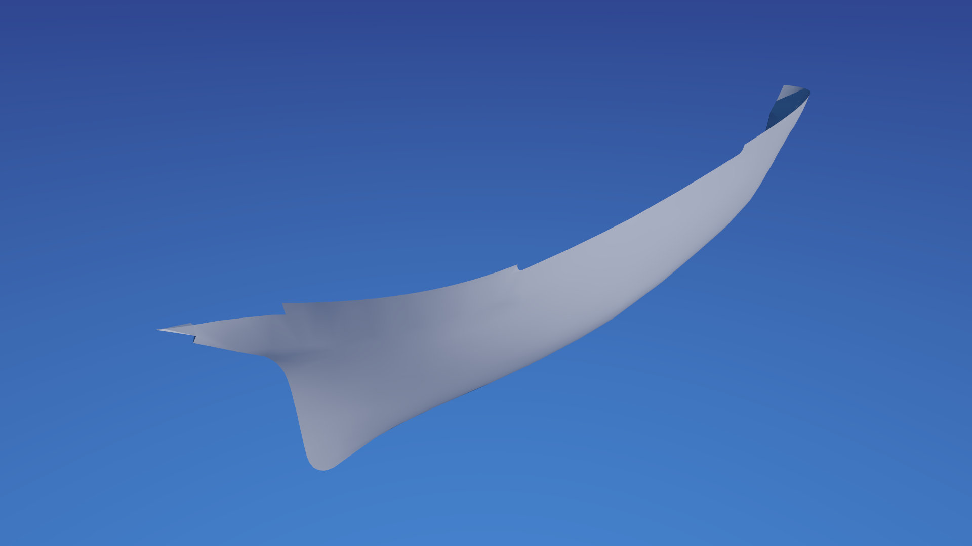

Download 'forum3.jpg' (91 KB)
Preview of image 'forum3.jpg'
Date: 30 Mar 2022 07:44:54
Message: <624442b6$1@news.povray.org>
Op 30-3-2022 om 12:09 schreef Ton:
>>>> Thomas
>>> Bedankt Thomas.
>> Thomas
> roundedge.inc.
> Cheers
> Ton.
OK, that is pretty much as I modelled my VOC ship (Dutch East Indies
Company) many years ago. I also used the profile plans in a similar way.
http://www.irtc.org/ftp/pub/stills/2005-04-30/direpass.jpg
This one was an earlier version (2005) built in Moray.
Date: 31 Mar 2022 02:24:57
Message: <62454939$1@news.povray.org>
Maybe you know DELFTship? I have been using its free version:
https://www.delftship.net/delftship/
It is very comprehensive.
