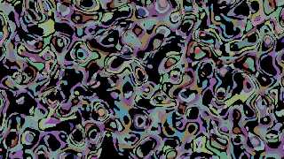

I just tried an orthographic camera, and I get the same distortion results
(needing the same corrections as before.)
And just for fun, here's the same scene + orthographic camera, but using the
bumps pattern for the normal.
Sophisticated art! :-P

Download 'camera_normal_using_bumps_jpeg.jpg' (174 KB)
Preview of image 'camera_normal_using_bumps_jpeg.jpg'
