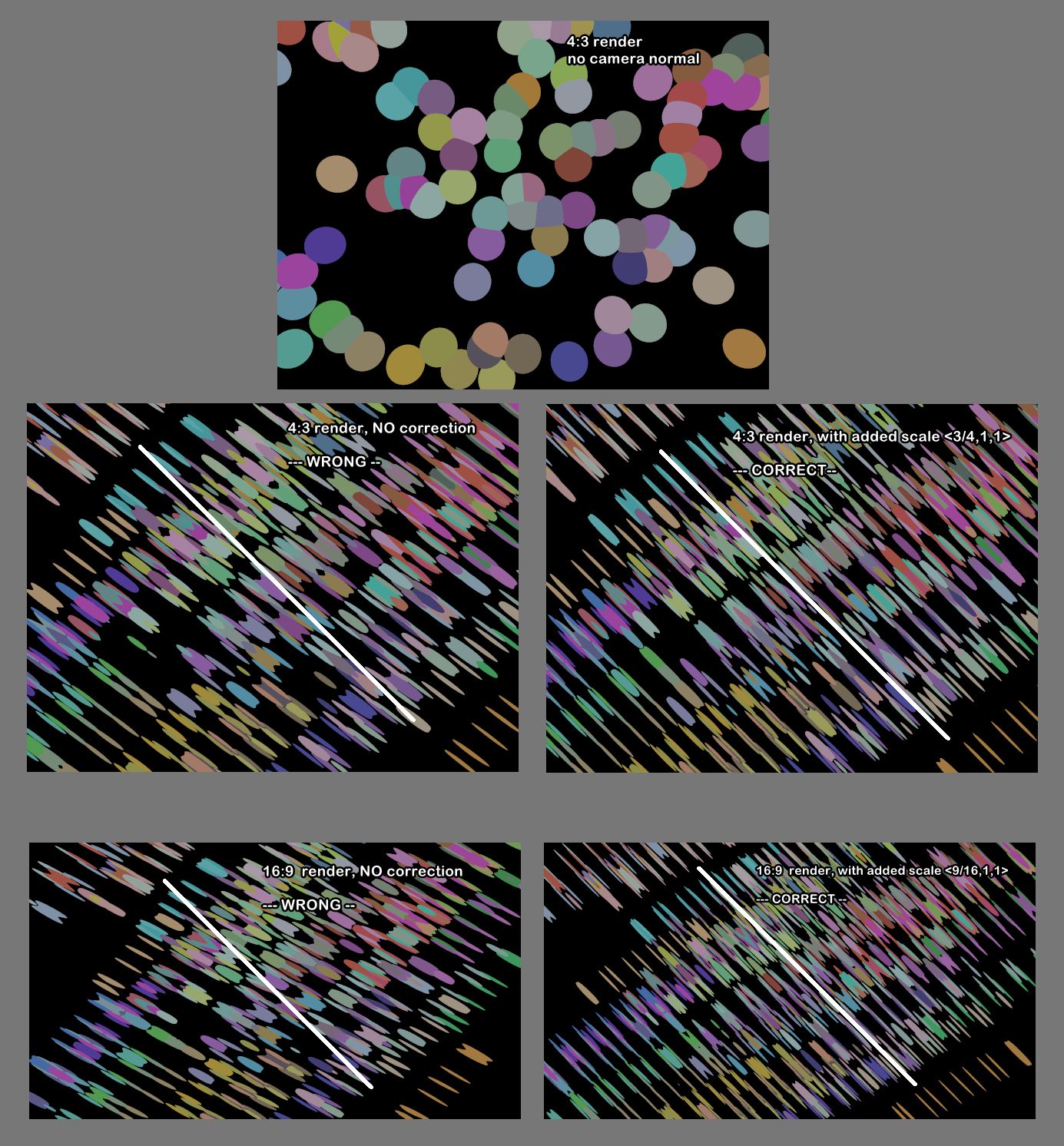

I sometimes use a 'normal' block in a camera statement, for interesting and
un-planned effects.  While playing around with that, I noticed that my renders
looked... different... depending on the aspect-ratio that I chose -- like 4:3
vs. 16:9.  After eliminating other possibilities, it occurred to me that the
problem was due to the aspect ratio's scaling of the normal pattern.  The normal
itself has to  have a *reciprocal* scaling applied (in x) to account for the
aspect ratio-- even with a typical 4:3 render. Otherwise, the normal is
'distorted'.
The documentation at   '3.4.2.4 Camera Ray Perturbation'  does not mention this,
nor does the example scene 'camera2' that is referenced there.  I had always
thought that a  camera normal was independent of the actual IMAGE aspect ratio,
or would automatically compensate for it; but not so. I tested only the
perspective camera; I don't know what happens with the other types.
An 'un-corrected' camera normal is meant only for a *square* 1:1 rendered image.
That makes sense of course, because any normal or pattern is intrinsically 1:1:1
in 3-D space. But when used in a CAMERA, a scaling has to be added to keep the
normal's pattern correct re: a chosen aspect ratio.
This 'extra' distortion is not obvious when using, for example, a bumps pattern
for the normal. So I set up a  test scene with a strict 45-degree gradient x+y
normal, where the resulting aspect-ratio distortion is obvious. (I added the
white lines later, in an image-editing app.)
#version 3.8;
global_settings{assumed_gamma 1.0}
#default{finish{ambient .4 emission 0 diffuse 0}}
camera {
  perspective
  location  <0, 0, -20>
  look_at   <0, 0,  0>
  right     x*image_width/image_height
  // direction z
  // angle 67
  normal{
  gradient x+y // a 45-degree pattern
  sine_wave
  scale .1
  bump_size .4
  / /scale <3/4,1,1> // for 4/3 render
  // OR...
  // scale <9/16,1,1> // for 16/9 render
  // -- etc. --
#declare S = seed(21);
#for(i,1,100)
sphere{0,1
 pigment{rgb <.1 + .9*rand(S),.1 + .9*rand(S),.1 + .9*rand(S)>}
 translate <-15 + 30*rand(S), -10 + 20*rand(S),0>
#end
Download 'camera_normal_comp.jpg' (376 KB)
Preview of image 'camera_normal_comp.jpg'

That is interesting indeed. I guess you could use the camera 'right' for
the normal, like:
scale <image_height/image_width,1,1>
Don't you think?
From: Kenneth
Subject: Re: adding a 'normal' to a camera-- some notes
Date: 7 Jan 2022 13:05:00
Message: <web.61d87fb7ac36aa6b4cef624e6e066e29@news.povray.org>
> the normal, like:
Yes indeed, that does work-- and it didn't occur to me, duh.
I originally tried a bunch of permutations of the 'right' vector itself-- among
other things-- because I could not easily figure out what the basis of the
distortion was (until I decided to use the gradient x+y idea as a tester.) Then
it became obvious.
I need to remember that image_height and image_width are actual *values* that
can be used in a scene. ;-)

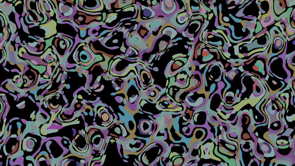

I just tried an orthographic camera, and I get the same distortion results
(needing the same corrections as before.)
And just for fun, here's the same scene + orthographic camera, but using the
bumps pattern for the normal.
Sophisticated art! :-P

If this was to be added to that section of the docs (by some superior autority
than me), how would you rephrase all of this in the most concise simplified
caveat warning apposition to fit in ? maybe something like :
"All camera rays will be perturbed using this one unit sized pattern. "
From: Kenneth
Date: 8 Jan 2022 15:15:00
Message: <web.61d9f068ac36aa6b4cef624e6e066e29@news.povray.org>
"Mr" <m******r******at_hotmail_dot_fr> wrote:
> If this was to be added to that section of the docs (by some superior authority
> "All camera rays will be perturbed using this one-unit sized pattern. "
Maybe something like this (or to add to your statement)?
"When used in a camera, the normal pattern will be distorted horizontally,
depending on your render's aspect ratio. To correct for this, an inverse-scaling
of the normal is required in x. For example:
scale <image_height/image_width, 1  1>"
> [Thanks, Thomas]
Finally, before we consider documenting it like that, could maybe some developer
confirm that this is really the intended behaviour and not a bug ? Thanks.
