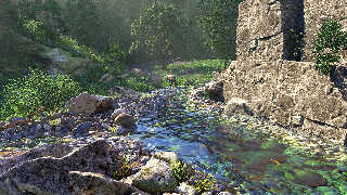

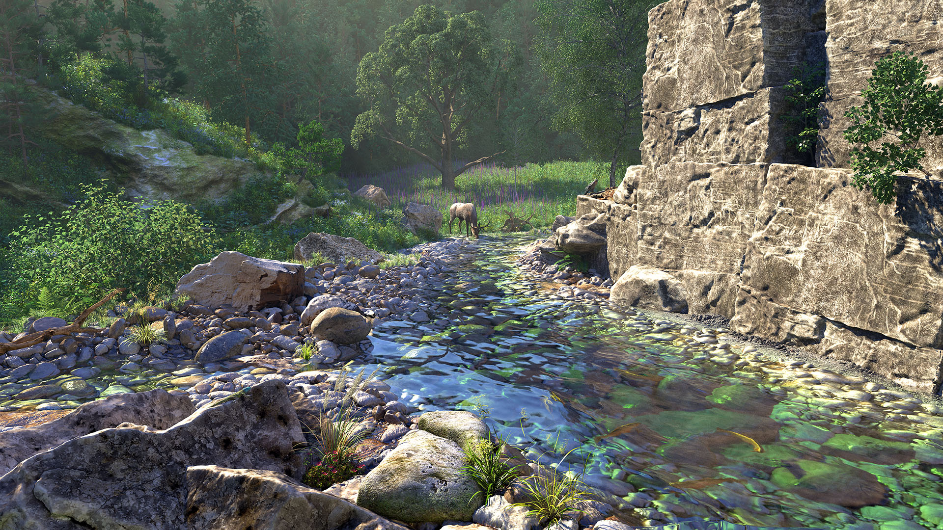

Hi,
when I was young I hiked in the mountains (austria I believe) and found a nice
spot with a small creek. I remember this place fairly well.
Here is an adaptation - as in my last images I used a large amount of different
meshes (> 110), resulting in a memory usage of more than 22 GB.
Happy rendering,
Norbert Kern
Download 'mountain_forest.jpg' (840 KB)
Preview of image 'mountain_forest.jpg'

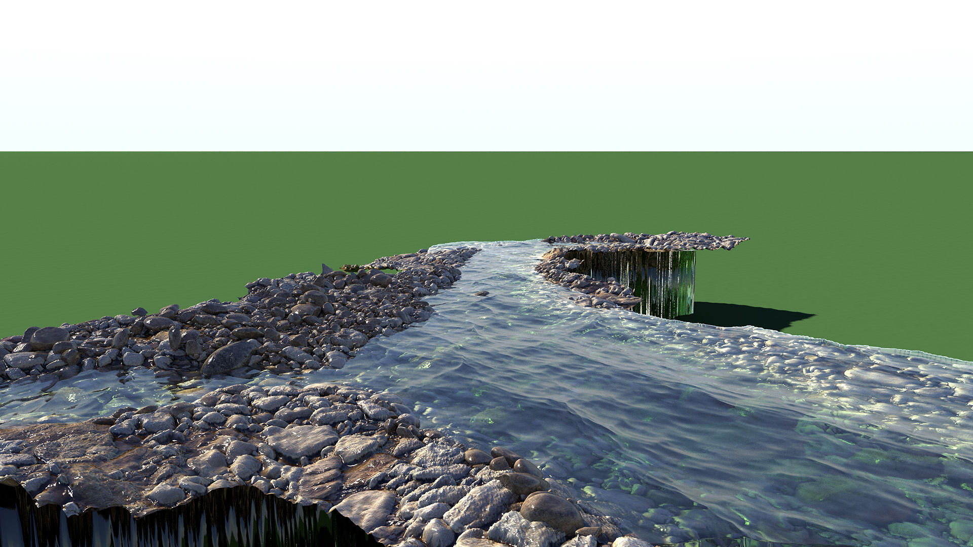

Thanks Thomas,
water is a mesh indeed, but it doesn't look very special. I think a heightfield
made with an averaged wrinkles / rigded_mf pattern could do it too.
The water material is simple -
texture {
        pigment {color rgbt <0.25,0.35,0.2,1>}
        normal {
                average
                normal_map {
                        [1      wrinkles 0.04 scale 50]
                        [1      granite 0.01 scale 0.5]
                        [1      bumps 0.14 warp {turbulence 1} scale 0.03]
                        [1      bumps 0.1 warp {turbulence 0.5} scale 0.0003]
        finish {
                ambient 0
                diffuse 0.3
                reflection {0.03, 1 fresnel on metallic 0.3}
                specular 5
                roughness 0.003
interior {
        ior 1.33
        caustics 2
        fade_distance 0.4
        fade_power 1001
        fade_color <0.5,0.7,0.4>
Starting point of the image was a 76 MB obj file with stones and water.
I split it in 7 parts and used the displacement function of Poseray. In the end
I had 7 large meshes (> 1.1 GB in sum).
Norbert

I notice that you use /some/ color in the rgbt of the water, despite a
transmit of 1. Personally, I have not noticed this approach did add
anything (I may be wrong) and simply use  rgbt 1, in general. Using
'filter' would be a different matter of course.
Very good. I am increasingly using the displacement function of Poseray.
It does not get all the attention that it merits.
I am lazy sometimes - here I started with a transmit value of 0.85 and it ended
as 1 after some trials. For a reason I don't remember I set reflection with
metallic 0.3, so the color isn't completely useless.
That's totally true!
Norbert
