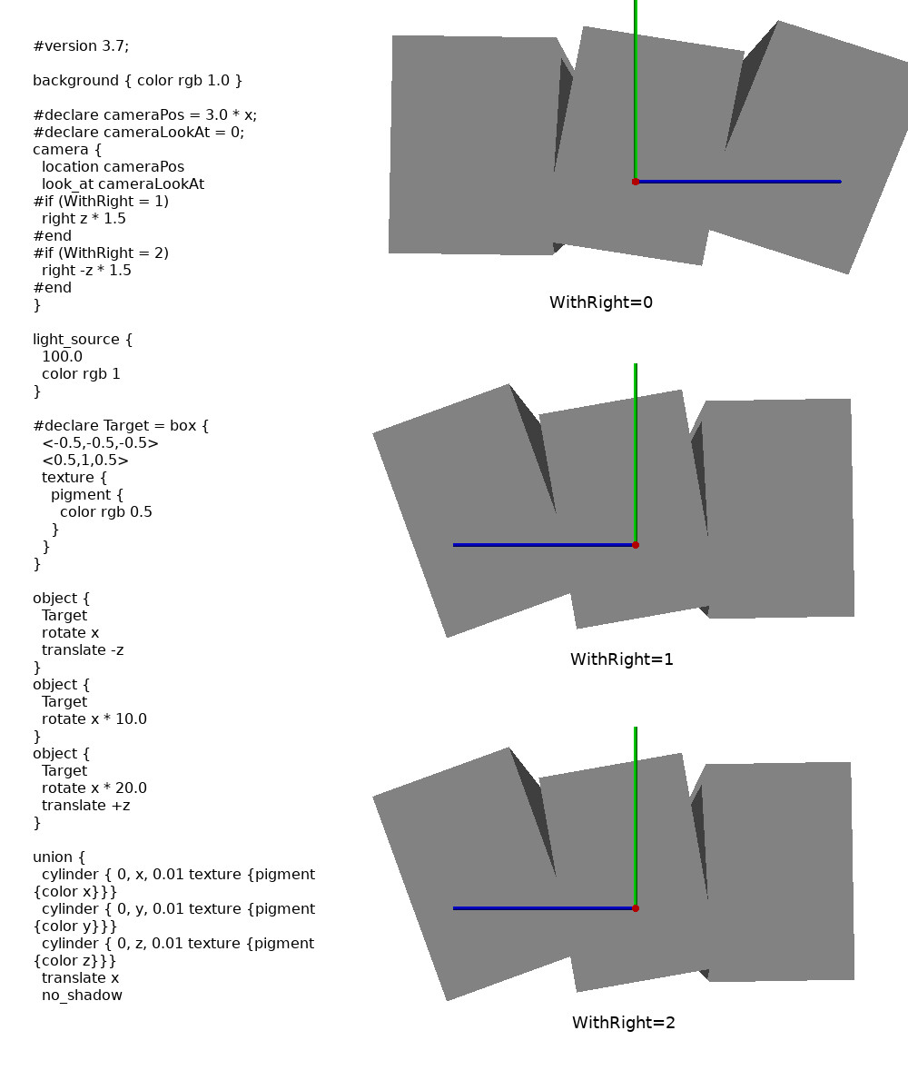

Hi everyone,
Could someone help me understand what's happening in the image attached please ?
I have a camera on the +x axis looking at the origin and a box rotating around
the x axis.
With the default camera (WithRight=0), I obtain what I'm expecting. The +z axis
is toward the right of the image and the box rotates clockwise.
Now if I specify explicitly the right vector of the camera to be like in the
first image toward the +z axis  (WithRight=1), the +z axis is now toward the
left of the image, and the box rotates counter clocwise, but +x still points
toward the camera. I would expect to have the same image as (WithRight=0).
Also, if I set the right vector to -z (WithRight=2), I obtain the same image as
with +z, which is puzzling me, as I would expect it to invert the handedness of
the axes.
Reading the documentation:
http://wiki.povray.org/content/Reference:Camera#Up_and_Right_Vectors
doesn't help me understanding what I'm getting wrong. Could someone help me ?
I paste the code below if you want to try it.

It seems that you have not explicitly added a 'direction' vector. By
default, it is <0,0,1> where the camera location is pointing along the
z-axis by default. However, as your camera is pointing towards -x, the
default direction may have put you in trouble. Try: direction <-1,0,0>
When using non-standard camera settings, do not rely (too much) on the
default values!

Thanks a million Thomas!
Specifying the 'direction' vector as you suggested solved my problem. I was
thinking it's automatically calculated based on the 'location' and 'look_at'
vectors.
Thanks again :-)

I have become attentive to the 'handedness' of external cameras vs
POV-Ray (left-handed classic), with the use of Moray (right-handed, but
different) and Silo (right-handed classic).
