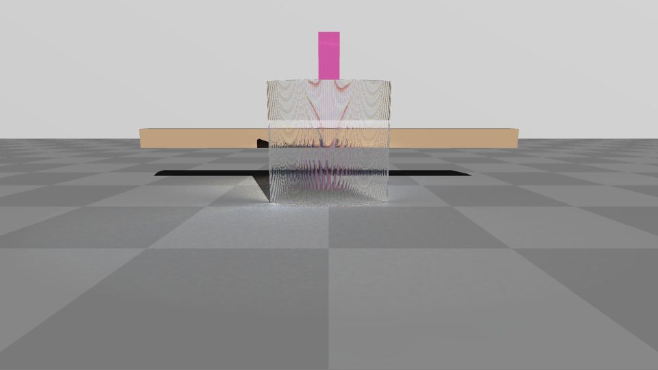

Hi Folks,
After watching this video https://www.youtube.com/watch?v=G93bju1qCSI I
endeavored to make a POV version and it worked fairly well.
Here's a front view:
Download 'invisibilityshield_front.jpg' (22 KB)
Preview of image 'invisibilityshield_front.jpg'

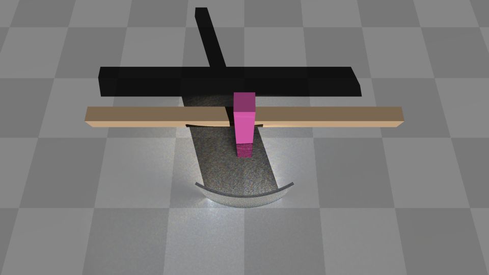

And a top view:
Download 'invisibilityshield_top.jpg' (23 KB)
Preview of image 'invisibilityshield_top.jpg'

So the effect even works in POV-ray; fascinating.
For your shield, are the 'lenticular lens' shapes made with real geometry, or by
using normals on a smooth curved surface?
From: Dave Blandston
Subject: Re: Invisibility Shield
Date: 25 Nov 2020 15:30:07
Message: <web.5fbebe9b3ff595d979416a1f0@news.povray.org>
I used a CSG difference so there wouldn't be any internal or coincident
surfaces. I don't know if that would have made a difference or not.

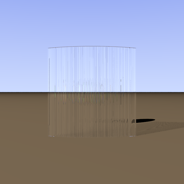

Perfect!
[Whaaaaa....! Who stole my ball....??!?]
Download 'db_invisibility_shield.png' (87 KB)
Preview of image 'db_invisibility_shield.png'

Fantastic - did you use normals to simulate the lenses? Using geometry might be
a limitation because of the huge number of required lenses. Also, did you change
the shape of the shield from circular to oval or parabolic? I'm wondering if
that would make a difference.
Have a great day!
Kind regards,
Dave Blandston
Date: 27 Nov 2020 02:31:03
Message: <5fc0ab37@news.povray.org>
Op 26/11/2020 om 10:35 schreef Dave Blandston:
I just used your code 'as is'. :-)
