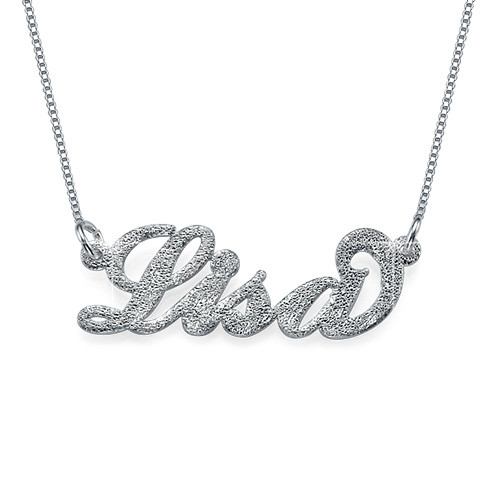

Hello guys!
Can any of you tell me how to get this effect on flat surfaces?
Thanks a lot!

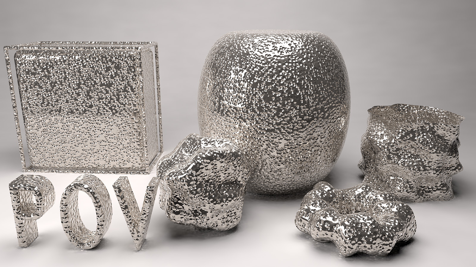

From: Norbert Kern
Subject: Re: Diamanted finish on metallic surface
Date: 2 Mar 2018 16:50:01
Message: <web.5a99c68d33da56ce452216fa0@news.povray.org>
"Havana7" <nomail@nomail> wrote:
> Hello guys!
> Thanks a lot!
Here is an approach on such a material. Properly scaled it should do the job.
Source is here:
http://news.povray.org/povray.binaries.scene-files/thread/%3Cweb.5a99c42214559746452216fa0%40news.povray.org%3E/
Norbert
Download 'diamanted finish on metallic surface.jpg' (599 KB)
Preview of image 'diamanted finish on metallic surface.jpg'

Sorry to bring this old post up again. I'm just updating my collection
of example scenes I neglected since the end of 2017 now and stumbled
about this one. As all I can see, Norbert did a very good job at
answering the question of Havana7 and by resembling the image given. I
assume the image of the necklace posted by Havana7 is a photography and
I wondered how this necklace was crafted originally. Has onyone an idea?
The only technique I found so far giving similar but not equal results
is sand casting.
