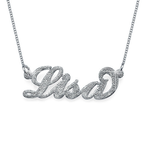

Hello guys!
Can any of you tell me how to get this effect on flat surfaces?
Thanks a lot!

Hi and welcome.
For a flat surface you would use a normal to give the impression of
depth. Try bumps.
If you have a photograph that you want to use. You could use it as a
heightfield. Which would turn it into an actual 3D object. Where the
light colours are high and the dark colours are deep.

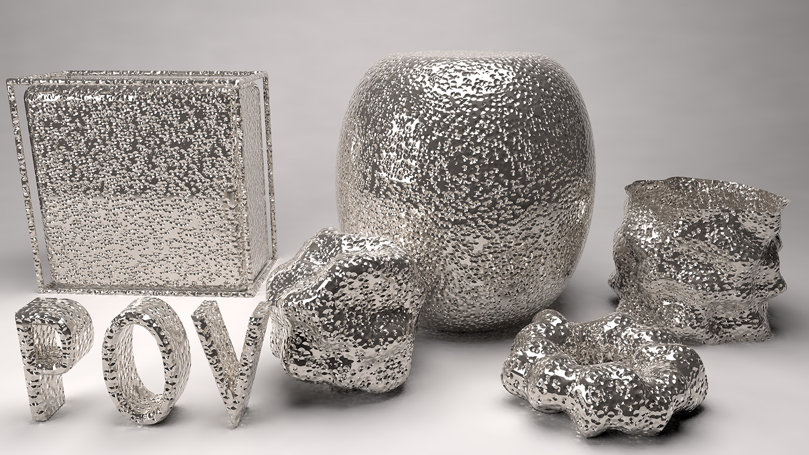

Here is an approach on such a material. Properly scaled it should do the job.
Source is here:
http://news.povray.org/povray.binaries.scene-files/thread/%3Cweb.5a99c42214559746452216fa0%40news.povray.org%3E/
Norbert

You may try something like :
normals{crackle -1 scale Your_Scale}
The -1 is to make it so that the normally high points become pits.
Adjust the normal depth and scalling to your taste.
