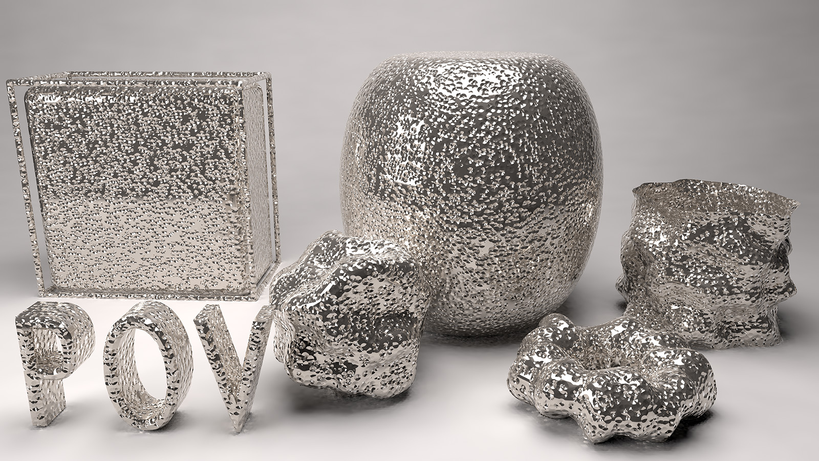

Here is an approach on such a material. Properly scaled it should do the job.
Source is here:
http://news.povray.org/povray.binaries.scene-files/thread/%3Cweb.5a99c42214559746452216fa0%40news.povray.org%3E/
Norbert
Download 'diamanted finish on metallic surface.jpg' (599 KB)
Preview of image 'diamanted finish on metallic surface.jpg'

You may try something like :
normals{crackle -1 scale Your_Scale}
The -1 is to make it so that the normally high points become pits.
Adjust the normal depth and scalling to your taste.
