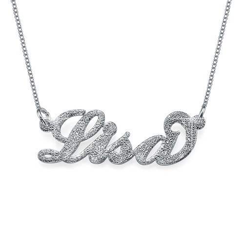

Hello guys!
Can any of you tell me how to get this effect on flat surfaces?
Thanks a lot!

From: Stephen
Subject: Re: Diamanted finish on metallic surface
Date: 2 Mar 2018 08:22:41
Message: <5a995021$1@news.povray.org>
On 02/03/2018 12:23, Havana7 wrote:
> Hello guys!
> Thanks a lot!
Hi and welcome.
For a flat surface you would use a normal to give the impression of
depth. Try bumps.
If you have a photograph that you want to use. You could use it as a
heightfield. Which would turn it into an actual 3D object. Where the
light colours are high and the dark colours are deep.
Regards
     Stephen

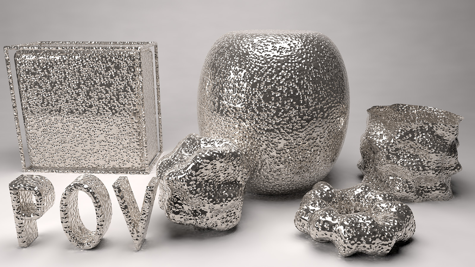

From: Norbert Kern
Date: 2 Mar 2018 16:50:01
Message: <web.5a99c68d33da56ce452216fa0@news.povray.org>
"Havana7" <nomail@nomail> wrote:
> Hello guys!
> Thanks a lot!
Here is an approach on such a material. Properly scaled it should do the job.
Source is here:
http://news.povray.org/povray.binaries.scene-files/thread/%3Cweb.5a99c42214559746452216fa0%40news.povray.org%3E/
Norbert
Download 'diamanted finish on metallic surface.jpg' (599 KB)
Preview of image 'diamanted finish on metallic surface.jpg'
Date: 3 Mar 2018 15:28:28
Message: <5a9b056c@news.povray.org>
> Hello guys!
> Thanks a lot!
You may try something like :
normals{crackle -1 scale Your_Scale}
The -1 is to make it so that the normally high points become pits.
Adjust the normal depth and scalling to your taste.
From: MichaelJF
Date: 27 Dec 2021 13:24:36
Message: <61ca04e4$1@news.povray.org>
Am 02.03.2018 um 22:47 schrieb Norbert Kern:
>> Hello guys!
>> Thanks a lot!
> Source is here:
> Norbert
Sorry to bring this old post up again. I'm just updating my collection
of example scenes I neglected since the end of 2017 now and stumbled
about this one. As all I can see, Norbert did a very good job at
answering the question of Havana7 and by resembling the image given. I
assume the image of the necklace posted by Havana7 is a photography and
I wondered how this necklace was crafted originally. Has onyone an idea?
The only technique I found so far giving similar but not equal results
is sand casting.
Best regards,
Michael
