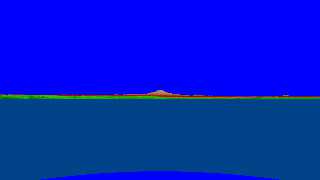

Here is the suspicious Image (see bugreports)
Best regards,
Michael

I read your message and I am almost sure this is an epsilon problem,
same as when Bill Pragnell and me, and others, modelled the Ringworld a
couple of years ago. For the POV version then in use, an unofficial
patch was issued, but the problem appeared again with the 3.7 version
and, as far as I know, has not been corrected. It is a simple matter of
a more accurate epsilon value. Strictly speaking this is not a bug and
you can try to avoid the problem by scaling down the HF and elevate the
camera a bit more until it disappears. Personally I feel that as an
inelegant solution though, and I would much prefer an appropriate
epsilon value.

Thanks Thomas, that explains the effect. But it means 0.00003 < epsilon. I had
assumed it smaller. The actual value seems to be ok for most scenes. A smaller
value might result in a severe prolongation of the render times. Best would be
an option within the global settings.
Best regards,
Michael

For most scenes indeed, there is no problem. A global settings option
would be a good alternative.
I third this suggestion.
Added Flyspray #297.
Thank you both, I added it to the wish list at the POV 4 discussion.
Best regards,
Michael
