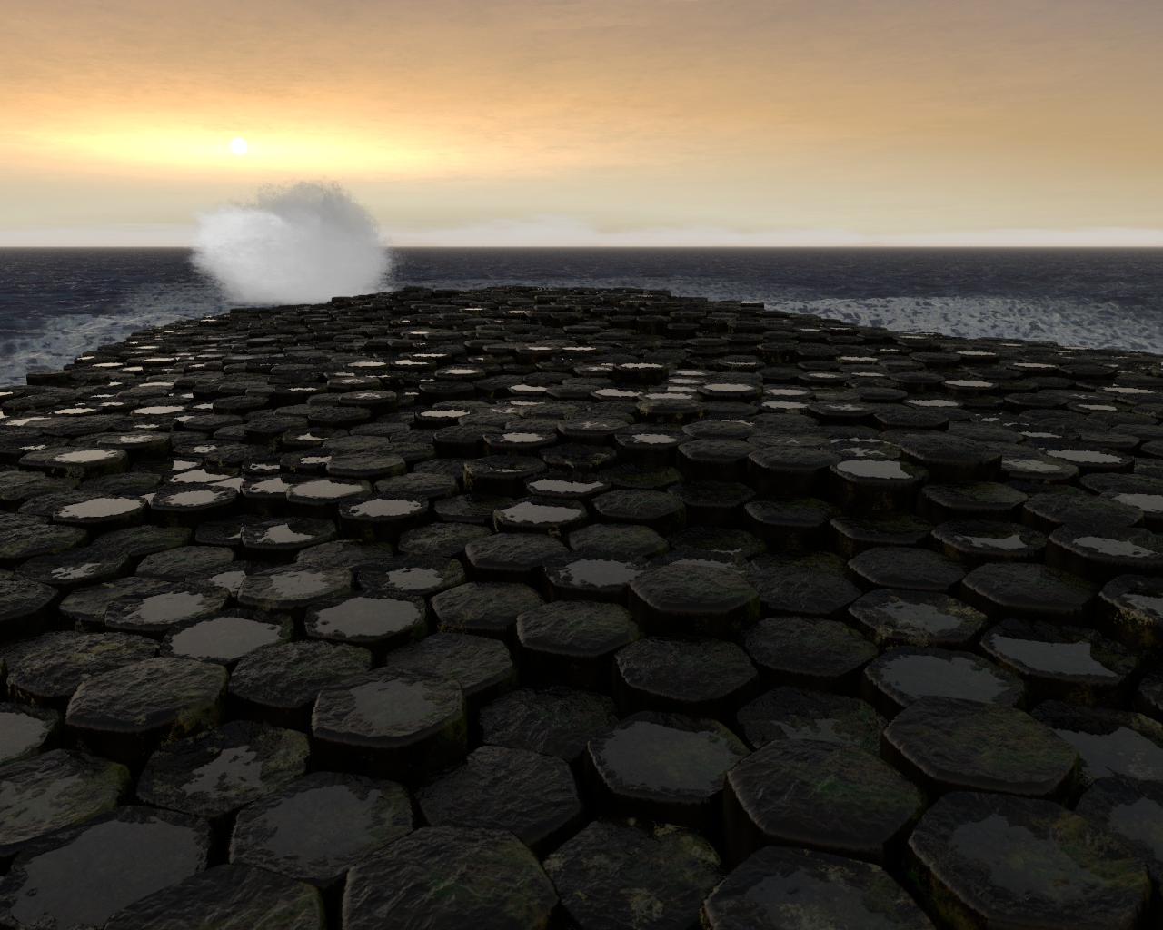

Working on an entry for tc-rtc, I am not entirely pleased at the moment
(although not sure how to improve the image).
I think I am just not totally happy with most things..
The breaking wave (media) is not really how I would like it but am not sure how
to improve it.
The columns would ideally be more random in shape (not a problem) but if I make
them more random in shape I then cannot get them to stack together close enough
to make them realistic. The compromise is these rather too uniform columns.
For some reason my texture applied to the sea to provide the breaking/foam near
the rocks does not blend/fade very well in the z direction, it seems to just
stop (maybe at the intersections of each height field). I expect I am doing
something wrong here but have not tracked down the issue yet.
The sky is not how I want it yet but again am struggling, may have to switch to
media clouds I guess instead of stacked planes..
Sean
Download 'giants_causeway.jpg' (555 KB)
Preview of image 'giants_causeway.jpg'
It is a good start, though.
> to improve it.
The most obvious problem I guess, is that it looks like a freak event.
Not that the sea seems calm (good waves by the way) but that the wave
height seems not high/strong enough for that kind of braking. The media
looks good, maybe not too realistic for this kind of thing but close.
You may need to experiment with different density patterns perhaps. How
about marble or agate?
In terms of size, the Giant's Causeway in Ireland shows rather uniform
columns. It is indeed the shape that varies more although not too
randomly. If you could squeeze in a few irregular hexagons or even
parallelepipeds, that would probably be enough.
Also, randomize more the /sides/ of the /causeway/  :-)
Not too obvious, but now you mentioned it...
I like this though.
Thanks Thomas, I did not realise you could layer density maps in this way, this
is helping with the breaking wave, just need to sort out all the other issues
now.
Sean

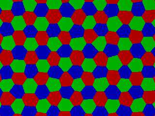

Since you want to basaltic columns, if you want to randomize them a bit more,
you probably still want a general six-sidded shape.
One way you can do this is:
1. Generate a hexagonal array of points at the average offset/size you want
2. Apply a random small x and y offset to each
3. creat prisms based on a voronoi tesselation of the points
- for each point, find the distance and direction to each of its 6 neighbours
- for each of these pairs, create a plane at the exact midpoint, and
perpendicular to the direction vector
- you will have 6 vertical planes for each point, create a CSG intersection of
the 6 planes (plus a top height plane).
- this should result in having a six sided array with no gaps, bu the hexagons
won't be perfect hexagons
The next difficult step is determining hor to make rounded or chamfered edges to
these shapes if you want.
The attached image shows the general result, though I didn't do the full steps
above, I just creeated an array of spheres based on steps 1 and 2 above with no
CSG, which gives the same visual effect viewed from above.
Download 'blocks.png' (50 KB)
Preview of image 'blocks.png'

On Wed, 05 Jun 2013 12:50:09 +0200, s.day <s.d### [at] uelacuk> wrote:
Your textures and puddles look so good, one doesn't notice them - which
means it looks very realsitic imho :)
-Nekar Xenos-
Well from looking at images some are less but I think that would just over
complicate things so six sides are fine ;-)
Hmm, not sure if my math skills are up to this, I am sure it is not that
complicated but I never paid enough attention in this subject, if only they had
used POV back then to make it more interesting..
The current columns are made from intersecting 7 height fields (one for the top)
so similar to what you are referring to above with planes but with the obvious
advantages. I am rounding/beveling the edges by combining the granite/wrinkles
pigments with a gradient pattern to raise the edges of the hieght fields then
sizing them appropriately so the raised edges meet up. The top one has a granite
and sperical pattern to get the raised or sunk look for the puddles.
I will have to have a go at this but fear it may take me the 70 odd days to the
deadline to work it out ;-)
Thanks
Sean

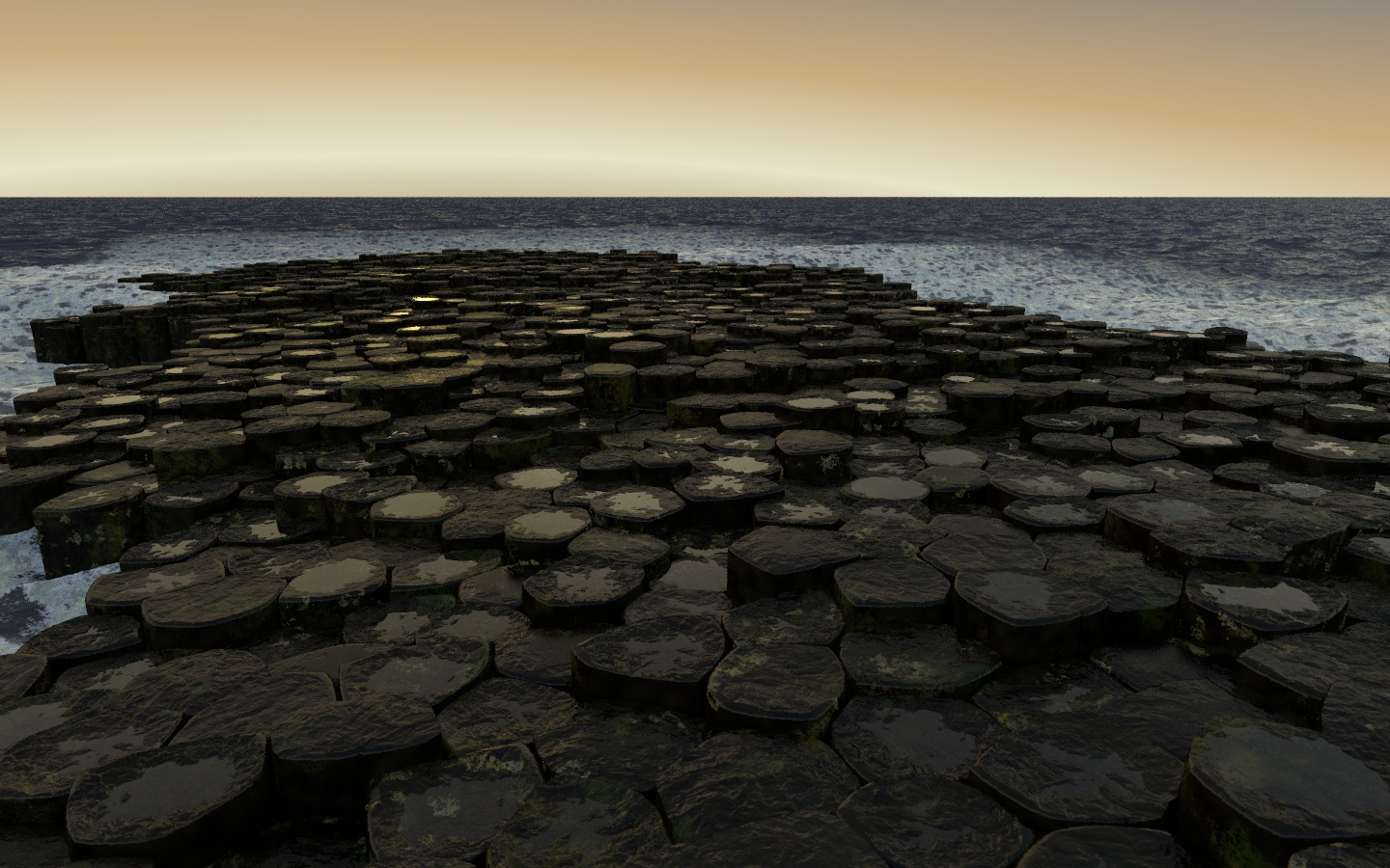

Try adding a small random component to the rotation of each plane.
For instance if you have the following:
plane{z, 0 rotate y*60}
first declare a seed
#declare RandSeed=97531;
change your plane as follows
plane{z, 0 rotate y*(60+5*rand(RandSeed))
-Nekar Xenos-
From: s day
Subject: Re: basaltic columns
Date: 9 Jun 2013 10:00:02
Message: <web.51b48a1ae9c4aeffe52a27db0@news.povray.org>
Don't think I am fully using the technique mentioned above but it got me far
enough to randomise the shapes as in the attached. Also took the hint from
Thomas to change the edges of causeway to make it less even.
I did not add the clouds/sun/fog etc in this image it was just to check the
shape of the causeway and columns. Still more work to do but I am much happier
with this part of the scene.
Thanks
Sean
Download 'giants_new_shape.jpg' (640 KB)
Preview of image 'giants_new_shape.jpg'
Date: 9 Jun 2013 10:36:57
Message: <51b49309$1@news.povray.org>
Oooh! Looking awfully good!
