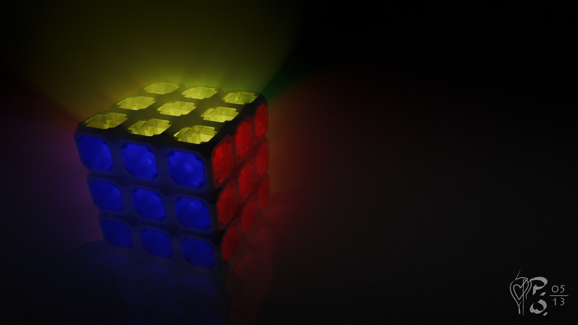

Hi,
I was using PovRay for two 3d-wallpapers for now. Everthing is scripted (i don't
like the idea of using pov-ray with models) -- but sadly i had to post-process
the last one a little.
So .. in the one i uploaded, i had a problem with the reflection .. which is the
reason, i had to post-process it (blur the reflection; and then also add grain,
to make the editing less visible -- i didn't like to do that, but i didn't like
to rerender it either). The problem was, that the volume-light isn't reflected.
I used media and a reflective plane:
media {
    scattering { 1, 0.1 }
    intervals 30
    samples   10,40
    method    1
    variance   0.5/128
    confidence 0.95
plane {
    <0, 1, 0> (-3)
    pigment { color rgbf <1.0, 1.0, 1.0, 0.0> }
    finish { reflection 0.3}
so .. for future-images: Is there a way to achieve that?
Download 'rubiks_cube_1920x1080_compressed.jpg' (288 KB)
Preview of image 'rubiks_cube_1920x1080_compressed.jpg'

Is the present image the post-processed one? I do not see the problem
you describe (might be me, though). This looks fine by me...

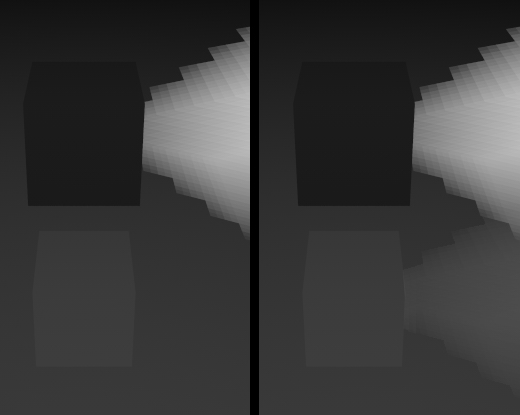

Thanks for the advice for using media -- I'll certainly take this into account
in my next image. (I'm really grateful, if this reduces my render-time a little)
I fear, I described the problem of the reflection wrong .. the problem wasn't,
that the reflection was blurred, neither, that i wanted it to be blurred.
The problem was, that the media wasn't reflected. (I blurred it to avoid, that
this problem attracted too much attention.)
I attached a small image, which i hope describes the problem better. On the left
is the image, PovRay rendered .. and on the right is, what I think, the Image
should look like. Propably I just didn't set some value the right way -- or have
some error in my understanding of the reflection of light.
(I get the feeling, this isn't the right place to ask questions -- more like, to
show images -- so ... sorry if i use this to get this question answered)
Download 'reflection.jpg' (48 KB)
Preview of image 'reflection.jpg'

Not realy "reflection of light" but rather reflection of illuminated or
emissive media.
It's OK to ask question relative to an image.
There may be a problem if your media container is much to large or there
is no container at all.
Try enclosing your cube inside a box about 2 to 5 times larger. It need
to be as small as possible while containing all the visible media.
Make is "hollow" with "pigment{rgbt 1}".
The goal is to prevent any ray to extend to infinity while traveling in
the media: Reatching the background. When this appen, there is no way to
acurately evaluate the effect of the media.
It's also possible that your reflection is set to low. Try "reflection
0.5" and see if it's beter.
Check your max_trace_level. If the post render message say something
like 5/5, it's probable that your rays are going through to many
reflection or transparences with reflection, refraction, or objects with
an interior block.
Just a test, try adding max_trace_level 255 in your global_settings block.

Ahh, this did the trick. I thought, reasonably enclosing the media element was
only for minimizing the render-time. As I were in no hurry, I just didn't use a
media container at all -- nice to know, that there are other purposes of that
one.
You were a great help, thank you very much.
