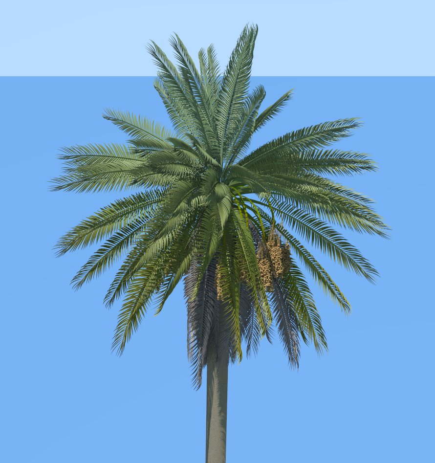

looking for some feed back on a date palm macro I'm working on.
-all csg with a sphere sweep for the trunk.
-manual bounding of branches and leaves gave a 350% speed increase.
-short stubby to tall and thin trees can be made.
-change random seed for a complete new tree.
-random noise in scaling and 3 axis rotation of each leaf gives nice realism
close up.
-texture is added to each branch during placement and changes depending upon
elevation. - they get older the lower they are.
-used a tan() in vertical rotation so majority of branches are out to the side
and fewer point up or down.
-various randomness throughout for realism (I hope)
for example in branch placement:
    rotate (.5-rand(Rn))*B*z
    rotate <tan(1.16-Sx*2.32)*39+5, 0, (.5-rand(Rn))*20>
    translate <0, (Sx-.4)*1.25+H+.4, min(1,1.4-Sx)*W/.8>
    rotate rand(Rn)*360*y
trees as rendered called with below settings
// scale, rotate, trans, height, trnk width, trnk crv amt, num of palms, palm
twist base, palm twist increment, dead hangers, num of dates, rnd seed
palmtree1(1,<0, 50, 0>,<48, -.3, 80>,30,.5,1.5,70,25,5,7,14,24)
palmtree1(.8,<0, -170, 0>,<43, -.3, 84>,29,.6,5,55,30,6,0,10,410)
image is just a small clipping of the tree from a larger image.
med. radiosity and AA so quality can go way up.
will be adding SSLT support for the textures and custom textures.
will post macro with instructions later.
feed back please, good and bad, thanks.
Download 'palm.png' (170 KB)
Preview of image 'palm.png'

From: OJD
Subject: Re: Date Palm
Date: 17 May 2013 20:15:01
Message: <web.5196c7b33578efe84b64393e0@news.povray.org>
"Kenneth" <kdw### [at] gmailcom> wrote:
> Wow! That's interesting to know. I don't understand how or why it works, though.
> I would assume that auto-bounding would give the best speed(?) unless there are
> difference/merge CSG objects present.
the leaf is made from a difference of a sphere and 2 cylinders giving a curved
slice of the top of the sphere. then it is differenced from itself scaled
slightly larger. this gives a nice curved 'V' shaped leaf.
now the thin slice left after the initial difference is much smaller than the
auto bounding boxes created as they want to cover all the objects in the
difference. compound this with using the shape many times in close proximity
causes many overlapping bounding boxes with the majority of the intersection
tests failing (only about .04% succed)]
after manual bounding, the intersection test success ratio goes way up with a
much smaller number of tests performed.
here is a test image from earlier stage of development.
 the twisting is a bit radical... lol
 many changes were made since this render:
- textures are better
- branch tips are better. filled in the empty v shape.
- leaf was redone
- elevations of branches are much more realistic by adding the tan()
- branches near the top are shorter than the side branches
but this gives you a better view of the thing.
renderer is busy with a long test but will get an updated version rendered in a
day or so.
Download 'palm2.png' (676 KB)
Preview of image 'palm2.png'

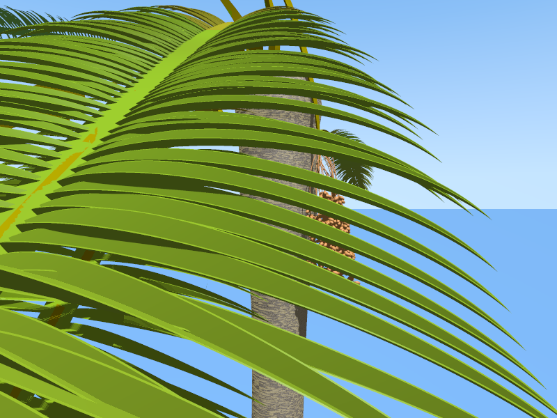

hear is a low quality render early in development showing a close up of the leaf
shape.
 noise in the rotation of each leaf adds a lot to simulate real world palms.
     rotate (rand(Rn)*1.2-5-XX)*9*y
     rotate ((XX+4)*I+B+((rand(Rn)-.4)*4-XX*5))*z
 branch is actually 2 of the leaf sections added end to end without the v
cutout.
 leafs follow the branch with a sin() function
    translate <-.01, sin(pi/2-XX/5.6)-.03, XX>
.... ignore the stuff behind the leafs... lol

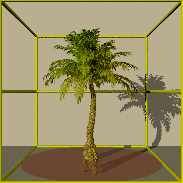

Date: 18 May 2013 03:14:47
Message: <51972a67@news.povray.org>
The tree is looking really good indeed. Excellent work.
Do you know the palm tree made by POV-Tree (Gena Obukov's java version
of Tom-tree, by Tom Aust)? This is how it looks as CSG output.
Download 'povtree_test.png' (188 KB)
Preview of image 'povtree_test.png'
