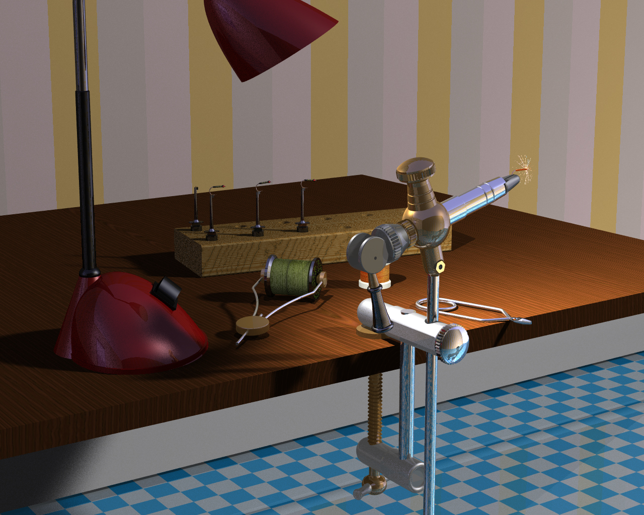

My second CSG scene, 'The Spider'. For the uninitiated, the fly in the vice is a
spider.
I cheated with the clamp thread - it is as array of cone intersections, not a
spiral. I figured how to pur a spiral together for the gold rib on the little
buzzers in the clips, though they are too far back to see it, and I figured how
to randomize the position of the fibres of the spider. I haven't but the spiral
wrapping on the flexi part of the lamp support yet. I can do an isosurface
spiral but have not yet figured how to push it inot a torus shape instead of a
cylinder.
Download 'thespider.jpg' (1033 KB)
Preview of image 'thespider.jpg'
> spider.
> cylinder.
Nice job on the cotton reel textures.
Sean

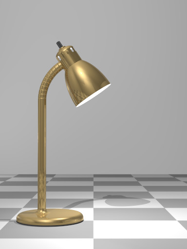

> cylinder.
I cheated and used a normal with a radial pattern.
Download 'show_lamp_flex.jpg' (19 KB)
Preview of image 'show_lamp_flex.jpg'

That's an interesting table-clamp device, holding the fly-making thingy. It is a
real-world clamp?
Looks good to me. How did you get it to curl, to follow the bend?
Subject: Re: Another CSG scene
Date: 28 Apr 2013 16:42:03
Message: <517d899b$1@news.povray.org>
The axis of the radial pattern matches the center of curvature of the bend.
> > spider.
> I must be quite uninitiated; it took me quite a few minutes of staring back and
> forth between your text and your image before it dawned on me what you were
> talking about.  It's something to do with fishing, isn't it?
> > cylinder.
This render looks better than your full-scene render. The lamp is nice and a fly
would be a fun thing to model. Have you considered scaling back and doing a
better render of just one object?
