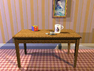

My first reasonably successful CSG scene.
The table is a good reproduction of one that I carved many years ago. The
carving did take longer than working out this code.
Download 'thepill1.jpg' (419 KB)
Preview of image 'thepill1.jpg'
Compared with my own 'first', this is indeed good looking. My only
comment would be about the wood texture. On the vertical part between
the legs, I would rotate the texture by 90 degrees. The normals seem a
bit too strong imho.
Nice carving and well done as code too.
Yes, I didn't notice that was the wrong way round. I will correct it.
I took the wood from "woods.inc" but found the colours too dark and red, so
changed them. The result is a good match to my clear-varnished oak tables.

Nice work! I don't remember my own first 'reasonably good' CSG scene, but it
certainly wasn't as well-done as this.
That Rubik's Cube is quite funny--only one little cube to go, but...no luck. ;-)
My own 2-cent's worth: Make the lights into area_lights, to add a bit more
realism.
From: Bernard

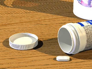

Just before I move on to my next, here is a close-up. It occurs to me that there
is no point in modelling more detail than can be seen at the intended field of
view - if, of course, there is an intended field.
Download 'thepill3.jpg' (320 KB)
Preview of image 'thepill3.jpg'

On 15-4-2013 12:00, Bernard wrote:
>> realism.
>   I am struggling with the lighting. Will keep your comment in mind.
And this is of great detail indeed. Good work on the container!
