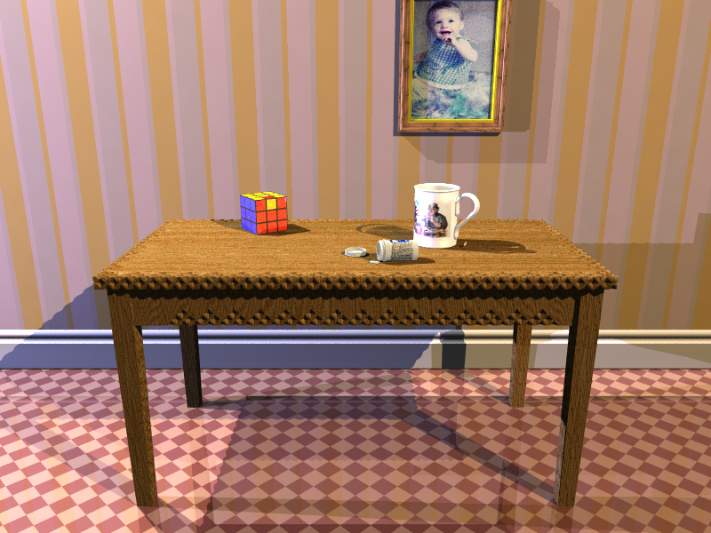

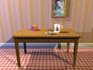

My first reasonably successful CSG scene.
The table is a good reproduction of one that I carved many years ago. The
carving did take longer than working out this code.
Download 'thepill1.jpg' (419 KB)
Preview of image 'thepill1.jpg'
From: clipka
Subject: Re: The Pill
Date: 13 Apr 2013 13:29:27
Message: <516995f7$1@news.povray.org>
Am 13.04.2013 17:02, schrieb Bernard:
Yeah, real life would be a lot easier if it had macros and loops :-)
Date: 14 Apr 2013 03:00:13
Message: <516a53fd$1@news.povray.org>
Compared with my own 'first', this is indeed good looking. My only
comment would be about the wood texture. On the vertical part between
the legs, I would rotate the texture by 90 degrees. The normals seem a
bit too strong imho.
Nice carving and well done as code too.
From: Bernard
Date: 14 Apr 2013 05:05:01
Message: <web.516a70e386bc1052ebe52e8a0@news.povray.org>
Yes, I didn't notice that was the wrong way round. I will correct it.
I took the wood from "woods.inc" but found the colours too dark and red, so
changed them. The result is a good match to my clear-varnished oak tables.

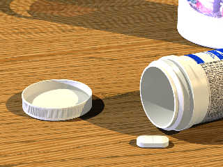

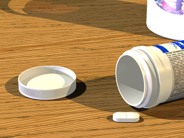

From: Kenneth
Date: 15 Apr 2013 01:30:03
Message: <web.516b8ff086bc1052c2d977c20@news.povray.org>
Nice work! I don't remember my own first 'reasonably good' CSG scene, but it
certainly wasn't as well-done as this.
That Rubik's Cube is quite funny--only one little cube to go, but...no luck. ;-)
My own 2-cent's worth: Make the lights into area_lights, to add a bit more
realism.
From: Bernard
Date: 15 Apr 2013 06:05:02
Message: <web.516bcfdb86bc1052ca8d115e0@news.povray.org>
> realism.
 I am struggling with the lighting. Will keep your comment in mind.
Just before I move on to my next, here is a close-up. It occurs to me that there
is no point in modelling more detail than can be seen at the intended field of
view - if, of course, there is an intended field.
Download 'thepill3.jpg' (320 KB)
Preview of image 'thepill3.jpg'
Date: 15 Apr 2013 07:12:27
Message: <516be09b$1@news.povray.org>
>> realism.
And this is of great detail indeed. Good work on the container!
