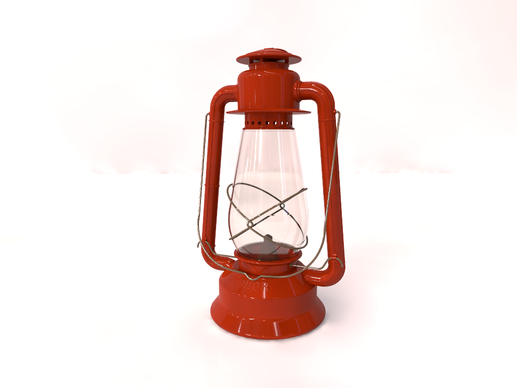

Hi,
I am trying out some HRD renders in Pov 3.7 RC7 and having some difficulty
finding good settings. After a lot of adjusting (mostly guesswork) I have the
following:
For Radiosity:
#default{ finish{ ambient 0 diffuse 1 conserve_energy }}
global_settings {
  radiosity {
    pretrace_start 0.08
    pretrace_end   0.01
    count 500
    nearest_count 10
    error_bound 2.5
    recursion_limit 4
    low_error_factor .5
    gray_threshold 0.0
    minimum_reuse 0.015
    brightness 0.3
    adc_bailout 0.01/2
For HDR sky_sphere:
sky_sphere {
  pigment{
    image_map{ hdr "galileo_probe.hdr"
               gamma 1.1
               map_type 1 interpolate 2}
emission rgb 0.6
rotate <0,40,0>
For finish on the main lantern (red painted finish):
finish {
specular 0.4
roughness 0.01
brilliance 2
diffuse 1
reflection 0.1
conserve_energy
This is probably the best of the renders I have done so far but I still find the
highlights to be too bright. Does anyone know of a good reference/tutorial on
these settings specific to POV?
Thanks
Sean
Download 'lantern.png' (410 KB)
Preview of image 'lantern.png'
From: clipka
Subject: Re: HDRI settings
Date: 7 Mar 2013 10:08:49
Message: <5138ad81$1@news.povray.org>
Am 07.03.2013 15:03, schrieb s.day:
> following:
I have made the experience that with 3.7 the most straightforward
settings also yield the most realistic results:
> global_settings {
"assumed_gamma 1.0" should go somewhere here.
>    radiosity {
>      pretrace_start 0.08
>      pretrace_end   0.01
That's a pretty low-quality pretrace. I'd suggest a lower pretrace_end.
Shouldn't affect the overall brightness though.
>      count 500
>      nearest_count 10
>      error_bound 2.5
I usually use a setting below 1.0, e.g. 0.8 or 0.5.
>      recursion_limit 4
Recursion limit 2 is usually enough.
>      low_error_factor .5
>      gray_threshold 0.0
>      minimum_reuse 0.015
>      brightness 0.3
Whoa - stop there! For realism, you /do/ want brightness 1.0 (*). This
will significantly boost the effective diffuse brightness of your
object, and may already be enough to fit the brightness of the
highlights, so that all you might need to do is reduce the overall
brightness of the scene (we'll come to that in a moment).
(* There are actually some situations where a /higher/ brightness
setting may give you more realistic results, but don't bother about them
for now.)
>      adc_bailout 0.01/2
> For HDR sky_sphere:
> sky_sphere {
>    pigment{
>                 gamma 1.1
That should be 1.0 - or left out entirely. If you're going for realism,
don't tinker with it unless you know exactly what you're doing there: If
the author of the light probe did his homework, then by default POV-Ray
3.7 will give you exactly the right thing.
> emission rgb 0.6
THIS is where you're doing your overall scene brightness tweaking.
> rotate <0,40,0>
> finish {
> specular 0.4
> roughness 0.01
As you have no conventional light sources (or do you?), you could just
as well set this to "specular 0.0".
> brilliance 2
Most diffuse surfaces have a brilliance quite close to 1.0. (Aside from
that, radiosity doesn't currently support brilliance settings other than
1.0 anyway.)
> diffuse 1
> reflection 0.1
Hold it right there again: What you're effectively saying here is that
100% of the incoming light is reflected diffusely, and another 10% is
reflected specularly, i.e. the object reflects a total of 110% of the
incoming light ;-)
A total reflection (diffuse + specular) of 80% is a lot more realistic.
By the way, when defining new materials it is good practice to use the
"albedo" keyword for all diffuse, specular and phong, as this allows to
employ a few rules that help you get realistic results (not only in
HDR-lit scenes):
   diffuse albedo D
   specular albedo S
   phong albedo P
   reflection { R fresnel }
For realism, you usually want D+R<1 and S+P<R, with S+P=R/2 being a good
guesstimate.
> conserve_energy
This setting has no effect unless you also use variable reflection, i.e.
either of:
   reflection { 0.0 0.1 }
   reflection { 0.0 0.1 fresnel }
   reflection { 0.1 fresnel }
Using fresnel is a good idea anyway, not only for transparent but also
for opaque materials, even if that may seem counter-intuitive: Real-life
materials /all/ have an ior, and follow the fresnel law when polished.
(ior 1.6 is a good bet for opaque materials.)

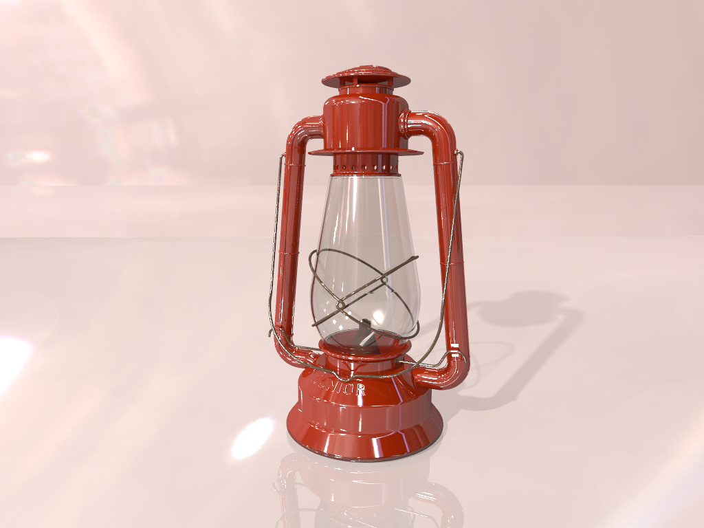

From: s day
Date: 7 Mar 2013 13:20:01
Message: <web.5138d979e61012b47a68f4440@news.povray.org>
Firstly thanks a lot clipka, a very thorough answer and well explained, I read
somewhere that for HDR diffuse should be set to 1 (hence my mistake), the rest I
think I changed so many settings that I just ended up totally confused.
I did add a light_source but only as the HDR image was not looking good so I
added a low level light source, I have removed that now though.
I also tried albedo but without the correct settings etc I don't think I would
have ever got a good render.
I initially set error_bound to 0.8 but had so many artifacts it looked like an
oil painting (an interesting effect but not what I was after). I just copied the
radiosity settings from an old image that did not use HDR then started
tweaking...
I had assumed_gamma in a separate global_settings section but other than that
being correct most other things were not so good ;-)
I have re-rendered with the following changes below:
pretrace_end 0.001 (don't know if this is too far, certainly slowed down the
pretrace step).
error_bound 0.8
recursion_limit 2
brightness 1.0
removed the gamma from the sky_sphere
left emission at rgb 0.6 // will try tweaking this though.
For the finish
set specular to 0
set brilliance to 1
changed the settings to diffuse albedo 0.6 reflection { 0.2 fresnel }
Two more questions though..
1) Is variable reflection advised for most objects, I have previously only used
this for glass/water?
2) Without specular does roughness have an effect on the surface?
As you can see your advice has helped a lot, this is much better than any of my
previous attempts.
Thanks
Sean
Download 'lantern_c.png' (225 KB)
Preview of image 'lantern_c.png'
From: s day
Date: 7 Mar 2013 13:25:02
Message: <web.5138da76e61012b47a68f4440@news.povray.org>
... forgot to mention, I also added an interior {ior 1.6} to the
texture/material.
Sean
From: clipka
Date: 7 Mar 2013 17:59:01
Message: <51391bb5$1@news.povray.org>
Am 07.03.2013 19:16, schrieb s.day:
> tweaking...
Good that you mention this, because I completely forgot about this problem:
Radiosity currently doesn't do a good job with HDR light probes having
rather small bright regions (e.g. direct sunlight). There are two ways
to approach this problem:
(A) Create a blurred version of the light probe using an external
program, and use this one for radiosity:
sphere { <0,0,0>, 10000 // or some other large value
   texture {
     pigment { image_map  {...} }
     finish { emission 1 diffuse 0 specular 0 }
   no_image
   no_reflection
For reflections and background, the classic sky_sphere will be visible.
(B) Crank up the radiosity "count" value like mad; setting
"nearest_count" to the maximum value of 20 should also help.
For realism, yes - variable reflection does improve the credibility of
any polished surface, and it doesn't slow down the render noticeably.
No; in radiosity-lit scenes, highlights will always be infinitely sharp
(unless you know how to achieve blurred reflections. There are ways, but
they come at a significant cost in render time; and even then the
blurriness will not be controlled by the roughness keyword.)
From: s day
Date: 7 Mar 2013 18:55:01
Message: <web.51392804e61012b47a68f4440@news.povray.org>
Thanks again, I am running another render with a higher count and nearest_count
set to 20 as there are a few artifacts still.
Also, I have tried a few different probes and all are much darker than the
galileo one I tried first, is it acceptable to increase emissions > 1 to
increase the light level or is there a better approach?
Thanks
Sean
