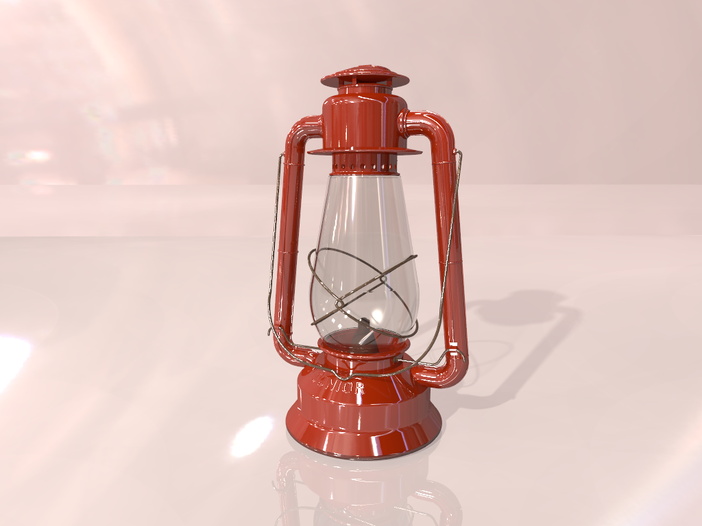

Hi,
I am trying out some HRD renders in Pov 3.7 RC7 and having some difficulty
finding good settings. After a lot of adjusting (mostly guesswork) I have the
following:
For Radiosity:
#default{ finish{ ambient 0 diffuse 1 conserve_energy }}
global_settings {
  radiosity {
    pretrace_start 0.08
    pretrace_end   0.01
    count 500
    nearest_count 10
    error_bound 2.5
    recursion_limit 4
    low_error_factor .5
    gray_threshold 0.0
    minimum_reuse 0.015
    brightness 0.3
    adc_bailout 0.01/2
For HDR sky_sphere:
sky_sphere {
  pigment{
    image_map{ hdr "galileo_probe.hdr"
               gamma 1.1
               map_type 1 interpolate 2}
emission rgb 0.6
rotate <0,40,0>
For finish on the main lantern (red painted finish):
finish {
specular 0.4
roughness 0.01
brilliance 2
diffuse 1
reflection 0.1
conserve_energy
This is probably the best of the renders I have done so far but I still find the
highlights to be too bright. Does anyone know of a good reference/tutorial on
these settings specific to POV?
Thanks
Sean
Download 'lantern.png' (410 KB)
Preview of image 'lantern.png'

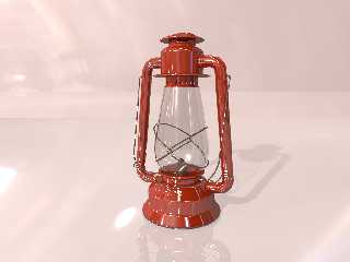

Firstly thanks a lot clipka, a very thorough answer and well explained, I read
somewhere that for HDR diffuse should be set to 1 (hence my mistake), the rest I
think I changed so many settings that I just ended up totally confused.
I did add a light_source but only as the HDR image was not looking good so I
added a low level light source, I have removed that now though.
I also tried albedo but without the correct settings etc I don't think I would
have ever got a good render.
I initially set error_bound to 0.8 but had so many artifacts it looked like an
oil painting (an interesting effect but not what I was after). I just copied the
radiosity settings from an old image that did not use HDR then started
tweaking...
I had assumed_gamma in a separate global_settings section but other than that
being correct most other things were not so good ;-)
I have re-rendered with the following changes below:
pretrace_end 0.001 (don't know if this is too far, certainly slowed down the
pretrace step).
error_bound 0.8
recursion_limit 2
brightness 1.0
removed the gamma from the sky_sphere
left emission at rgb 0.6 // will try tweaking this though.
For the finish
set specular to 0
set brilliance to 1
changed the settings to diffuse albedo 0.6 reflection { 0.2 fresnel }
Two more questions though..
1) Is variable reflection advised for most objects, I have previously only used
this for glass/water?
2) Without specular does roughness have an effect on the surface?
As you can see your advice has helped a lot, this is much better than any of my
previous attempts.
Thanks
Sean
Download 'lantern_c.png' (225 KB)
Preview of image 'lantern_c.png'

From: s day
Subject: Re: HDRI settings
Date: 8 Mar 2013 01:55:06
Message: <web.51398af8e61012b42806b85b0@news.povray.org>
"Cousin Ricky" <rickysttATyahooDOTcom> wrote:
> I was mere hours away from uploading years of work on metallic finishes to the
> Object Collection, and I need to know if I'm about to make any embarrassing
> blunders.
It can't be anymore embarrassing than mine.. I thought I knew what I was doing
with POV. I have only been using it on and off for about 25 years since I got a
copy with PC Format magazine. The magazine came with the source code to Mike
Millers jack in the box/rollercoaster scene on the disk and I (well my 386 PC)
spent several weeks tracing the scene.
Even after all this time I still have plenty to learn, I am obviously a slow
learner though ;-)
Sean
From: clipka
Date: 8 Mar 2013 02:22:25
Message: <513991b1@news.povray.org>
Am 08.03.2013 00:51, schrieb s.day:
> Also, I have tried a few different probes and all are much darker than the
> galileo one I tried first, is it acceptable to increase emissions > 1 to
> increase the light level or is there a better approach?
It's absolutely acceptable, and is in fact /the/ official proper way to
boost your light probe's brightness without modifying the file itself.
Any other approach would either be physically wrong, unnecessarily
complicated, or both.
