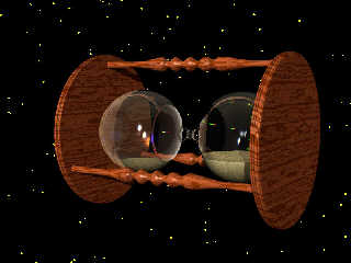

This is a series of images showing some problems I encountered when making an
hourglass.
The first one consists of a lathe object shaped into a bulb, referenced with a
negative scale component to create a hourglass shape then a scaled down version
(0.995) is differenced from it. You can see banding which looks to me as if the
glass does not have a uniform thickness.
Download 'hourglass01e1_0000.jpg' (63 KB)

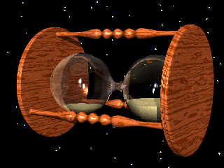

So I then created a second lathe object, making sure that it was inside the
first and that the thickness was as constant as I could make it then referenced
it to make the hourglass. Now there looks like there is flaring at the join.
Download 'hourglass03a_0000.jpg' (79 KB)
Preview of image 'hourglass03a_0000.jpg'

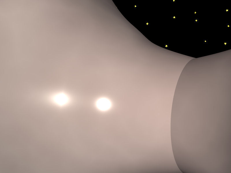

 The final two images are closeups of the join area. The first unfinished one
(12.5 hours) shows what looks like a disc around the join and the second is the
same scene with an opaque material
One image at a time, it seems
Download 'hourglass03b1_0000.jpg' (58 KB)
Preview of image 'hourglass03b1_0000.jpg'

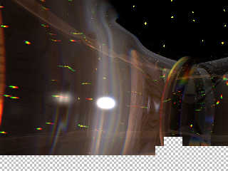

Now the opaque one
Download 'hourglass03b1a_0001.jpg' (23 KB)
Preview of image 'hourglass03b1a_0001.jpg'
