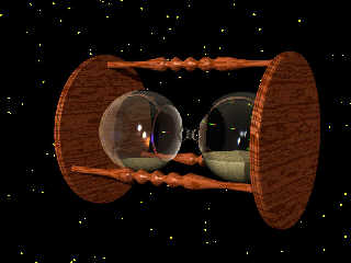

This is a series of images showing some problems I encountered when making an
hourglass.
The first one consists of a lathe object shaped into a bulb, referenced with a
negative scale component to create a hourglass shape then a scaled down version
(0.995) is differenced from it. You can see banding which looks to me as if the
glass does not have a uniform thickness.
Download 'hourglass01e1_0000.jpg' (63 KB)

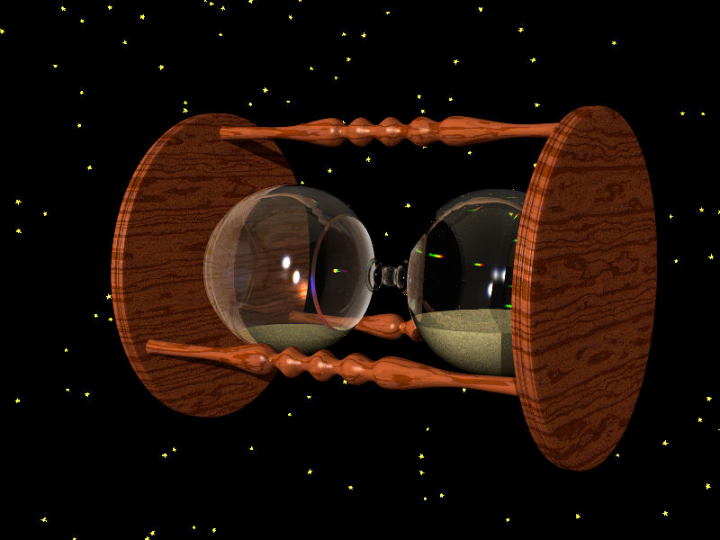

So I then created a second lathe object, making sure that it was inside the
first and that the thickness was as constant as I could make it then referenced
it to make the hourglass. Now there looks like there is flaring at the join.
Download 'hourglass03a_0000.jpg' (79 KB)
Preview of image 'hourglass03a_0000.jpg'

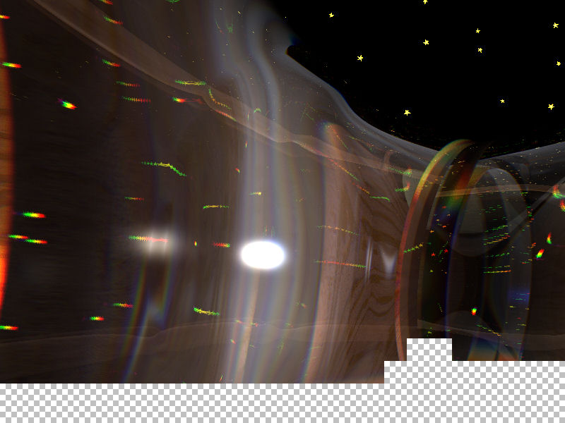

 The final two images are closeups of the join area. The first unfinished one
(12.5 hours) shows what looks like a disc around the join and the second is the
same scene with an opaque material
One image at a time, it seems
Download 'hourglass03b1_0000.jpg' (58 KB)
Preview of image 'hourglass03b1_0000.jpg'

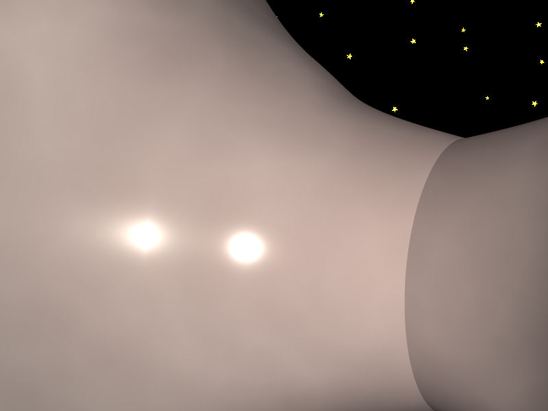

Now the opaque one
Download 'hourglass03b1a_0001.jpg' (23 KB)
Preview of image 'hourglass03b1a_0001.jpg'

From: Stephen
Subject: Re: Lathe problems.
Date: 17 Oct 2012 11:20:00
Message: <web.507ecbe7a5d212b1f2eb76540@news.povray.org>
> I am frankly at a loss for a solution, but some questions impose
> themselves maybe.
> 1) are the two ends overlapping?
> 2) the ends do not seem to be exactly parallel, (outer) edges flowing
> smoothly into one another.
> 3) could the effect be due to refraction?
> Thomas
The lathes were built with the lowest point on the ground plane then rotated 90
degrees. The other bulb is mirrored so the edges should be coincidental.
Although I can see that there is not a smooth transition between them in the
opaque image. The inner lathe extends past the outer one and the highest level
CSG is a merge so there should be no internal surfaces.
Well the IOR is quite high for glass, greater than 1.5 IIRC. I was wondering
about internal reflections as well.
From: Tek
Date: 17 Oct 2012 11:35:01
Message: <web.507ecf4da5d212b1ed8e7a0@news.povray.org>
> Now the opaque one
I suggest you render a cross-section, preferably highlighting the cutaway
surface (i.e. intersection { <hourglass> plane { -z, 0 pigment { rgb x } } } ).
But I think most of your problems come from using a spline type where you can't
control the gradient where the mirrored bulbs meet. So either don't mirror them,
and use a curve that describes both bulbs of the hourglass, or use a
bezier_spline and place the control point tangentially to the desired curve to
get a smooth transition.
Or you could download the source for my "Sands Of Time" IRTC entry:
http://exether.free.fr/irtc/index.php?sub=pg2004&lang=en&year=2004&month=8&typ=S&mrk=C
Tek
From: Stephen
Date: 17 Oct 2012 16:01:49
Message: <507f0ead$1@news.povray.org>
Yes, I think that is the way to go. It has been ages since I have used
SORs or Lathes and I am quite lazy. :-)
I was using a cubic curve but my endpoint wasn't making making the joint
take the right angle.
Strange that you say that, Norbert suggested it too.
I found it interesting that you could use so few points and get such a
good curve.
Regards
     Stephen
From: Stephen
Date: 17 Oct 2012 16:15:53
Message: <507f11f9@news.povray.org>
> themselves maybe.
I checked and they were. :-(
Even after correcting that. The gold ring was still there but much
diminished.
Too true, I used a poor end point.
Yes, I think so. When I commented out the sand. The ring was still there
but much less visible.
Ah! Well. Back to the drawing board.
Regards
     Stephen
From: Christian Froeschlin
Date: 17 Oct 2012 20:42:30
Message: <507f5076$1@news.povray.org>
You could try to reshape the curve in the center so it is not
a hard edge but rather a little rounded. If this is two pieces
joined together you'll want the end to have vertical/horizontal
tangents. BTW you can post more than one image when using a
newsreader such as Thunderbird.
