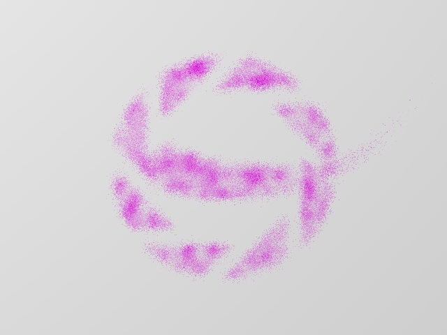

Nothing fancy, at the moment.  Just a static point emitter with trace and
eval_pigment thrown in.
I still have quite a bit to do:  The scattering is Rand_Normal from rand.inc
Mu = 0.0
Sigma = 1.0
using a spherical angle system (random phi and theta to give particle
trajectory).
Eventually, the emitter will move along a path dictated by one spline, and aim
at a path dictated by another spline -- at least, that's the plan for now.
the stencil image will be optional, so it will be fairly versatile, perhaps even
useful for animations...
comments/suggestions?
A.D.B.

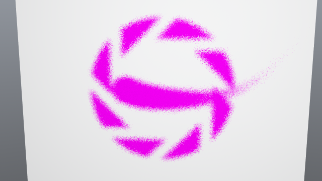

I hope you don't mind, but your post inspired me to try this in an entirely
different way: Instead of placing spray particles through a mask, I just draw
the mask as an object pigment with some turbulence to create the spray effect.
Obviously this is far less realistic, but it's very quick to trace.
Here's the code in case you want to give it a try:
pigment {
 object {
  union {
   sphere_sweep {
    cubic_spline
    5,
    <-1,1>, .1,
    <-.5,0>, .2,
    // move away from the surface to thin out the spray
    <1,0,-.1>, .1,
    <2,1,-.2>, .1,
    <2,2,-.3>, .0
   difference {
    cylinder { -z, z, 1 }
    cylinder { -z, z, .7 }
    #for ( a, 0, 360-45, 45 )
     box { -z, <.15,1,1> translate -x*.7 rotate z*a }
    #end
  rgb 1, rgb <1,0,1>
 #local noiseScale = .004;
 scale 1/noiseScale
 warp { turbulence .1/noiseScale octaves 2 lambda 4 }
 scale noiseScale
Tek

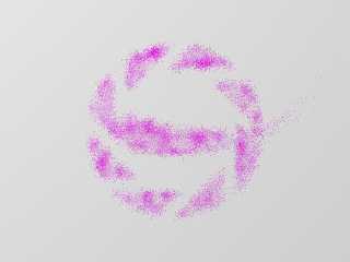

you can also use object pattern with two textures, this allows
for a more sprinkled interior without destroying the outline
#declare T1 = texture {pigment {color White}}
#declare T2 = texture
   pigment
     bozo scale 0.1
     color_map
       [0.3 White]
       [0.7 rgb <1,0,1>]
texture
   object
     texture {T1}
     texture {T2}
From: Christian Froeschlin
Subject: Re: Spraypaint macro progress
Date: 12 Oct 2012 16:40:11
Message: <5078802b@news.povray.org>
and the image ...
Download 'testspray.jpg' (49 KB)
Preview of image 'testspray.jpg'
