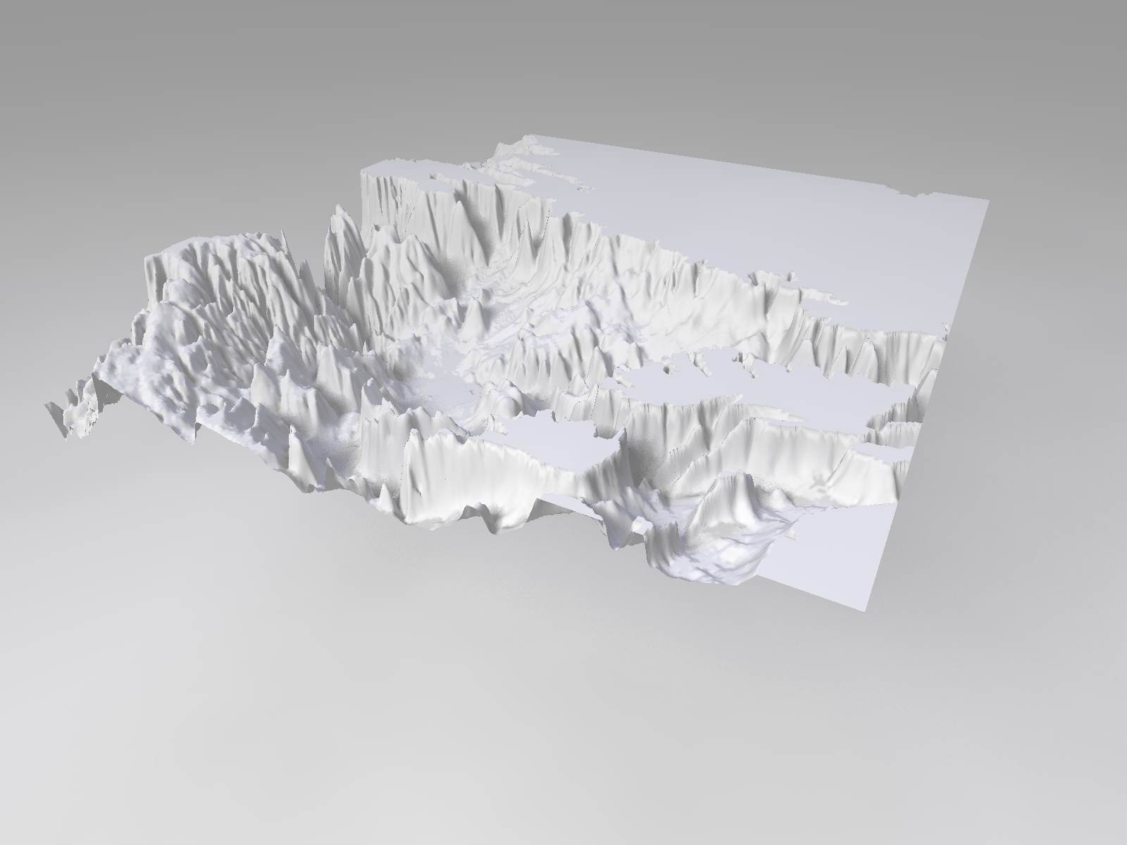

Hi,

From: mathieu r
Subject: Re: Advice on rendering a topographic scene
Date: 29 Aug 2012 04:45:00
Message: <web.503dd5ae99d682a9270882f00@news.povray.org>
The preivous image was too big. Here it is.

From: clipka
Date: 29 Aug 2012 05:53:22
Message: <503de692$1@news.povray.org>
Am 29.08.2012 10:41, schrieb mathieu_r:
Hey, that looks great!
>>> -> "completely radiosity-lit"
>>> I have put some radiosity on my scene, also some light sources. How to make it
>>> **completely** radiosity-lit
To light a scene using only radiosity, you'd replace all your light
sources with
a) objects which emit light by themselves (using the "emission" keyword
in the finish; make sure to use big objects, or drastically increase the
radiosity "count" parameter), and/or
b) a sky_sphere or bright background (giving you light from all directions)
You may need to increase the recursion depth by 1, as compared to a
normally-lit scene.
>>> -> "a bright blue"
>>> How to influence on light brightness?
Sorry, I actually meant "light blue".
But since you're asking: The easiest way to change a light source's
brightness is via its color; for instance, <0.5, 0.0, 0.0> will give you
a dim red, while <10, 0, 0> will give you a very bright red of the same
hue and saturation.
You can also multiply a given color by a constant, such as <1,0,0>*0.5
or <1,0,0>*10; IIRC this should also work with color constants, e.g. Red*10.
>>> We can influence the light brightness by making it far from the object?
That depends. By default, the illumination from a light source is
independent of its distance (which of course is unrealistic). However,
with the "fade_distance" and "fade_power" keywords you can get more
realistic behaviour.
fade_power should be set to 2 for this purpose. fade_distance is best
set to the presumed radius of the light source (half the area light's size).
Note that this will typically make your illumination a /lot/ darker;
you'll have to compensate for this by cranking up the light source's
nominal brightness as described above. For instance, if fade_power is
set to 2, fade_distance to 10, and the light is at a distance of 1000,
then you'll need to increase the brightness by a factor of (1000/10)^2
to get the same brightness as without the fade_* keywords.
>>> -> "very diffuse lighting"
>>> How to make lighting very diffuse?
Use area lights with a big size (alternatively, a radiosity-lit scene
with large emissive objects and/or a sky sphere), and set hightlights to
zero (phong 0 specular 0).
>>> -> "I guess that a bit of fog might also be needed."
>>> Does the fog paramter seem correct to you?
I personally don't think the scene needs any fog.
As another suggestion, I'd recommend some slight focal blur (see the
"aperture" camera keyword).

From: mathieu r
Date: 29 Aug 2012 09:10:01
Message: <web.503e13ae99d682a9270882f00@news.povray.org>
"Hey, that looks great!"
Thanks!
- "objects which emit light by themselves (using the "emission" keyword
in the finish; make sure to use big objects"
What kind of objects do you recommend? Large spheres, boxes? Vertical planes?
- "a sky_sphere or bright background (giving you light from all directions)"
Does radiosity setting interact with a bright background? (A bright background
reflects more)
From: clipka
Date: 29 Aug 2012 11:05:12
Message: <503e2fa8@news.povray.org>
Am 29.08.2012 15:05, schrieb mathieu_r:
Spheres probably give the best result; actually, the result will be
quite similar to that of an equally large area light with the "circular"
and "orient" keywords.
> reflects more)
The radiosity setting interacts with a background (as defined by that
keyword) in the sense that the background acts as a kind of light source
(like an object with the "emission" keyword). The background won't be
brightened up by other light from the scene though.
In that sense, POV-Ray's "background" feature can be thought of as a
simpler alternative to the "sky_sphere" feature.

> What's the difference between an object emitting light using an emission media
> and a light which Looks_Like an object?
I'm referring to objects emitting light via the new "emission" finish
parameter (in POV-Ray 3.6, "ambient" would have been mis-used for that
purpose).
If the object is comparatively simple (such as a sphere) and/or not too
close to any surface, I'd recommend an area light with a looks_like
object, as it's usually faster, does work with highlights (phong or
specular), and doesn't necessarily need radiosity to work.
To use an object with an "emission" finish term you need radiosity, and
it's difficult to get highlight effects. OTOH it often gives more
realistic results if the emitting object is close to a surface and
comparatively complex.
