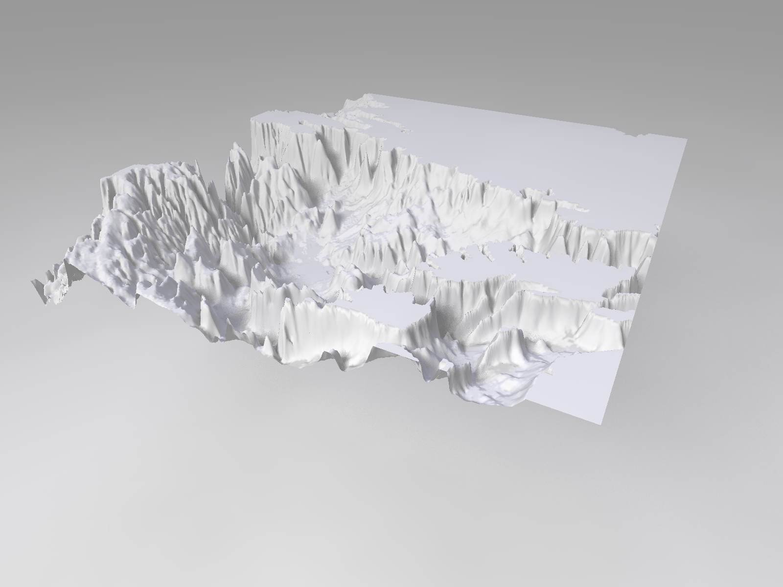

Hi,
This post is related to
http://news.povray.org/web.503cb1ead916b0083999cf850%40news.povray.org
"> Thanks a lot for your advice.
> Here is my actual image.
> Would you see any improvement to be done so as it looks like Diana Lange's
> rendering?
> -> "completely radiosity-lit"
> I have put some radiosity on my scene, also some light sources. How to make it
> **completely** radiosity-lit
> -> "a bright blue"
> How to influence on light brightness?
> We can influence the light brightness by making it far from the object?
> -> "very diffuse lighting"
> How to make lighting very diffuse?
> -> "I guess that a bit of fog might also be needed."
> Does the fog paramter seem correct to you?
> Thanks,
> Mat

The preivous image was too big. Here it is.

From: clipka
Subject: Re: Advice on rendering a topographic scene
Date: 29 Aug 2012 05:53:22
Message: <503de692$1@news.povray.org>
Am 29.08.2012 10:41, schrieb mathieu_r:
Hey, that looks great!
To light a scene using only radiosity, you'd replace all your light
sources with
a) objects which emit light by themselves (using the "emission" keyword
in the finish; make sure to use big objects, or drastically increase the
radiosity "count" parameter), and/or
b) a sky_sphere or bright background (giving you light from all directions)
You may need to increase the recursion depth by 1, as compared to a
normally-lit scene.
>>> -> "a bright blue"
Sorry, I actually meant "light blue".
But since you're asking: The easiest way to change a light source's
brightness is via its color; for instance, <0.5, 0.0, 0.0> will give you
a dim red, while <10, 0, 0> will give you a very bright red of the same
hue and saturation.
You can also multiply a given color by a constant, such as <1,0,0>*0.5
or <1,0,0>*10; IIRC this should also work with color constants, e.g. Red*10.
That depends. By default, the illumination from a light source is
independent of its distance (which of course is unrealistic). However,
with the "fade_distance" and "fade_power" keywords you can get more
realistic behaviour.
fade_power should be set to 2 for this purpose. fade_distance is best
set to the presumed radius of the light source (half the area light's size).
Note that this will typically make your illumination a /lot/ darker;
you'll have to compensate for this by cranking up the light source's
nominal brightness as described above. For instance, if fade_power is
set to 2, fade_distance to 10, and the light is at a distance of 1000,
then you'll need to increase the brightness by a factor of (1000/10)^2
to get the same brightness as without the fade_* keywords.
Use area lights with a big size (alternatively, a radiosity-lit scene
with large emissive objects and/or a sky sphere), and set hightlights to
zero (phong 0 specular 0).
I personally don't think the scene needs any fog.
As another suggestion, I'd recommend some slight focal blur (see the
"aperture" camera keyword).
Date: 29 Aug 2012 07:03:24
Message: <503df6fc$1@news.povray.org>
I agree. Very similar to the original.
It is a matter of taste. In the original image the back of the
height_field looked a bit foggy. However...
...this might also do the trick ;-)
From: mathieu r
Date: 29 Aug 2012 09:10:01
Message: <web.503e13ae99d682a9270882f00@news.povray.org>
"Hey, that looks great!"
Thanks!
- "objects which emit light by themselves (using the "emission" keyword
in the finish; make sure to use big objects"
What kind of objects do you recommend? Large spheres, boxes? Vertical planes?
- "a sky_sphere or bright background (giving you light from all directions)"
Does radiosity setting interact with a bright background? (A bright background
reflects more)
From: clipka
Date: 29 Aug 2012 11:05:12
Message: <503e2fa8@news.povray.org>
Am 29.08.2012 15:05, schrieb mathieu_r:
Spheres probably give the best result; actually, the result will be
quite similar to that of an equally large area light with the "circular"
and "orient" keywords.
> reflects more)
The radiosity setting interacts with a background (as defined by that
keyword) in the sense that the background acts as a kind of light source
(like an object with the "emission" keyword). The background won't be
brightened up by other light from the scene though.
In that sense, POV-Ray's "background" feature can be thought of as a
simpler alternative to the "sky_sphere" feature.
From: mathieu r
Date: 30 Aug 2012 07:30:00
Message: <web.503f4e4499d682a92ebecedb0@news.povray.org>
-> "Spheres probably give the best result; actually, the result will be quite
similar to that of an equally large area light with the "circular" and "orient"
keywords."
I imagine that if I put a sphere object just above my landscape, I'll have to
make it disappear with hollow keyword?
Mat

From: clipka
Date: 30 Aug 2012 09:46:35
Message: <503f6ebb$1@news.povray.org>
Am 30.08.2012 13:28, schrieb mathieu_r:
> keywords."
You only need hollow for objects containing media.
If you want to make an object emit light but otherwise be invisible in
the image, use "no_image no_shadow no_reflection", meaning that it will
not be directly visible in the image, nor will it have a shadow, nor
will it be visible in mirrors or the like.
From: mathieu r
Date: 31 Aug 2012 03:05:08
Message: <web.5040611699d682a9a7fd5a260@news.povray.org>
What's the difference between an object emitting light using an emission media
and a light which Looks_Like an object?
Is one more flexible than the other?

From: clipka
Date: 31 Aug 2012 06:19:20
Message: <50408fa8@news.povray.org>
