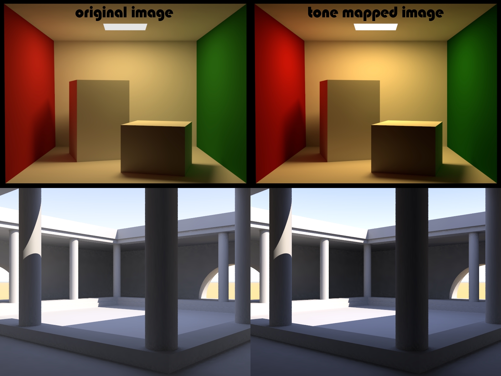

Something is bugging me. Namely the question why there's spent so much time in
improving radiosity, sslt, photons etc. while an essential thing is still
missing in my eyes. You can use the best radiosity and area light settings and
end up with a render that is still looking somewhat artificial.
Correct me if I am wrong, but isn't it a fact that povray has always suffered
from a linear lighting model?
My eyes are longing for a little bit of non-linearity :)
And I don't think it would be that hard to implement into the main program. As
far as I know Megapov has such a feature, called 'tone mapping'.
I found out a way to simulate this in the official version, it's a bit dirty but
it works for me.
The trick is to reflect the whole scene in two small spheres centered at the
camera location and make use of the 'exponent' keyword to control the light
intensities. (I call it a dirty solution because I don't think that it would
work well with focal blur, although I haven't tried it yet)
I don't know if this is pysically correct in any way, but the resulting renders
look more authentic and believable to me than general pov renders.
And as a positive side-effect, the images look more colorful and less
'washed-out' as you can convince yourselves by looking at the attached images.
Here's my... dirty... code :)
sphere {
    CAMERA_LOCATION, 0.01 // small radius
    pigment {color rgb 0}
    finish {
        reflection {
            1.35 // overall image brightness
            exponent 0.87 // non-linearity        }
    no_reflection
    no_shadow
sphere {
    CAMERA_LOCATION, 0.001 // smaller radius
    finish {
        reflection {1}
    no_image
    no_shadow
Regards, Florian
Download 'tone_mapping.jpg' (585 KB)
Preview of image 'tone_mapping.jpg'

To have physicaly correct, you need to use linear colour space. You can
always alter the end image if you want.
Some use an assumed_gamma of 2.2 or srgb.
You can also set the file gamma to some arbitrary value, like 2 or 3 if
you want.
Your cornel cox tone altered image have to much saturation compared to
the original cornel box. In fact, the original render is also slightly
oversaturated...
In your second image, the only notable difference is in the sandy ground
in the background and a slight yellowish cast in the lower part of the
sky. If you tint the fog slightly yellow, you'll get roughly the same
effect.

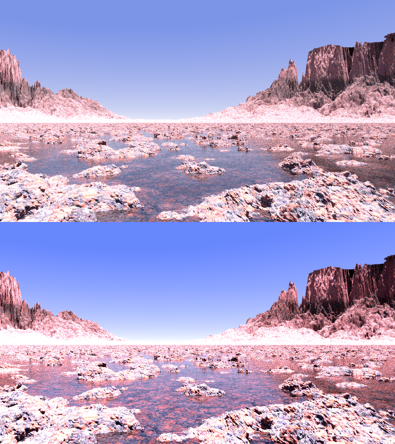

Interesting. When I used MegaPOV I standard used the tone mapping
utility. Your little trick works well and allows to play with the
overall tone of the rendered scene. Makes colours deeper. Curious to
read what the experts have to say about this ;-)
As I was playing around with some LOTW landscapes, I tried it out
immediately. Upper image is not tone mapped, lower image with exponent
0.7. Rendered in version 3.7 RC5; LOTW scene file and includes adapted
to 3.7 use.
Download 'lotw 34_18_var_tonemapping.png' (1221 KB)
Preview of image 'lotw 34_18_var_tonemapping.png'

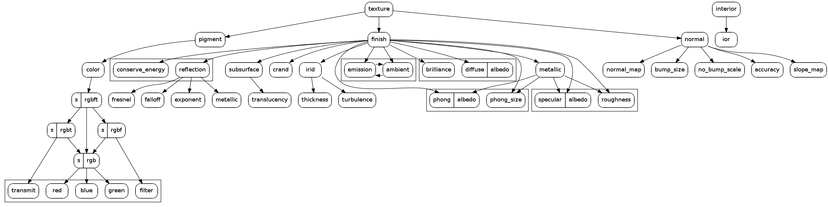

I think povray has always suffered from a lack of clear explanation &
tutorial on finish settings.
pigment/color are pretty easy to understand: a red, a green, a blue
component. And a touch of mixing with transmit & filter. Simple, easy,
and enough.
On the other side, the finish is not exposed with a global vision.
Download 'apparence.png' (128 KB)
Preview of image 'apparence.png'

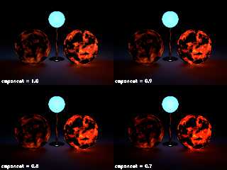

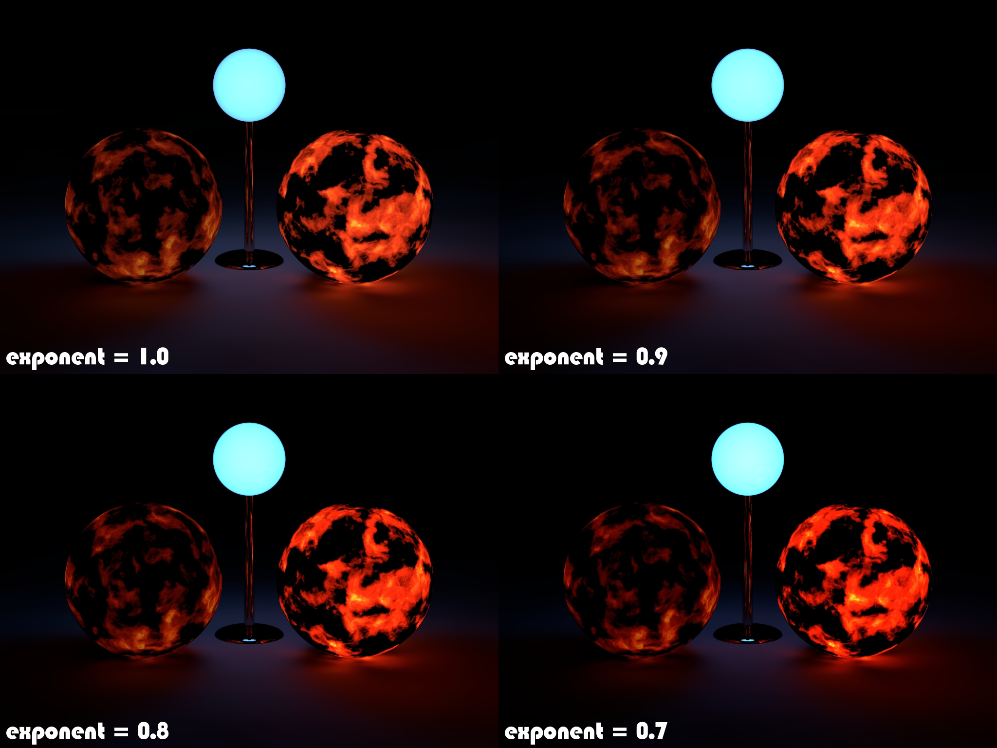

Here's another example scene where tone mapping, although using it the way I do
may be 'incorrect', for me makes sense and somehow looks better than without.
(exponent = 1 ... no tone mapping)
Just imagine a very dark room with a fire place, glowing coals, a lava lamp, a
candle or something similar. While looking directly into one of these 'light
sources', your eyes adapt to the lighting conditions and everything else around
gets darker. Isn't it? - I am not a genius, but at least I try to be one ;-)
Regards, Florian
