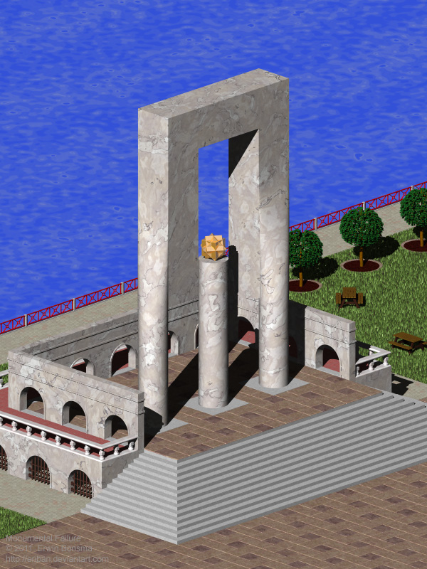

Hi all,
Attached is my latest render of an impossible object. Out of the impossible
scenes I have rendered sofar, this one was the least challenging. There was
hardly any need for fancy tricks. Nevertheless, hopefully the resulting image is
still interesting. The grass is made using a texture created by Rune Johansen
(http://runevision.com). Comments and feedback are welcome, as always.
Cheers,
Erwin
Download 'failure-1_00.jpg' (251 KB)
Preview of image 'failure-1_00.jpg'
From: Christian Froeschlin
Subject: Re: Monumental Failure (optical illusion)
Date: 20 Aug 2011 17:30:08
Message: <4e502760$1@news.povray.org>
Very nice, doesn't look like a failure at all ;)
The shadow on the inner right side of the monument doesn't
seem to match either light orientation. Is that an artefact
of the few fancy tricks you did use?

Very nice indeed.
There is something about the shadows that need more work though, to make
this even more convincing, in particular the left hand column.
Thanks.
It is an intentional artifact, intended to look at least at first glance fairly
okay. The problem is that the shadows cannot be entirely consistent because of
the two interpretations of the plane on which the shadow is cast (being nearby
at the top, and far at the bottom). The correct angle of the shadow would be to
match that of the shadow above it, but that would look wrong as well.
Alternatively, I could let the shadow of the front column extend all the way to
the top, but that would look strange as well. The front square pillar should not
be casting a shadow on the back one, given the direction of the light.

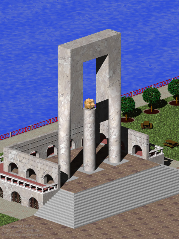

Hmm, I could change the alignment of _both_ shadows of the top bar such that
they align. Although still not correct, it may look somewhat better. See the
attached image. Does this look better?
Cheers,
Erwin
Download 'failure-variant1.jpg' (309 KB)
Preview of image 'failure-variant1.jpg'

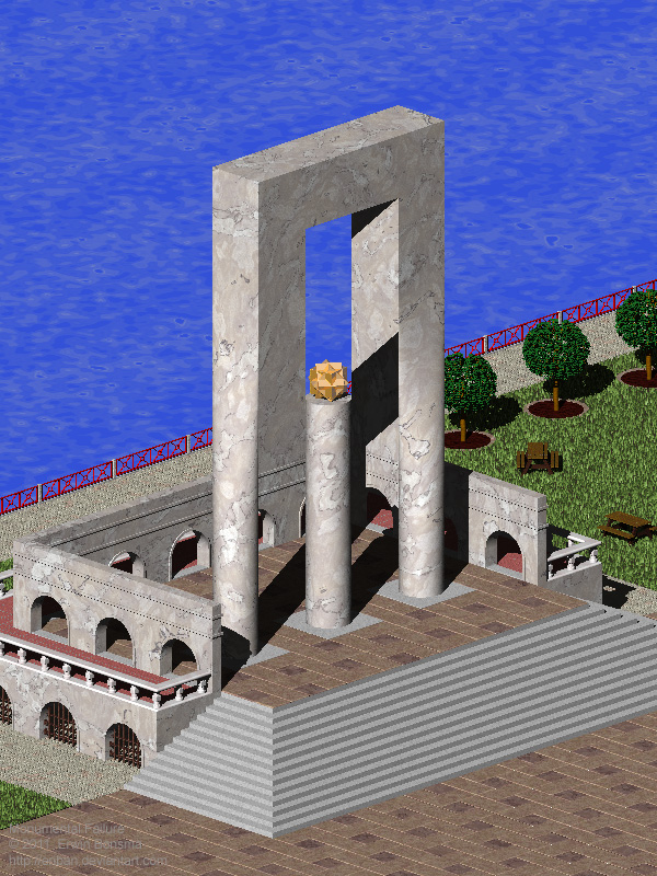

Okay, assuming you did not mean the shadow cast by the column, but the shading
of the column itself, I spent some time trying to improve this. Attached is an
updated image. I also changed the shading of the right hand column, while I was
at it. Although the difference is fairly subtle, I think it's an improvement.
Hopefully you agree. Anyway, thanks for the suggestion.
Cheers,
Erwin
Download 'failure-variant2.jpg' (309 KB)
Preview of image 'failure-variant2.jpg'

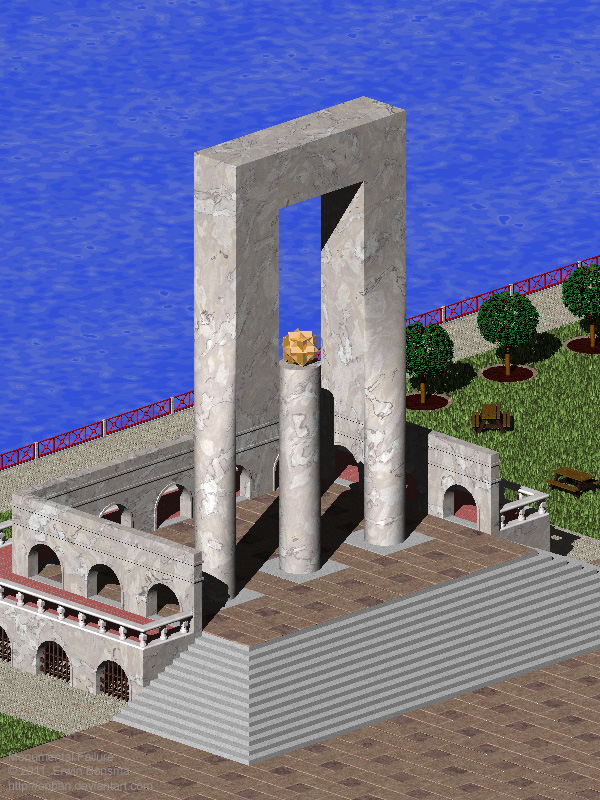

I think it doesn't make a lot of difference. What I would expect
to see is just a thin shadow as it would have been cast by the leftmost
column were the object not impossible (I think this is also what Thomas
meant). Gimped version attached for clarity.
Download 'failure-1_00.jpg' (224 KB)

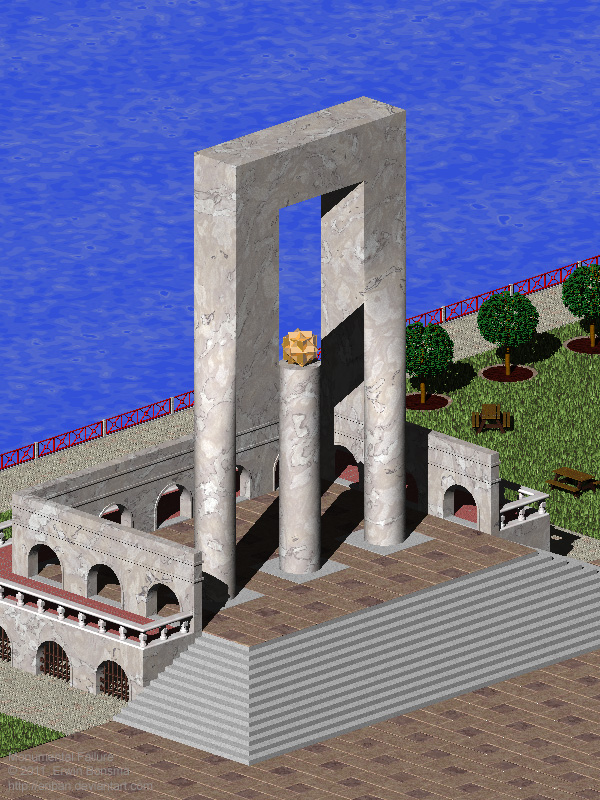

Ah, I understand now. That gimped version finally caused the coin to drop.
Thanks. And yes, in retrospect, that's probably what Thomas meant as well. I had
been trying to fake a shadow of the horizontal top bar, as to me that seemed to
be the most correct, but apparently it did not work very well. It was only
confusing. So I assume the attached image is more to your liking?
Cheers,
Erwin
Download 'failure-variant3.jpg' (309 KB)
Preview of image 'failure-variant3.jpg'
Yes ;)
BTW the shadows are very hard and dark. If the tricks still
work with area light and radiosity you could try these too.
Date: 22 Aug 2011 02:54:02
Message: <4e51fd0a@news.povray.org>
Yes, sir! You got it right this time :-)
Shouldn't the shadow of the construction touch also the grass, maybe the
trees? It is tall enough for that it seems.
