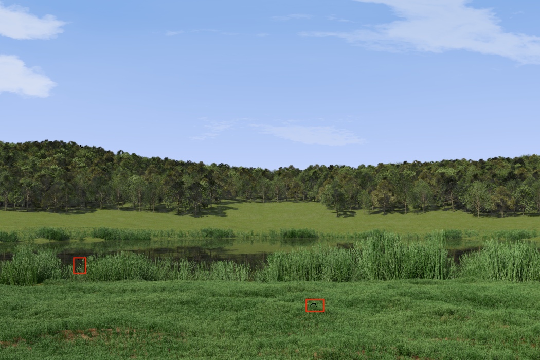

Not sure what might be causing the spots on the image below, any ideas would be
appreciated. This is actually the best of a bad bunch of renders some of which
had lots more black spots. Render took 14 hours so trying to fix the issue is
time consuming. Might try a 3.6 render to see if it is 3.7 related..
Rendered with 3.7.
image uses focal blur and radiosity.
Focal blur settings:
#declare useFocalBlur           = 4; //(0-99)
camera {
  location  <0, -32, -55>
  direction 1.5*z
  right     x*image_width/image_height
  look_at   <0, -25,  40.0>
  #if(useFocalBlur)
        aperture 0.005
        blur_samples useFocalBlur*2
        focal_point <-22, -23, 20>
        confidence 0.9+(0.001*useFocalBlur)
        variance 1/(800*useFocalBlur)
  #end
Images uses following radiosity settings, I am loading pre-calculated radiosity
using +RF"filename" and +RFI:
#declare useRad                 = 1;
#declare radQuality             = 10;
#declare PRETRACE_END=2/image_width;
global_settings {
 assumed_gamma 1
 max_trace_level 25
#if(useRad)
 ambient_light 0
 radiosity {
  #if (useRad=2)
    pretrace_start 1
  pretrace_end PRETRACE_END
  error_bound 0.5
                brightness 0.7
  count 5*radQuality
                nearest_count 15
                low_error_factor .8
                gray_threshold 0
                recursion_limit 2
                adc_bailout 0.01/2
                media on
                normal on
  #end
  #if(useRad=1)
    // load settings
    pretrace_start 1 pretrace_end 1
    error_bound 0.5
    brightness 0.7
    recursion_limit 2
    media on
    normal on
    always_sample off
  #end
#end
Download 'blackspots.jpg' (276 KB)
Preview of image 'blackspots.jpg'
I've found another black spot in the trees...
Do you use transparency? If so, try increasing max_trace_level around 100.
Do your tests without focal blur. Faster and will show if it's related
to foral blur.
Also, do a test without radiosity to verify if it's radiosity related or
not.
> to foral blur.
> not.
> Alain
Hi Alain,
OK, the no focal-blur and no radiosity images did not have black spots so it
seems like a combination of the two.
I do have transparency and reflection in the scene but am not sure about the
max_trace_level as I thought there is normally a warning output during tracing
if max_trace_level has been reached and I did not see any warnings.
However, I have increased the max_trace_level to 100 and have re-calculated
radiosity data with some improved settings, the no AA trace looked like it was
black in several areas but due to lack of AA it is difficult to tell for sure. I
am re-running a trace with loaded data and AA 0.01 to see if I get any black
spots.
I am starting to suspect this may be a memory problem (not limit but physical)
as my PC seems to be periodically hanging during traces. I think some more tests
are in order..
Sean

Thanks, I cannot take too much credit for this so far as it is mostly generated
by arbaro and placed randomly with macros. I am hoping to fill the sky with hot
air balloons but the trace time is really slow so any changes are taking a long
time to implement.
I would not mind if the black spots were like the ones on the previous image but
they appear to be random and often much worse (not what you want to see after
running a render for several days.
Sean
> time to implement.
> Sean
During the placement and test phase, replace your grass by a simple
texture and don't use radiosity. replace the trees by place holders. It
will be MUCH faster...
